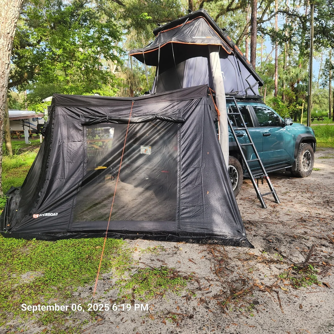

Hillsborough River State park and Fort Desoto back to back weekends then my CBI Covert bumper and Openroad 13,500 winch.
Here's a mods list so far if anyone's interested...

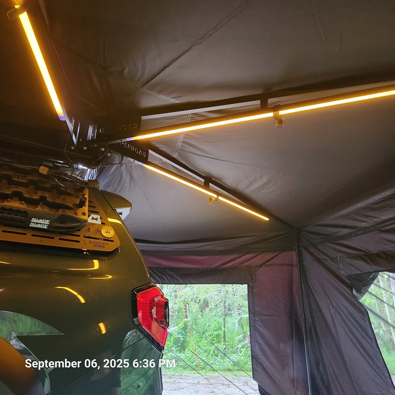

- Westcott Designs low profile roof rack with molle panels.
- 40" Black Series RC light bar and ditch lights
- Openroad 270 Awning with sides
-Openroad Aluminum Shell Peak LT RTT
- Custom storage and OVS slide out camp kitchen.
- Iceco 55L dual zone fridge
- CaliRaised interior molle panels
- CBI Covert Bumper [Install Instructions PDF]
- Openroad 13,500lb winch
- ARB Nach switch pad
- Ecoflow Wave 3
- Ecoflow Delta 2 Max
- Openroad 5 gallon shower tank and awning (not yet installed)

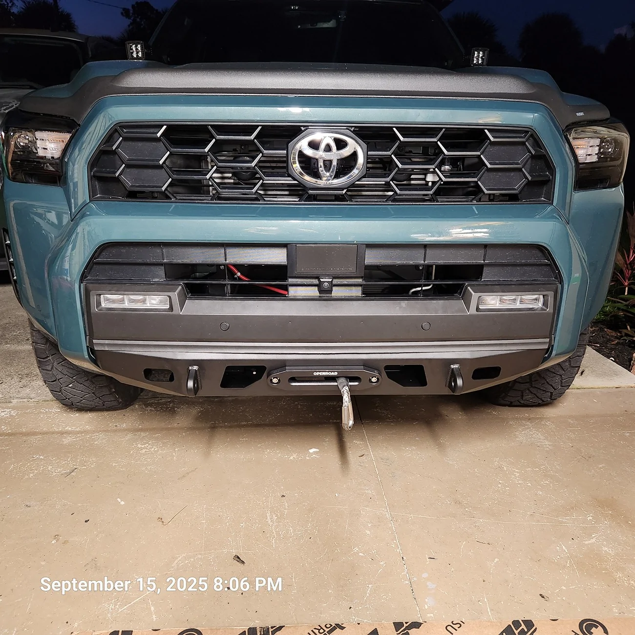

Openroad Panther 3S? I have the same one and am planning to install it with the CBI bumper as well, good to see they're compatible! How much cutting was required for the install? Can you share the install instructions, maybe in a PDF? I'm waiting for black friday to save some $$ on the bumper haha.

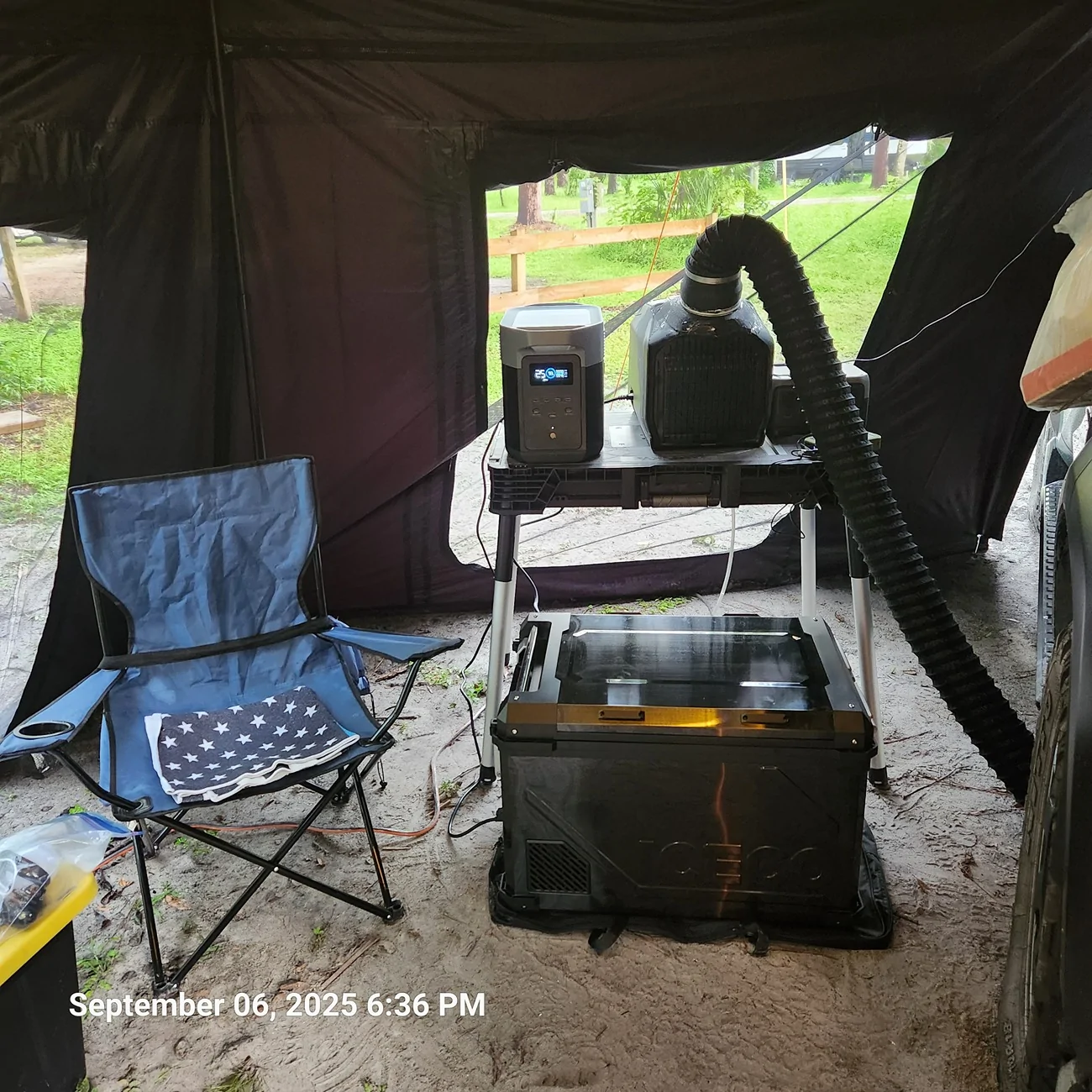

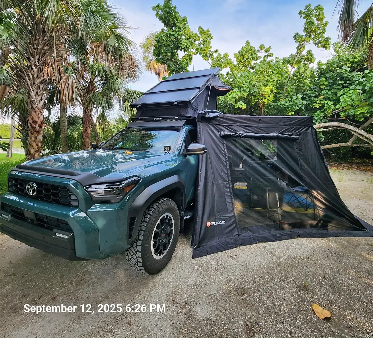

Is that a eco flow wave 2 you have there? And did you make that tube system?
Its actually the Wave 3 and Delta 2 Max. I ordered 25ft of semi insulated 4in duct from Amazon and used a rubber plumbing flange that fit the duct and the adapter perfectly then added a few velcro insulated sleeves also from Amazon. Kept me nice and cool all night.

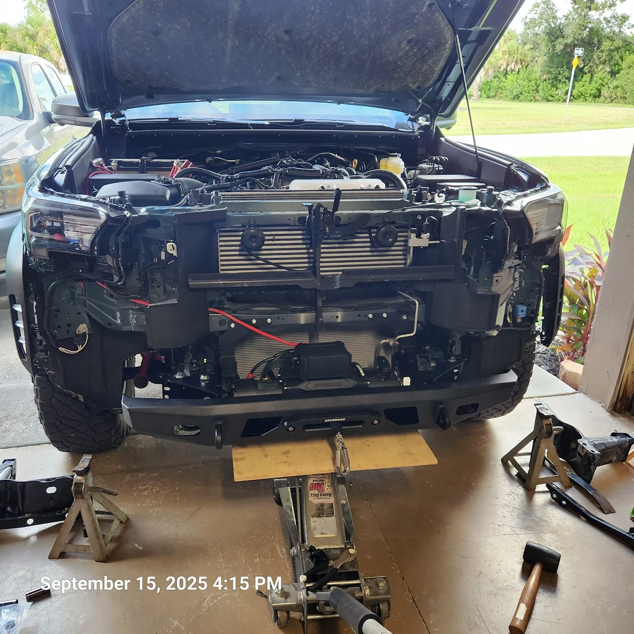

I'm a tech idiot so I will try and post the PDF that CBI sent me unless you want to give me your email and I'll just send it directly. There was a decent amount of trimming of the lower grill section but pretty straight forward. Let's put it this way, the winch and CBI bumper install took about 35 minutes. The removal, cutting, and replacing the factory bumper took about 2hrs lol
Sounds like a fun Saturday project for me. Feel free to DM me the PDF, attachments are allowed there! Just wanna get a head start on planning.

I'm interested in the CBI bumper too can you attach the installation PDF? You can just reply and hit "Attach files" at the bottom of the post editor. Thanks!

How much did your front suspension drop with the additional weight of the bumper and winch? I’ve had the same bumper sitting in my garage for 3 months now waiting for Eibach to release their TRD Pro springs

If you don’t know, could you measure from the center of the hub to the bottom of the fender? That will give me a good idea of the droop since I know the factory height.

Here's the PDF instructions that CBI sent me. Hope this helps!
CBI Covert Front Bumper Install Instructions [PDF]

I love my CBI supper stock bumper. It looks really good and not a bad price.

My stealth bumper is en route. Do you have the video mentioned in the PDF?
