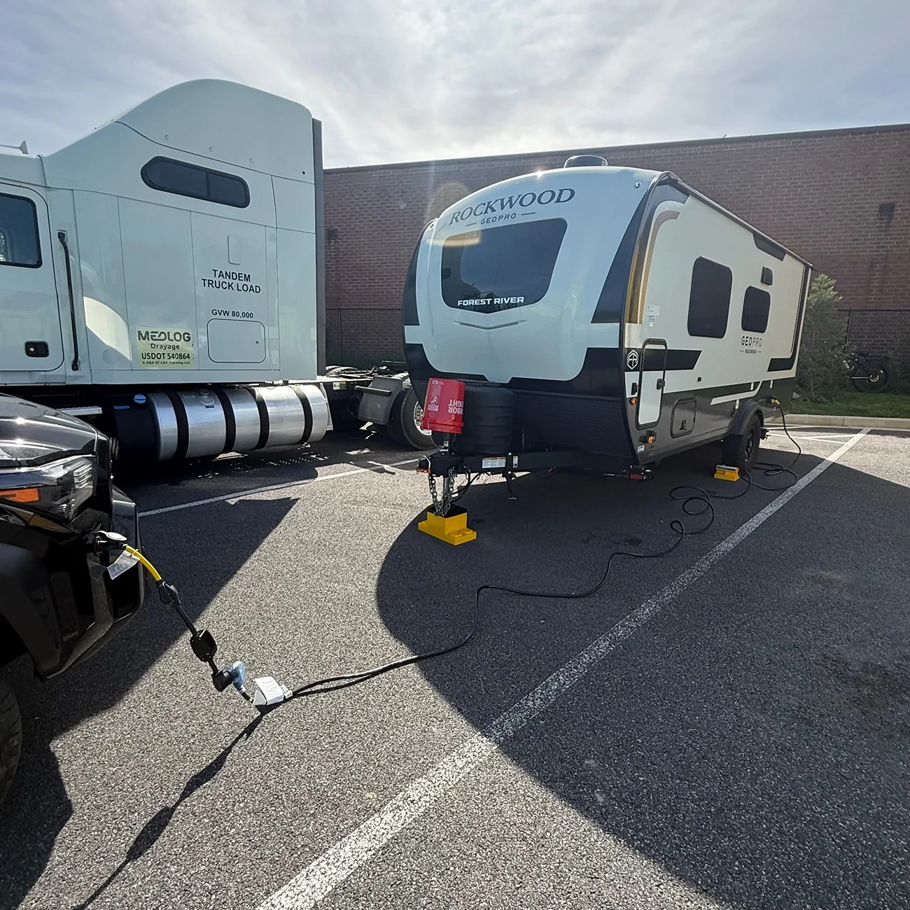

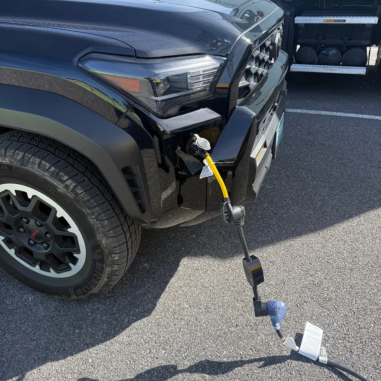

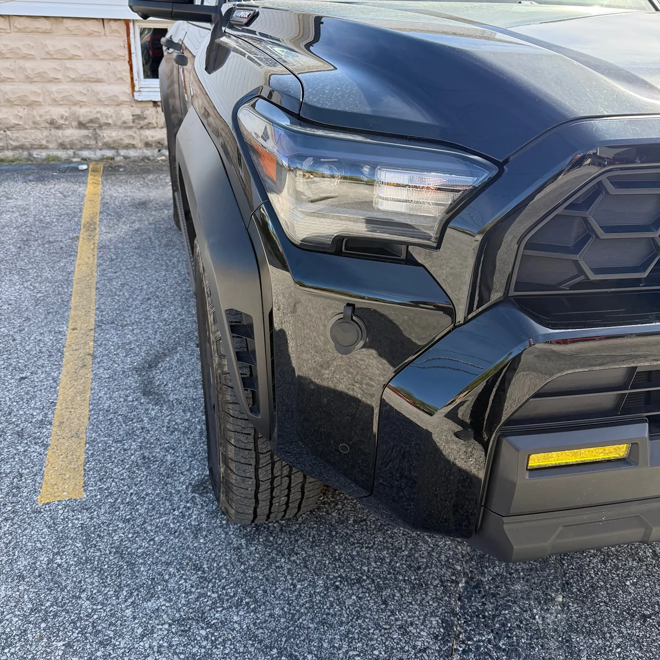

I will post this here: I had a weatherproof 20-amp outlet installed on the front fender of my 4Runner, extending the factory 2,400-watt inverter from the rear cargo area using heavy-duty wiring routed under the vehicle. This allows me to power my RV directly from the 4Runner’s hybrid system.
It works, but I have questions that need to be addressed before I can use it like this. One question:
does the factory 120V/2400W inverter have a bonded neutral or floating neutral?
