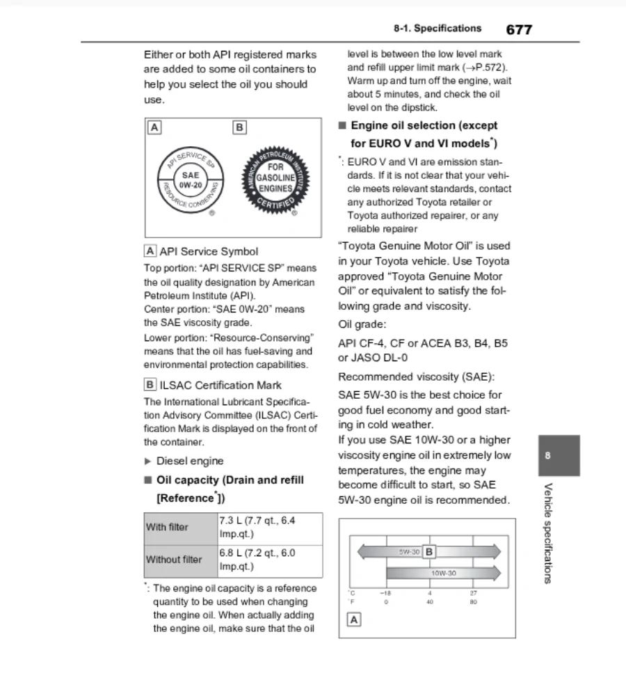

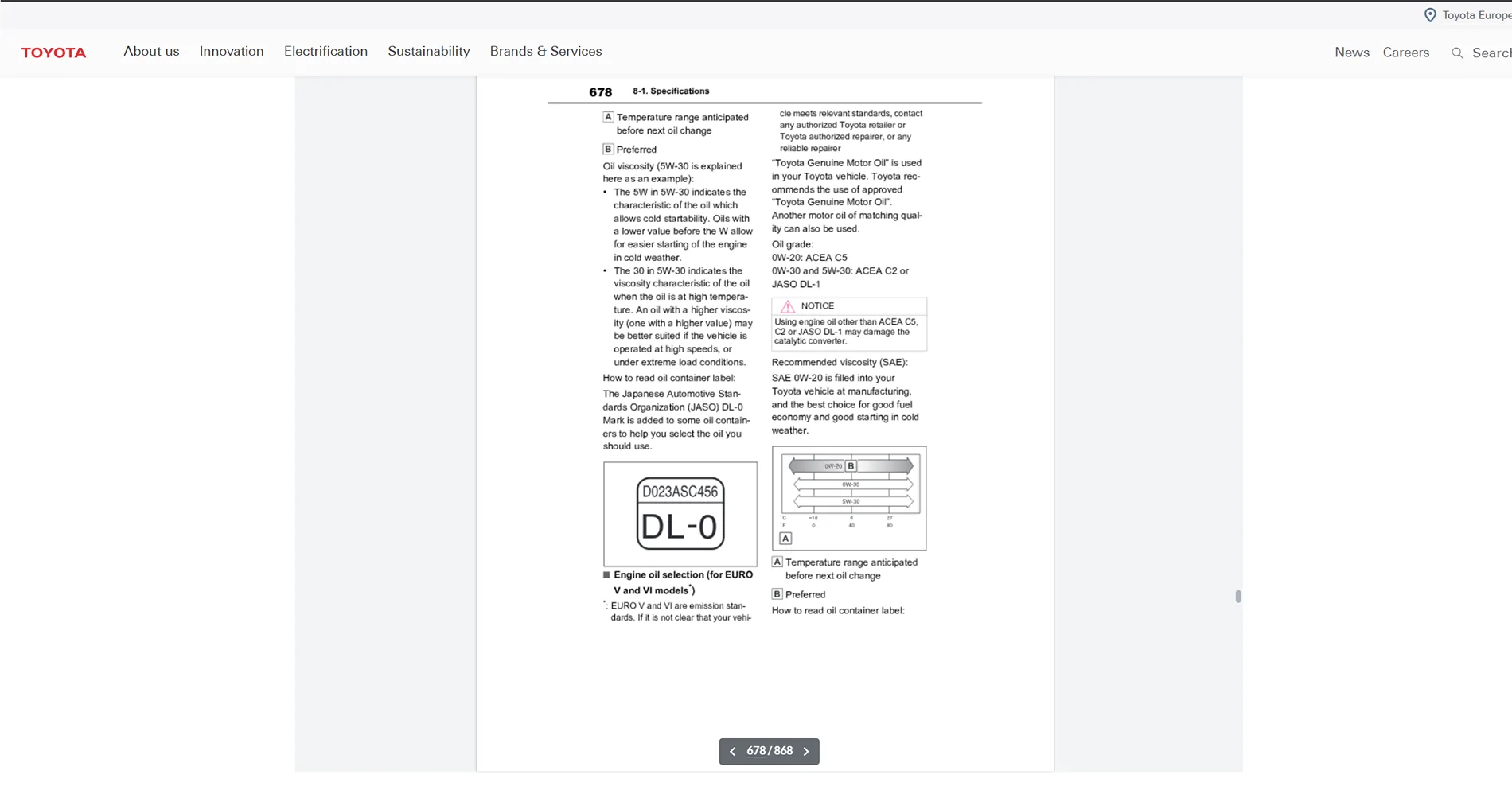

in the usa toyota uses 0w-20 (and i suspect this is mostly driven by mpg/emission requirements) vs the world where they use 5w-30.
i pulled a page from the england toyota lander cruiser 250 owers manual

it looks like this manual is for a different engine. The oil fill is 7.7 quarts! The Toyota 2.4 Turbo 4 in the 4Runner and North American 250 Land Cruiser takes 5.9 quarts of oil. Different engine, different oil specifications...
sorry that was the diesel engine specs page
otherwise its 0w-20 or 5w-30, same as usa specs and conditions when you use 5w-30 instead of 0w-20

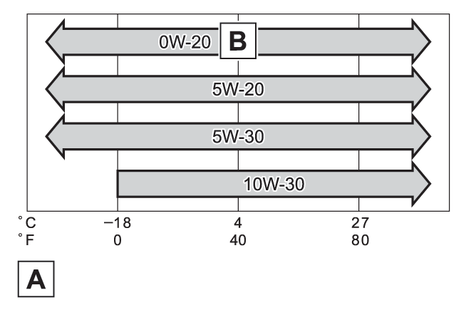

The T24A-FTS 2.4T engine which is also used in international markets does call for different oil viscosities. If you take a look at the UK owners manual for a 2024 Toyota Highlander with the same engine as the US market Tacoma and 4Runner you will see a different viscosity recommendation based on operating temps.
North American oil viscosities are what they are currently as a result of CAFE standards and fines levied on OEM's if they do not hit a specific target. I run 5w30, then engine is noticeably smoother than with 0w20.

  1. Temperature range anticipated before next oil change
  2. Preferred
SAE 0W-20 is filled into your Toyota vehicle at manufacturing, and the best choice for good fuel economy and good starting in cold weather.
If you use SAE 10W-30 or a higher viscosity engine oil in extremely low temperatures, the engine may become difficult to start, so SAE 0W-20, 5W-20 or 5W-30 engine oil is recommended.
