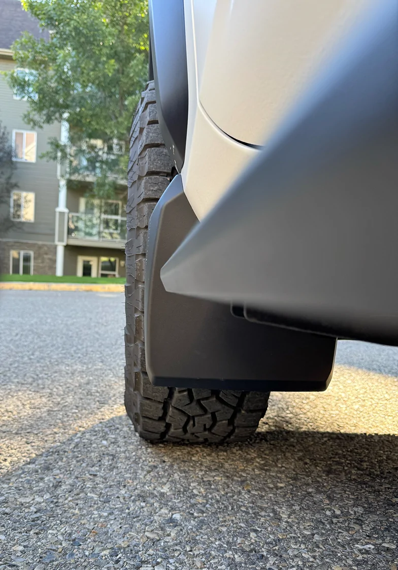

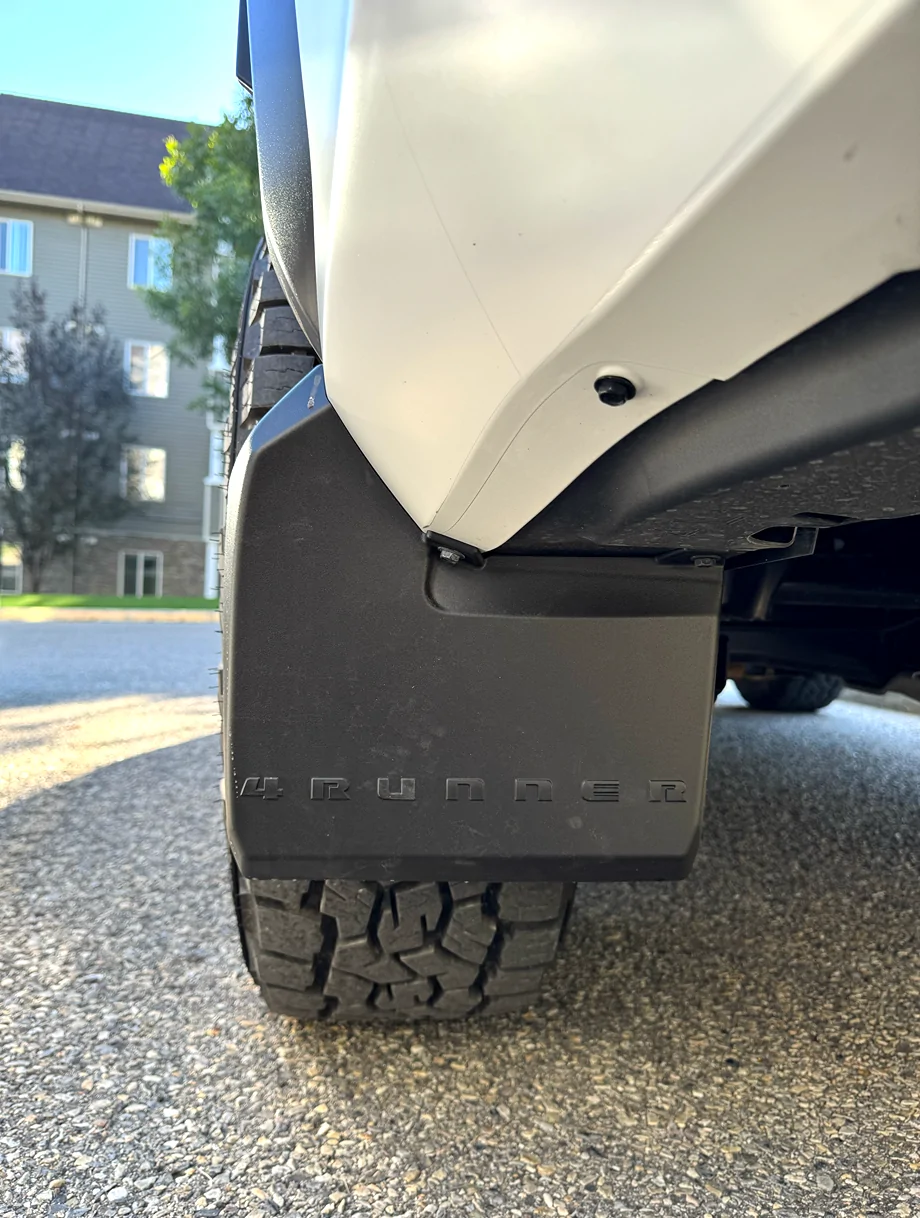

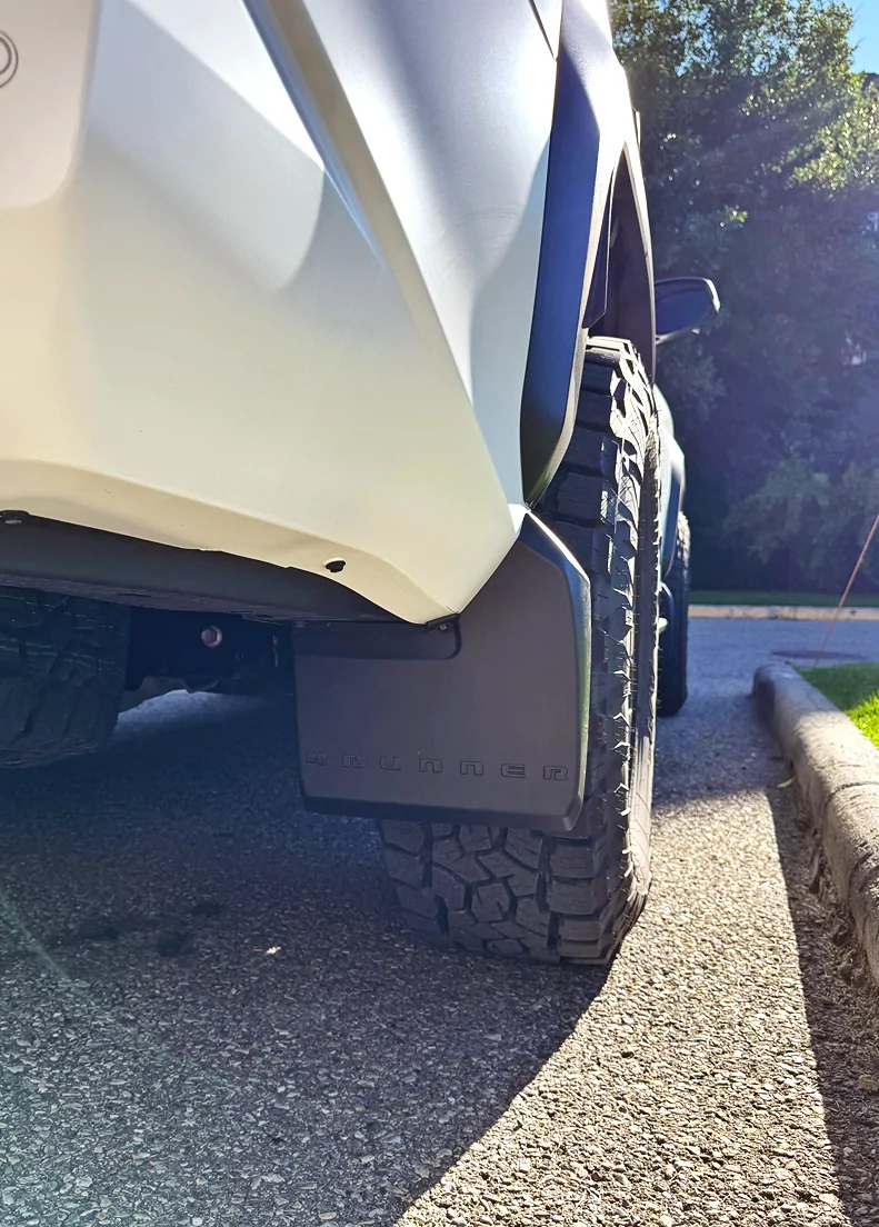

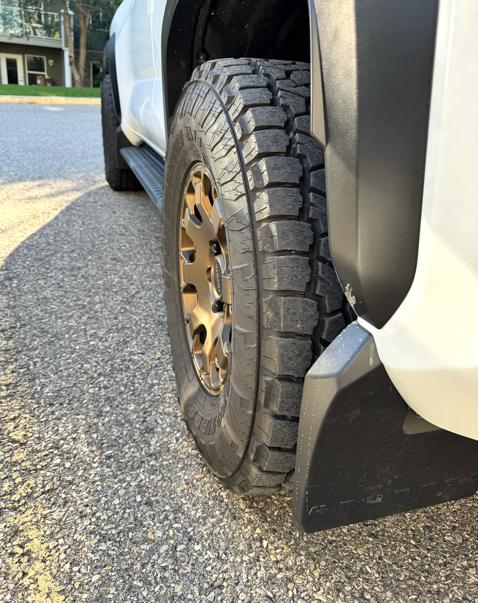

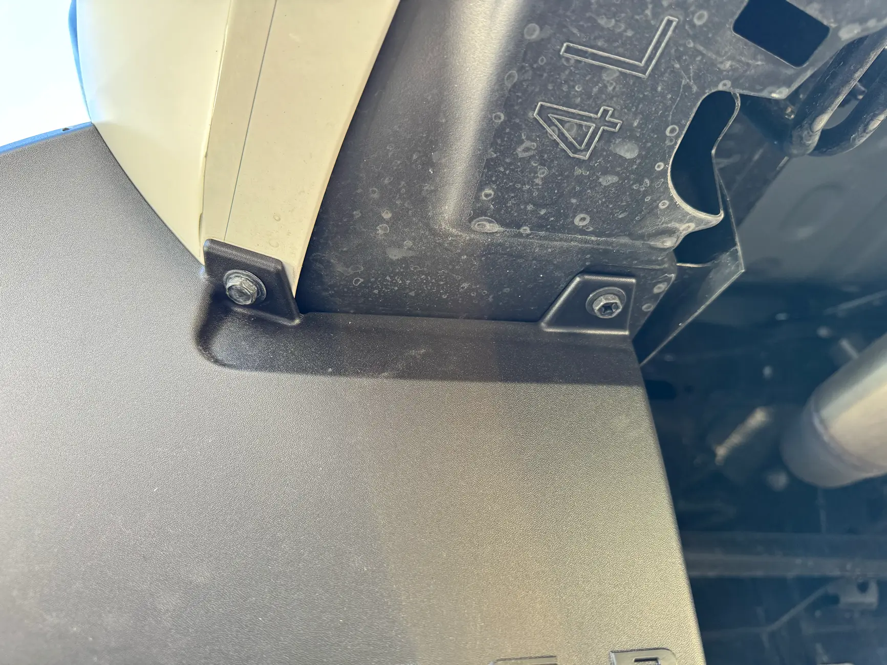

Trailhunter / TRD Pro mudflap upgrade today (Save The Paint)
Also wanna maintain some OEM parts where I can !? and these worked out well.
Part numbers for the Trailhunter / TRD Pro mudflaps:
PK389-35S10-F1
The install is 2 Phillips Crews & 1 Push plug and a Screw in the rear
PK389-35S10-R1
The install is 2 Phillips Screws & 2 10mm Bolts on the rear
Tires size and wheel 285/70R17 with 17x8 +25
Here are some images of the coverage:
2025 2026 4runner 6th gen Trailhunter / TRD Pro mudflaps upgrade installed on TRD Off-Road ORP (part numbers & photos) Trailhunter TRD Pro mudflaps installed on 2025 4runner 6th gen5
2025 2026 4runner 6th gen Trailhunter / TRD Pro mudflaps upgrade installed on TRD Off-Road ORP (part numbers & photos) Trailhunter TRD Pro mudflaps installed on 2025 4runner 6th gen1
2025 2026 4runner 6th gen Trailhunter / TRD Pro mudflaps upgrade installed on TRD Off-Road ORP (part numbers & photos) Trailhunter TRD Pro mudflaps installed on 2025 4runner 6th gen4
2025 2026 4runner 6th gen Trailhunter / TRD Pro mudflaps upgrade installed on TRD Off-Road ORP (part numbers & photos) Trailhunter TRD Pro mudflaps installed on 2025 4runner 6th gen3
2025 2026 4runner 6th gen Trailhunter / TRD Pro mudflaps upgrade installed on TRD Off-Road ORP (part numbers & photos) Trailhunter TRD Pro mudflaps installed on 2025 4runner 6th gen2

I think you will break it into pieces as soon as you go off-road
I've dragged my TH mudflaps over pretty big rocks plenty of times and although it sounds terrible from inside the vehicle and has scuffed the edges of them they're still fine.
