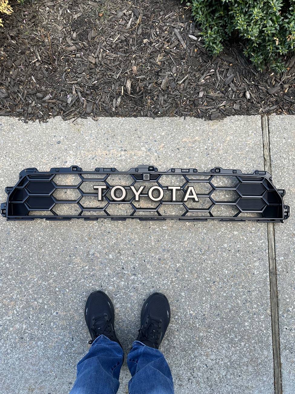

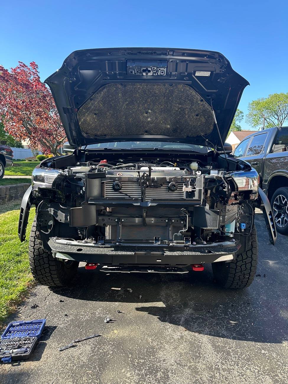

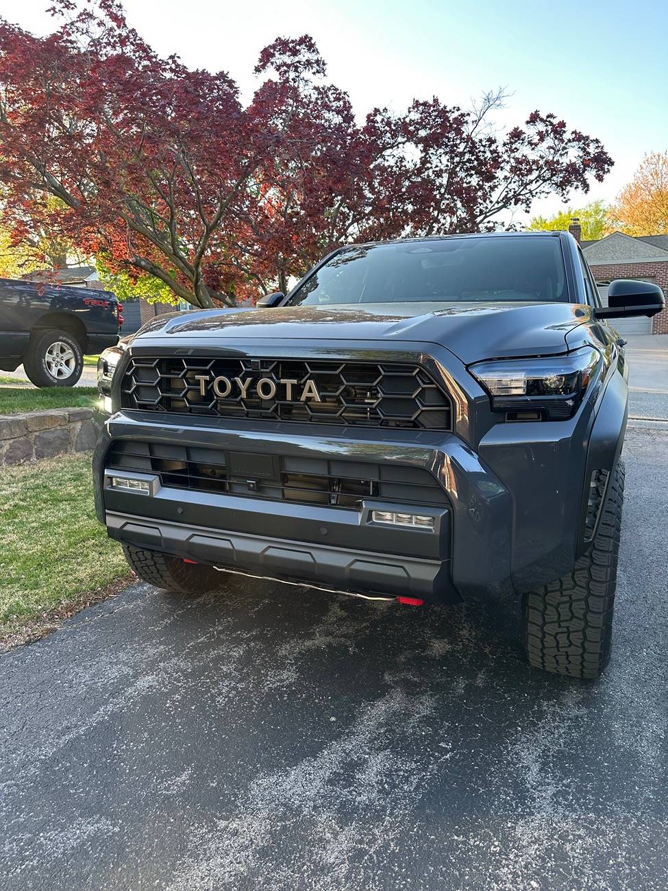

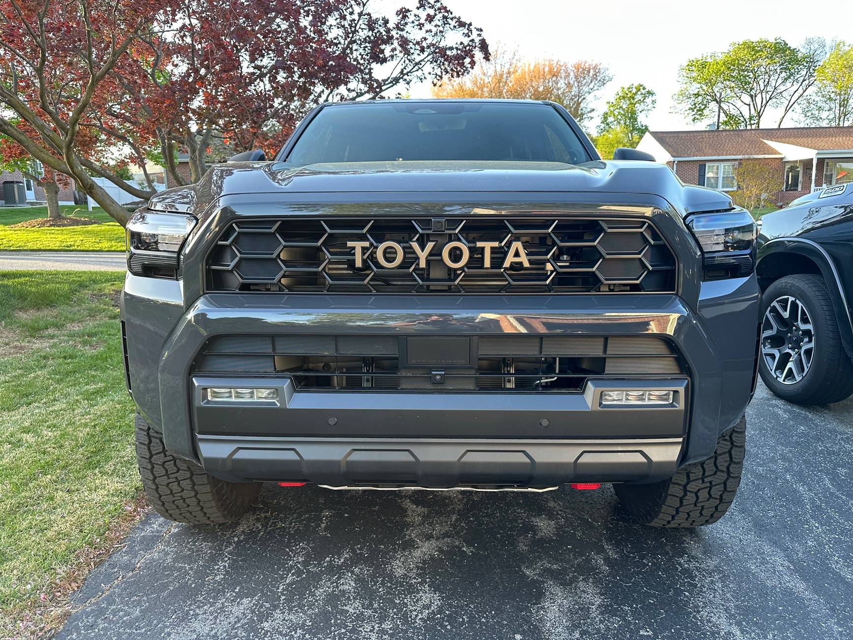

Well, here it is the Trailhunter Heritage Grille on our ORP. I kept the factory lower half and plugged the camera hole in the new grille with the Rave off road Camera bracket and dummy camera. Bought the matte black overlays but not sure im going to use them since we love the look of the bronze. Took me roughly an hour and a half from start to finish. Lots of screws lots of clips, if you're not mechanically inclined, I do not recommend trying this yourself.

This. Looks. Amazing.
Pulling the trigger on this now. I think you did the research work in another thread but just to make sure, is this the right part number?
Grille Sub Assembly Rad - Toyota (53101-35160)

Yep! That's the one. If you need the dummy camera and bracket to plug hole you can find at Raveoffroad.com. It was $70 shipped for the 2 3D printed pieces that I needed to slightly modify because the holes were no where close. It's nice once it's together but I could have probably rigged something up that would have worked just as good. 🤷🏻‍♂️

It takes some patience that's for sure! It's actually ridiculous how much of a pain it is just to get the factory one out.

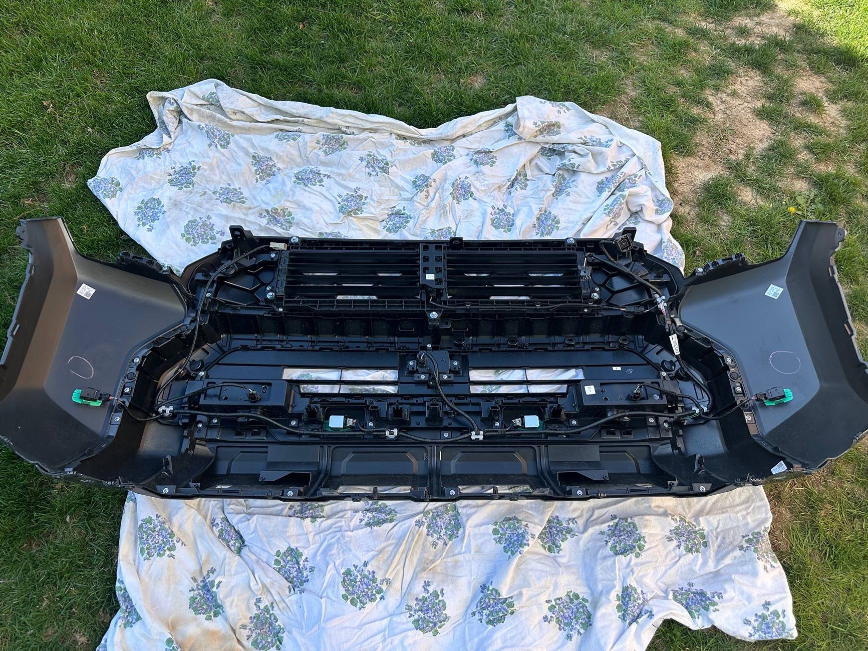

You would just need to take the front end off to that and its is pretty easy to do so. Then the headlights are right there

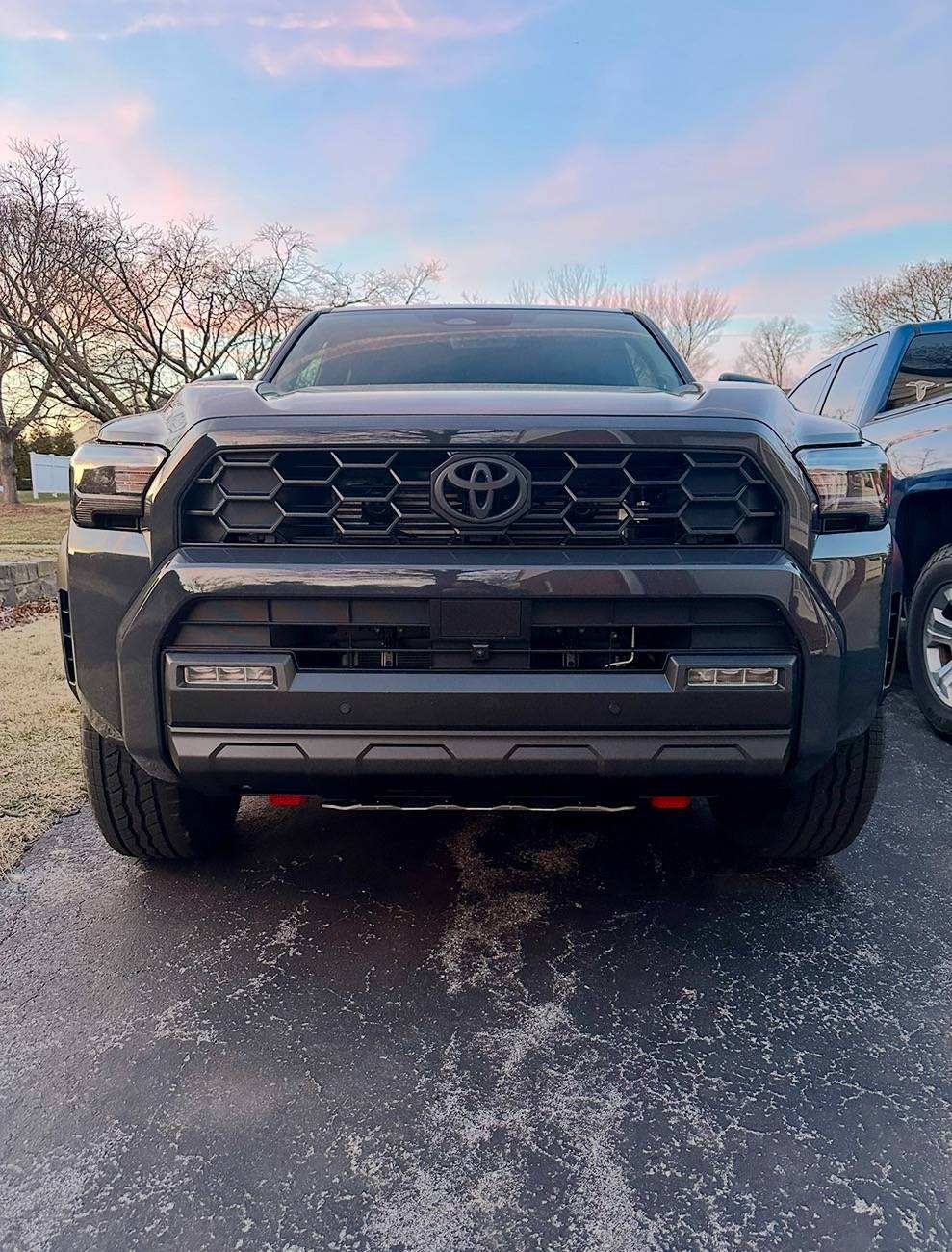

@Ericd6972 this looks awesome! I see that the camera is in the same position, does this mean that the camera only changes position if you get the light bar as well?
Did you just have to connect the 3d printed bracket to the new grill? And what modification did you have to do to make that work?
