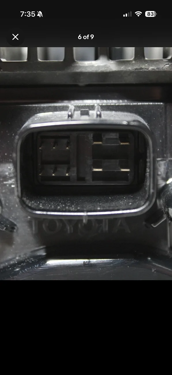

Curious if anybody has been able to get the connector/wiring for the factory light bar.
I just bought a factory light bar, and have all the rest of the parts to make the switch. I just have to figure out how to wire it to one of my factory aux switches. Having the OEM connector for the back of the light would be optimal, I think. But I can't find the ding dang dong part number or connector code/thing to look it up.

Was really wanting this too so following along. Thinking about doing the same and really want the oem plug for the light bar.

Also, what the heck could all these pins even for!?

I bought the factory light bar, should be here next week (weather is gonna hose up delivery times I'm sure). If I have to sit at a dealership parts guy for 30 minutes to find the connector, I will.
I'm assuming that the extra connections are for control via high beams and a couple of other parameters, unlike aftermarket bars. I just need the hot and ground LOL

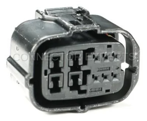

This connector is similar. But would be a $96.30 mistake if incorrect.
https://connectorexperts.com/i-24488621-cet1013.html
These guys also take requests to help identify a connector when you send pics.
https://connectorexperts.com/if-5848-connector-quote.html
Whoa. That looks crazy close. I image searched and found one on Ali express for around $15. I don’t have the light bar yet though, sort of dependent on us figuring out how to power it.

Wish you luck, that OEM light bar requires high beam to be "On" for it to work. So, I'm guessing it's powered from the factory headlight harness.
I'd put a sizeable wager on there being a 12v and ground that'll fire that puppy up. That's all I need to find. If I can get a factory connector to pin into, that would just be cake on top of my cake.
