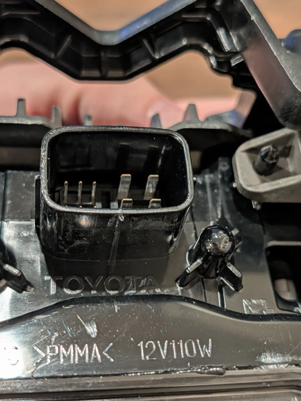

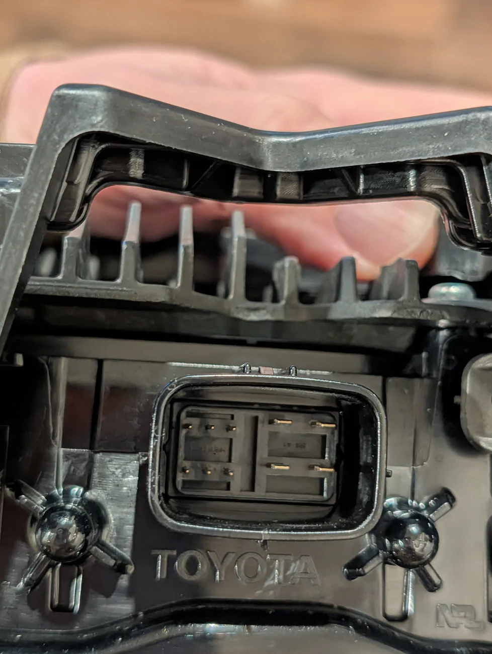

Got the light bar in today. It's in great shape, but I'm a little disappointed that there's no part number on it LOL
Here are a couple of slightly better pics of the connector.

Nice! What do we think the smaller pins are for? Something with the factory high beam reqs? I figured that would be handled up stream but who knows. What are next steps? We feed this thing 12Vs!?

Not sure. I only had a few minutes to peep it out and two of the small pins have a closed circuit to one of the large posts (with no power to it)...I was just checking for connectivity though. Haven't put 12v to it yet. I don't know when I will either. This month is busy, and I'm absolutely waiting for a warm day LOL
