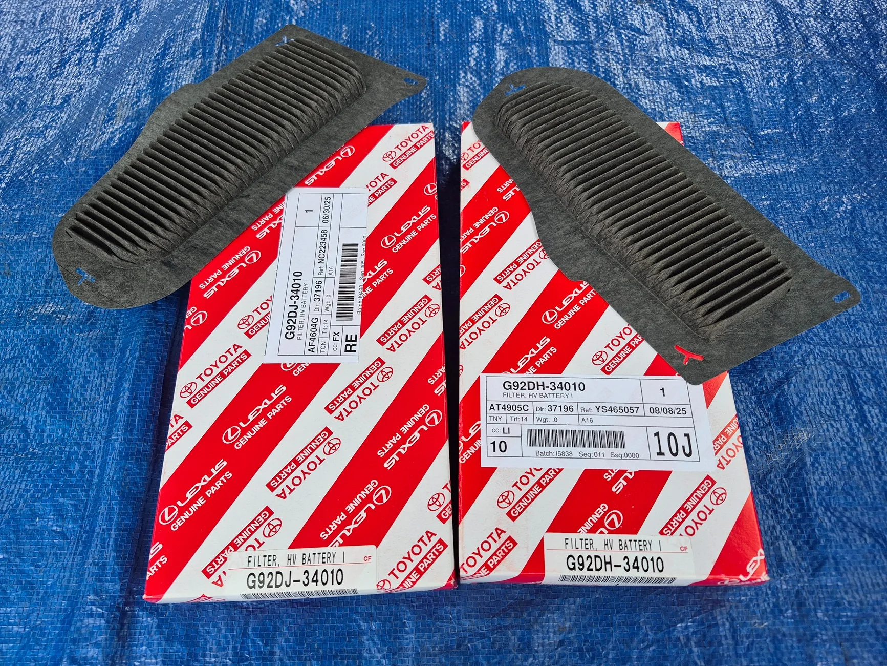

Due to offroading and lack of rain in my area I decided to check my battery filters. Glad I did. Unfortunately I didn't think about doing a writeup until after I was done so I have no before pics. Take my word, not only was the filters dirty but the tube and foam leading down to the fan were coated. The Toyota parts manager said they had a hybrid in this week with a overheating battery and when they took the covers off they found the filters clogged with dog hair. These fans really move some air, do not recommend driving on dusty road with rear window down...
Part Number: G92DH-34010 / G92DJ-34010
What they look like:

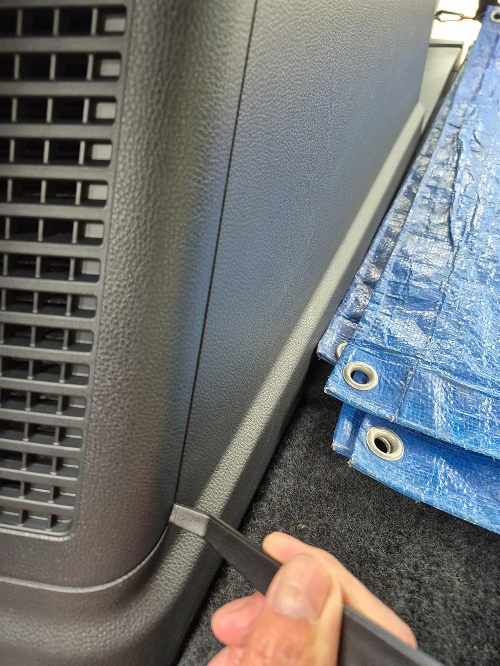

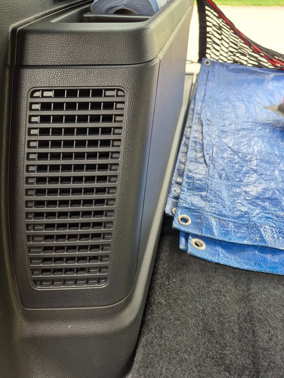

Where their located behind second row seats, one on each side:
2025 2026 4runner 6th gen Hybrid Battery Filter Replacement - DIY Writeup & Part Number (G92DH-34010 / G92DJ-34010) 20250818_152622

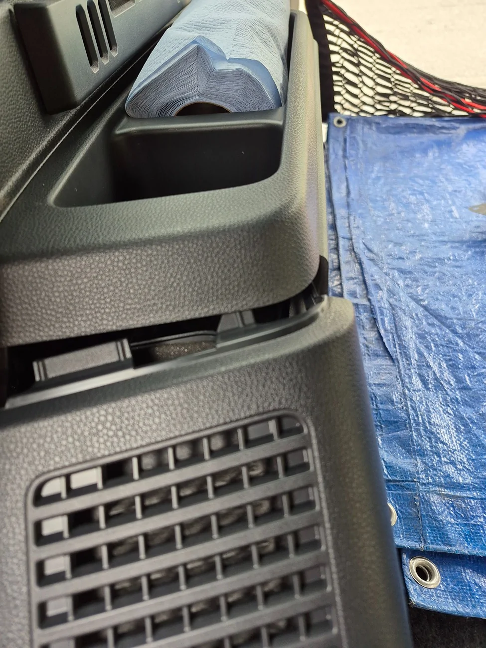

To Remove, just use a panel removal tool or a flathead screw driver with a piece of tape over the blade and work the lower outer corner so you can grab it. Once corner is out, give a careful firm tug and it'll pop out and should come free, Note the upper tabs that go behind the top piece.

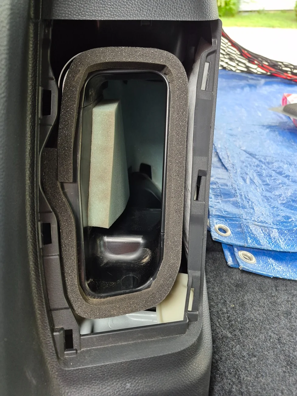

Pic of the tube leading to the battery and fan, which was completely coated with dust.

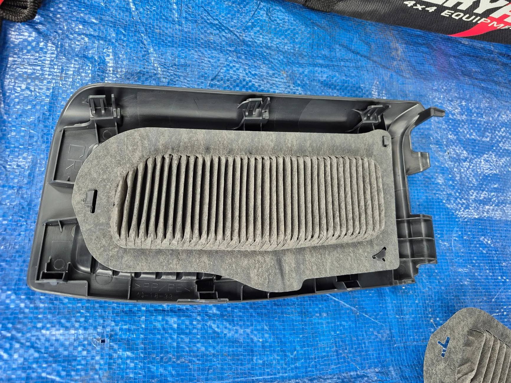

New filter in place. To reinstall just put the top tabs under the top shelf and pop back in. Very simple, took 20 minutes.
Part # and what they look like:

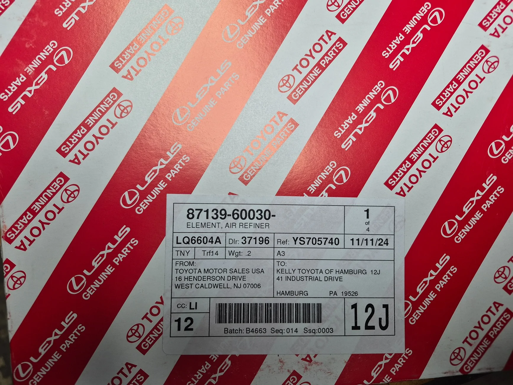

BTW, Does anyone know the OEM Toyota part number for the Cabin and Engine air filters, 2025 4Runner Hybrid? I get mixed results when searching for the correct part numbers.

Changed mine after my 5K checkup. They noted they checked it but it smelt musty. When I opened it up it was dirty. Complained to Dealership that if I can't trust them to check a simple filter, what else can't I trust them about.

Sorry, guess I did not supply enough information. Looking for parts numbers for Cabin and Engine air filters for 2025 4Runner Trailhunter (Hybrid). The air filter is 'round' similar to a K&N SE-0930.
Thanks
Didn't change my engine air filter yet but this is the cabin filter #.
My understanding after doing research and searching together w/ dealer parts desk (this was a few months back)
The TH engine air intake filter is reusable. Like a K & N filter type. Toyota sells the kit or use others.
Hard to find even the Taco TH filter.
