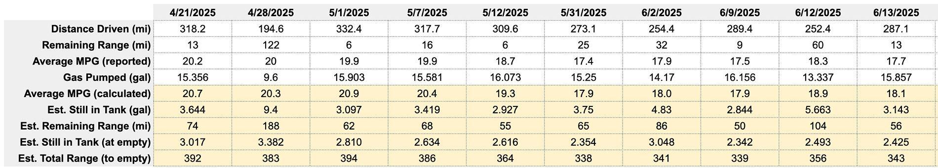

And I forgot to ask if your milage is adjusted for the larger tires. From threads above it sounds like you were getting ~320 DTE after fill at the start and that dropped to ~300 with the bigger tires. There are two factors in play: 1. Heavier tires definitely impact MPGs negatively. 2. Assumedly that 300 miles is from the DTE reading after fill on the dash and doesn't account for the almost 2% artificial loss in milage due to fewer rotations. With the difference in tire size (265/70R18 to 275/70R18) the difference is ~1.8% or ~5.5 miles at 300.
So... Hypothesis: 15 mile drop from additional weight and another 5.5 from size difference unaccounted for.
Obviously the numbers are not this precise and I may be completely off base about your specific scenario. but I realized after re-reading my previous post that tire size could be part of your decrease that needs to be taken into account.
Note: I have documented DTE readings after fill as high as 366 (with OEM tires in summer and lots of highway) and as low as 288 (with 285/70s in winter with mostly very short trips and some 4LO thrown in).
OEM tires w/ air dam: 17 tank avg post fill DTE: 348.
285/70 E-load no air dam: 13 tank avg post fill DTE: 315.
