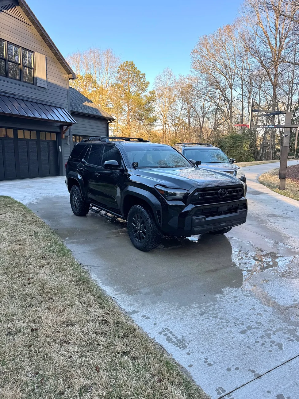

I want to get with 285s or 275s with 0mm offset wheels but I don’t want any rubbing or very minimal rubbing (like mudguard rub or something), I do plan to install RC 2in leveling kit though, what tire size do yall suggest?

From everything I’ve read, 275 won’t rub but not sure about 285. Wheel width plays a roll as well. The 0 offset will push the wheels outboard about an inch. Believe the SR5 wheels are +25.

I think a 0 offset with 275`s will rub. I had 275`s on a 25 offset( trd pro wheels) with a 2" RC spacer and I didnt notice any rubbing but it was very close.
Consider a wheel with 25 to 35 offset. 285`s will probably rub with any offset. Dont de-value your ride by cutting anything in the front.

assume you have 17s, not 18s? Id start there because its an easier tire to shop for…. and assuming you have 17s, i still dont know if 285/70/17 would be OK cuz of that offset, 0 is pretty wicked, at +25 offset u would be pretty good i think…..If you have 18s… at 0 offset, id be worried about 275 tbh, i think 265 would be max and i still dont know about your fender liners…. Id question the 0 offset desire, i think a +25 and 285/70/17s, should fit and would look nice and plump. The stock trd pro wheels are +25 and with 275-70-18s, looks nice…

Totally missed the rc lift… my bad, i think with the rc lift 285/70/17 at 0 offset should be OK, and 275/70/18 should be ok. Without lift, neither.

Just put on 285 70 17 et10 and it rubs a little in reverse when turning on the front edge of the liner. No lift
