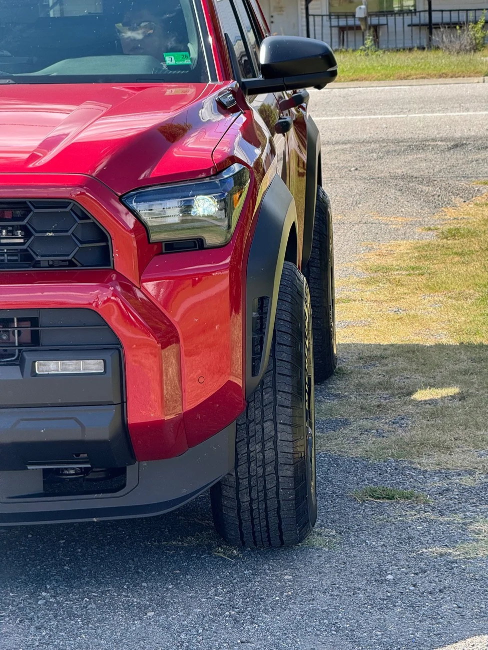

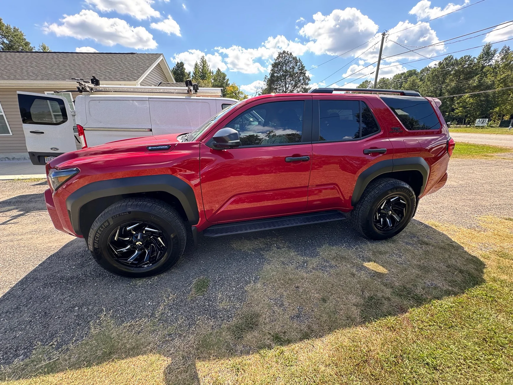

These on my ORP hybrid are +1 offset
2025 2026 4runner 6th gen Stock 4Runner with 0 offset wheels? IMG_2307
2025 2026 4runner 6th gen Stock 4Runner with 0 offset wheels? IMG_2306
What are your tire and wheel dimensions? A 255 tire on a 18x6" wheel will look differently than a 285 tire on 18x9" wheels.

Was there any type of modification done? Also what’s your tire size?
No suspension mods, minor rubbing at full lock turn with factory 265/70R18 tires on 18x9 +1
