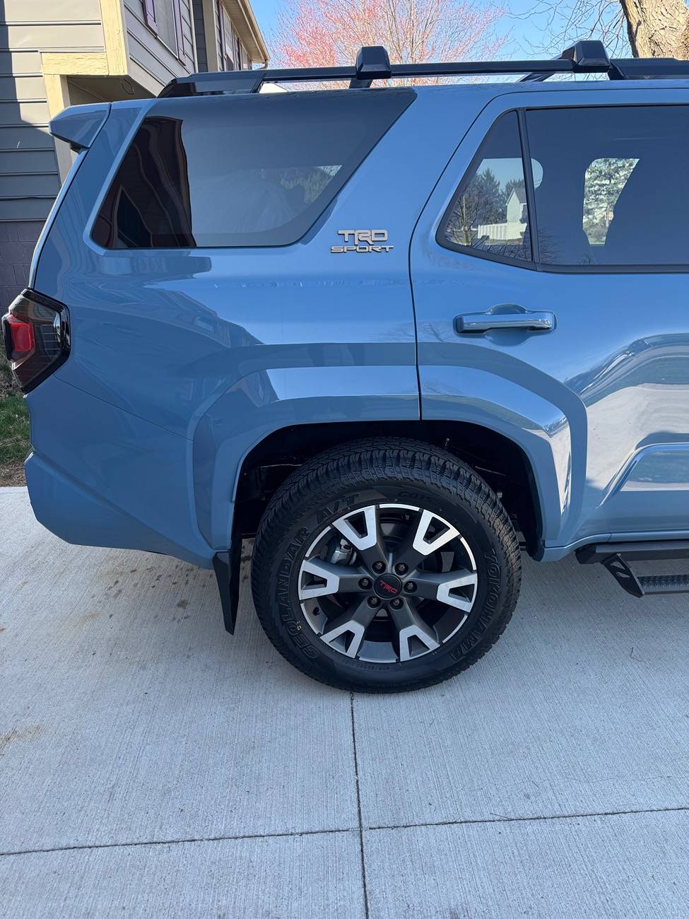

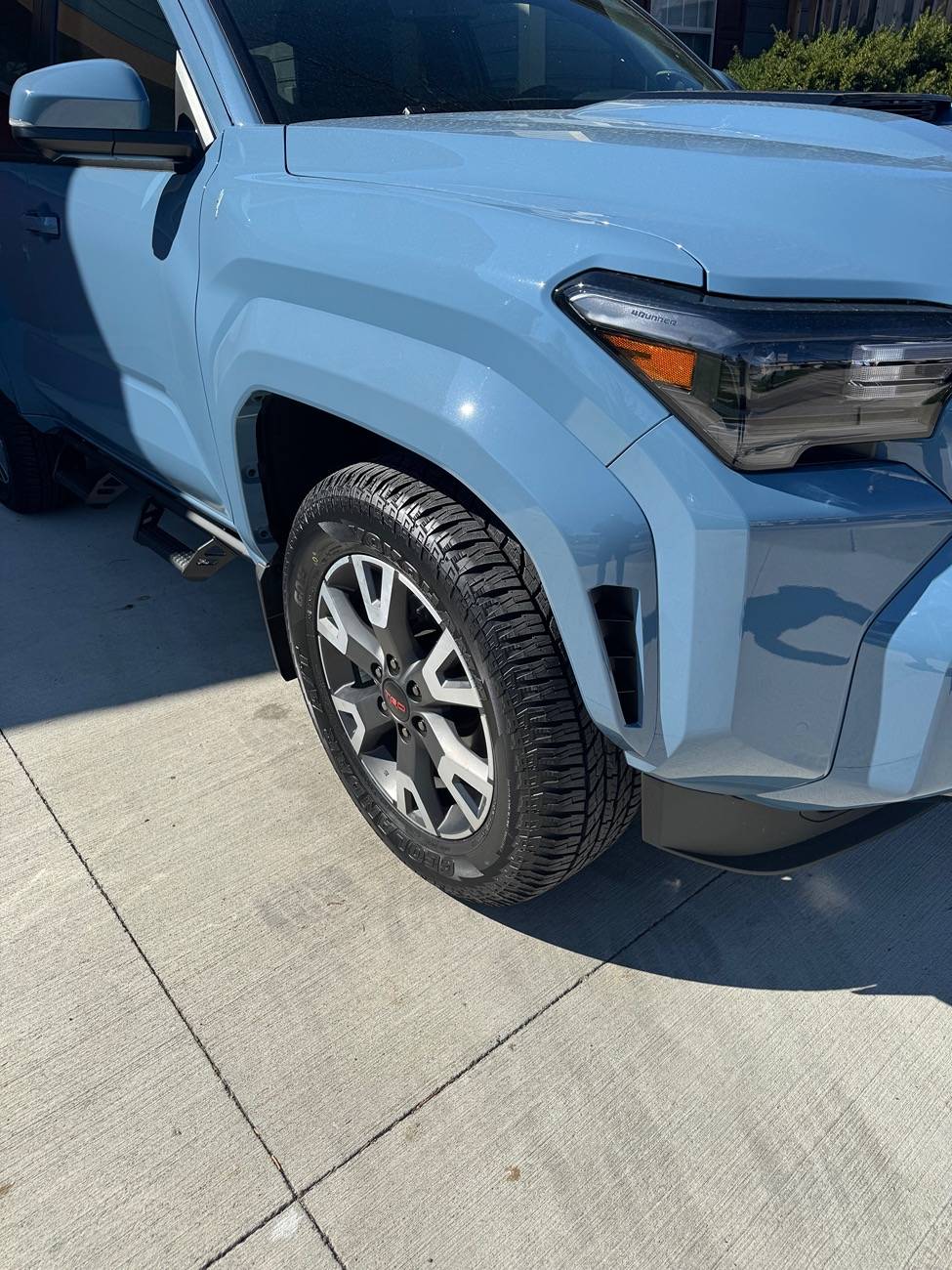

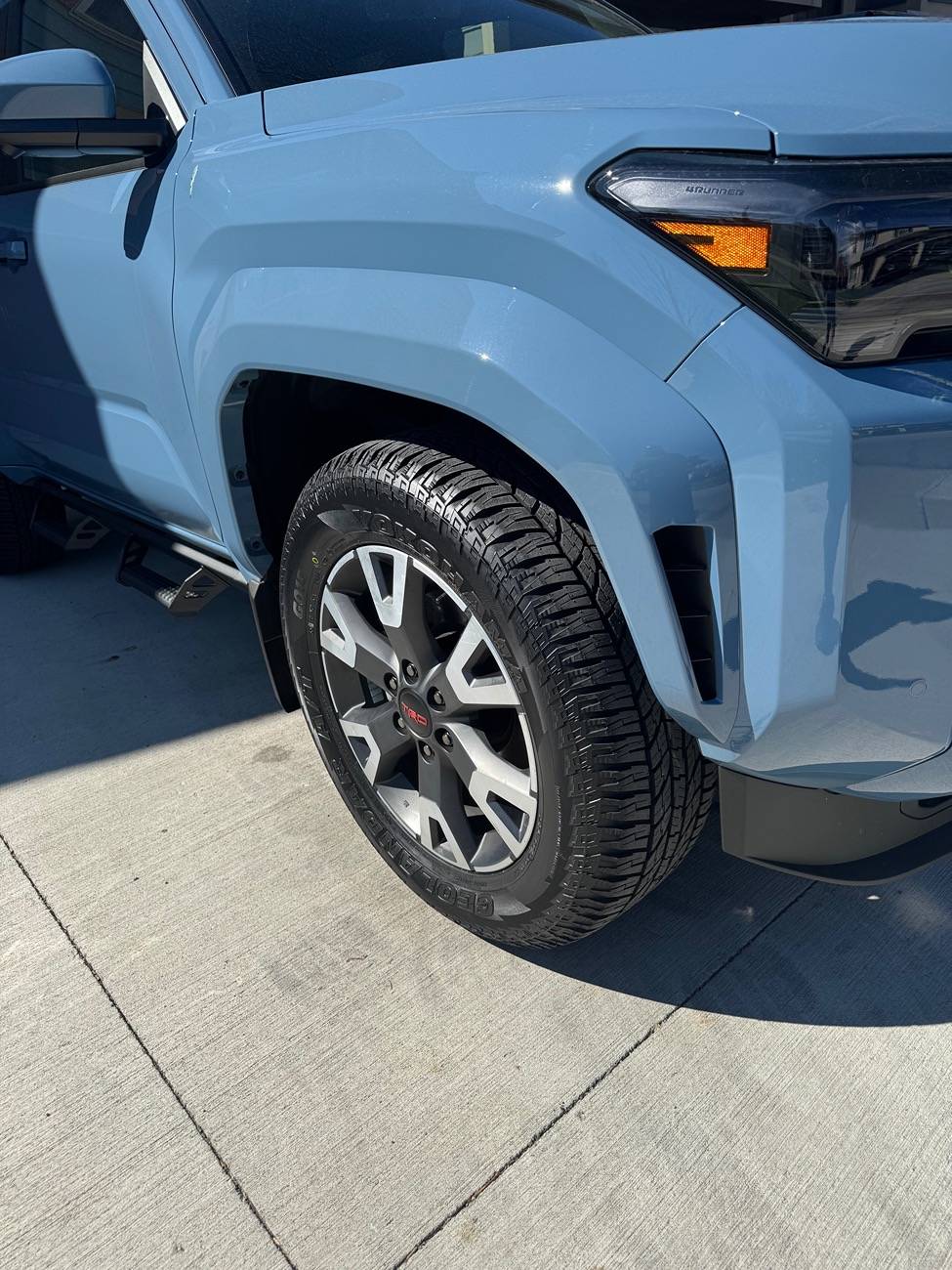

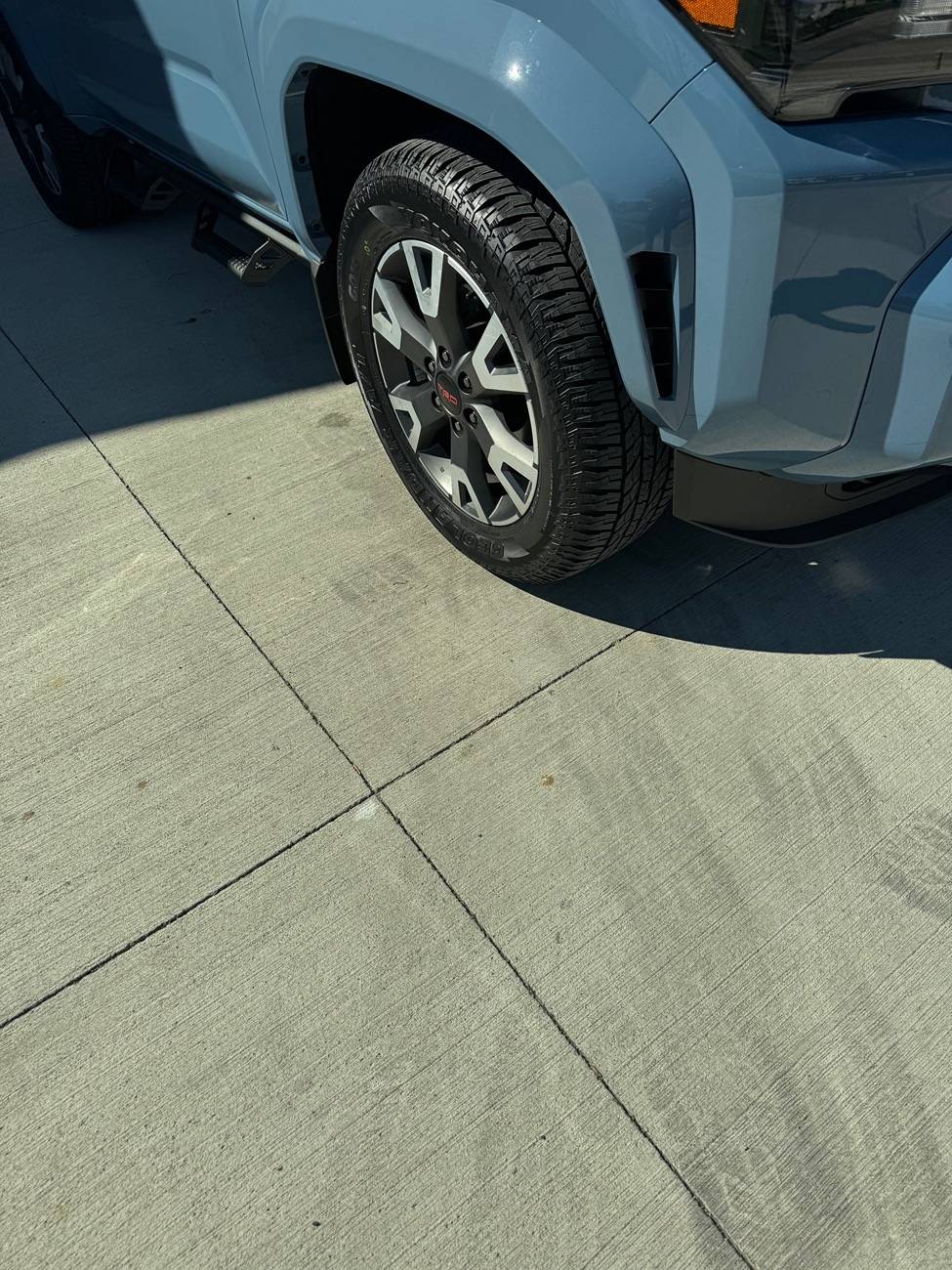

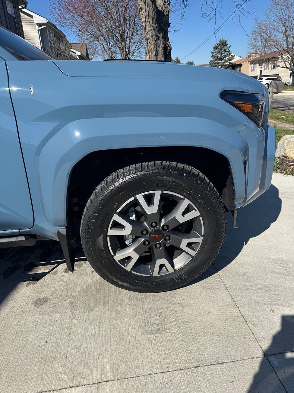

Tire are 275/60R20 and 33" tall (Yokohama Geolander A/T). They fit right on no rubbing so far. The factory wheel measures 8" wide where the tires seat . Back space or offset is 7" deep . Wheels are 9" wide outside.
