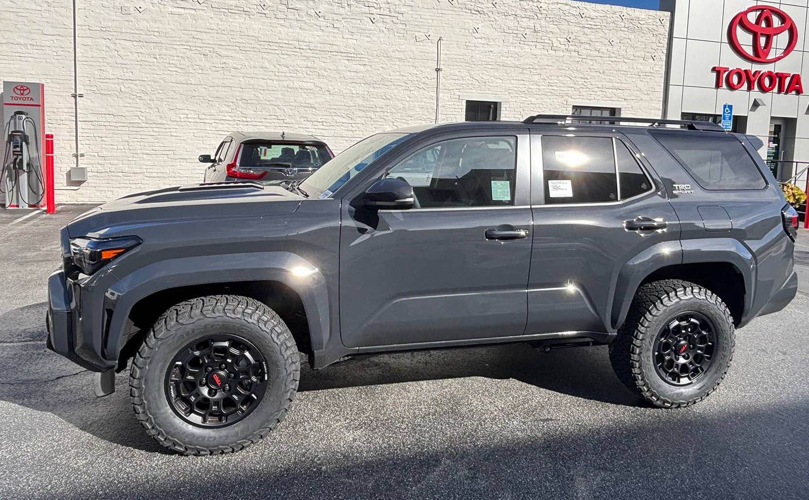

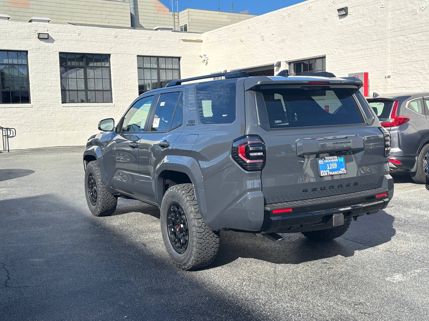

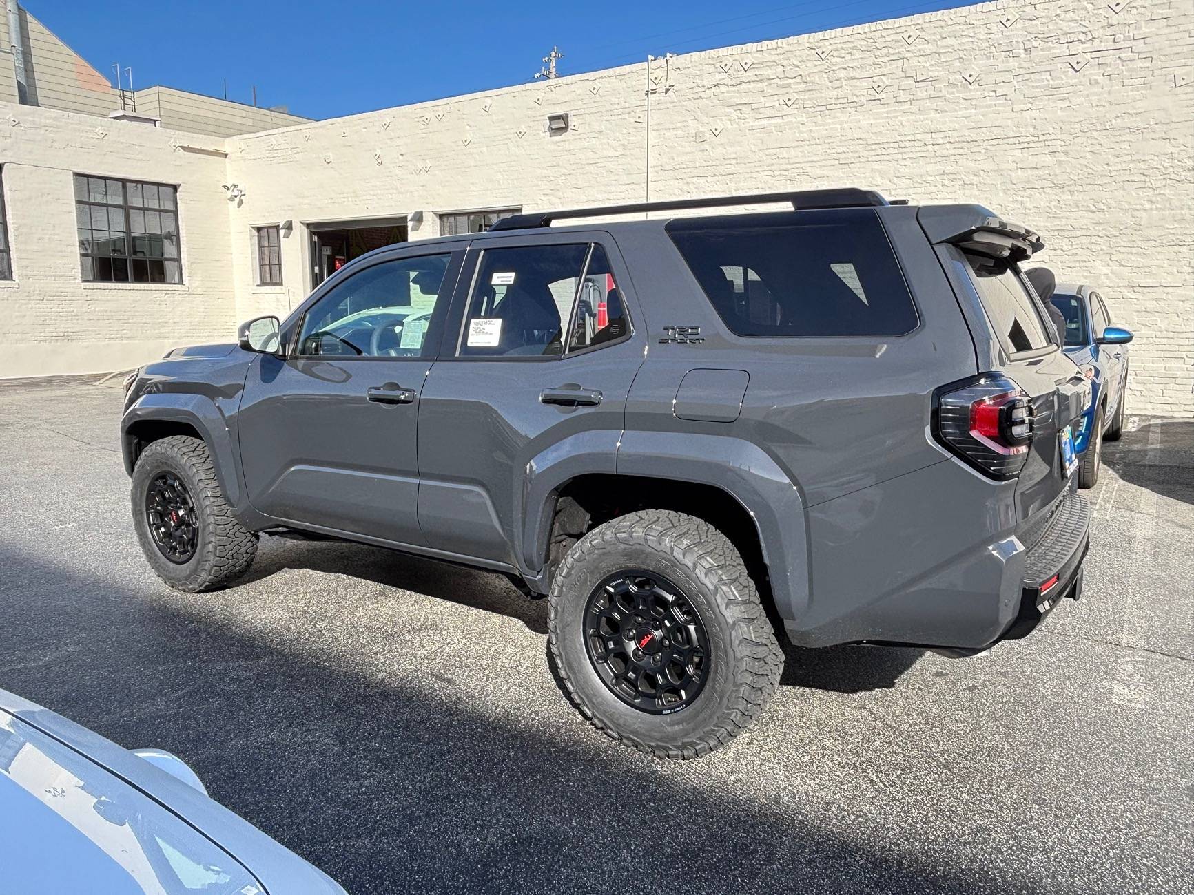

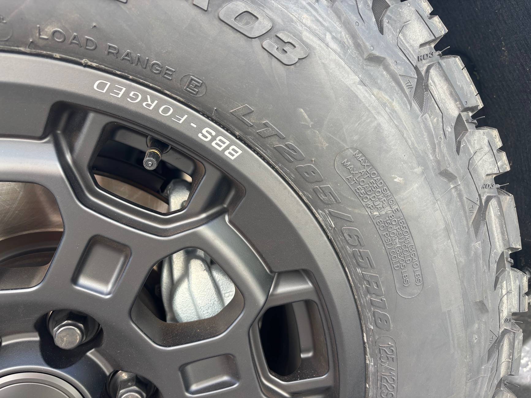

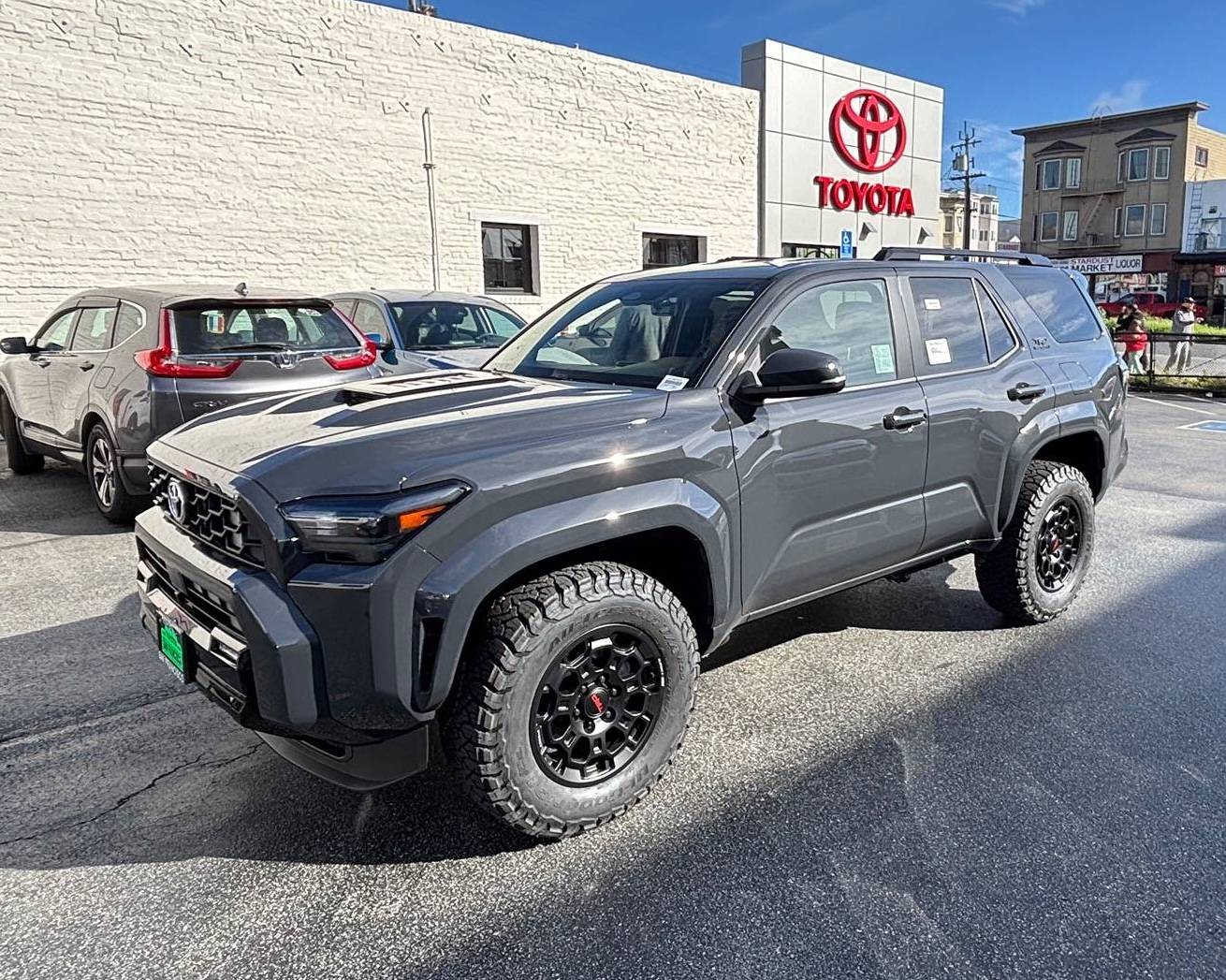

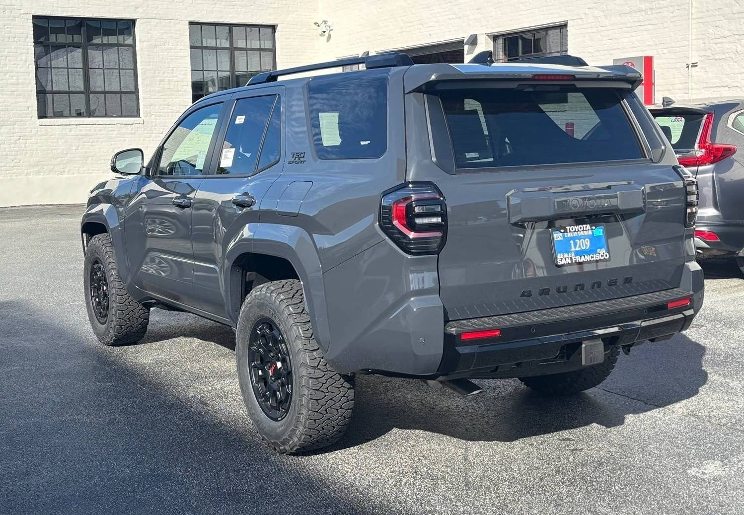

Photos by @coolshade of Sequoia / Tundra TRD Pro OEM BBS Wheels on a 2025 4Runner TRD Sport.
Specs:
Sequoia / Tundra TRD Pro OEM BBS Wheels (18x8")
Part number: PT960-34220-2F
+47.5mm offset / 6.5" back spacing
MSRP $1,098.98 per wheel
(but used take-off sets available for $1500/set on Ebay and Facebook marketplace)
Tires are KO3 285/65R18.

Yea love this design and the offset looks great for a flush look.
Someone who already has their 4Runner please put these on so we know what it looks like. I think it'll look just as good.

Happened to see an underground 6th gen TRD sport with oem sequoia TRD pro wheels installed by the dealer. Here are some pics. Loving the painted fender flares, handles, and tailgate hump on the trd sport. Wish the OR and ORP came painted liked this
This car was up for grabs at San Francisco Toyota.

Just got lucky while bringing my Highlander in for an oil change. The dealer really wanted hybrid highlanders so I was happy to give them the keys. No deposit, it was the only one they had and put the Tundra/Sequoia BBS wheels and KO3 tires (285/65R18)
Looks amazing and the height is nearly even with where my 5th gen with a 3” icon lift and 285/75’s stood.
Super happy with it, and love the stance, no rubbing lock to lock.
Wheels / Tires Specs:

Looks great!!
These with a true 35in tire and a lift would be ideal for me personally

Any lift on this?

those look great. I like how they don't have a crazy amount of poke. I really wish they made these in 17s.
