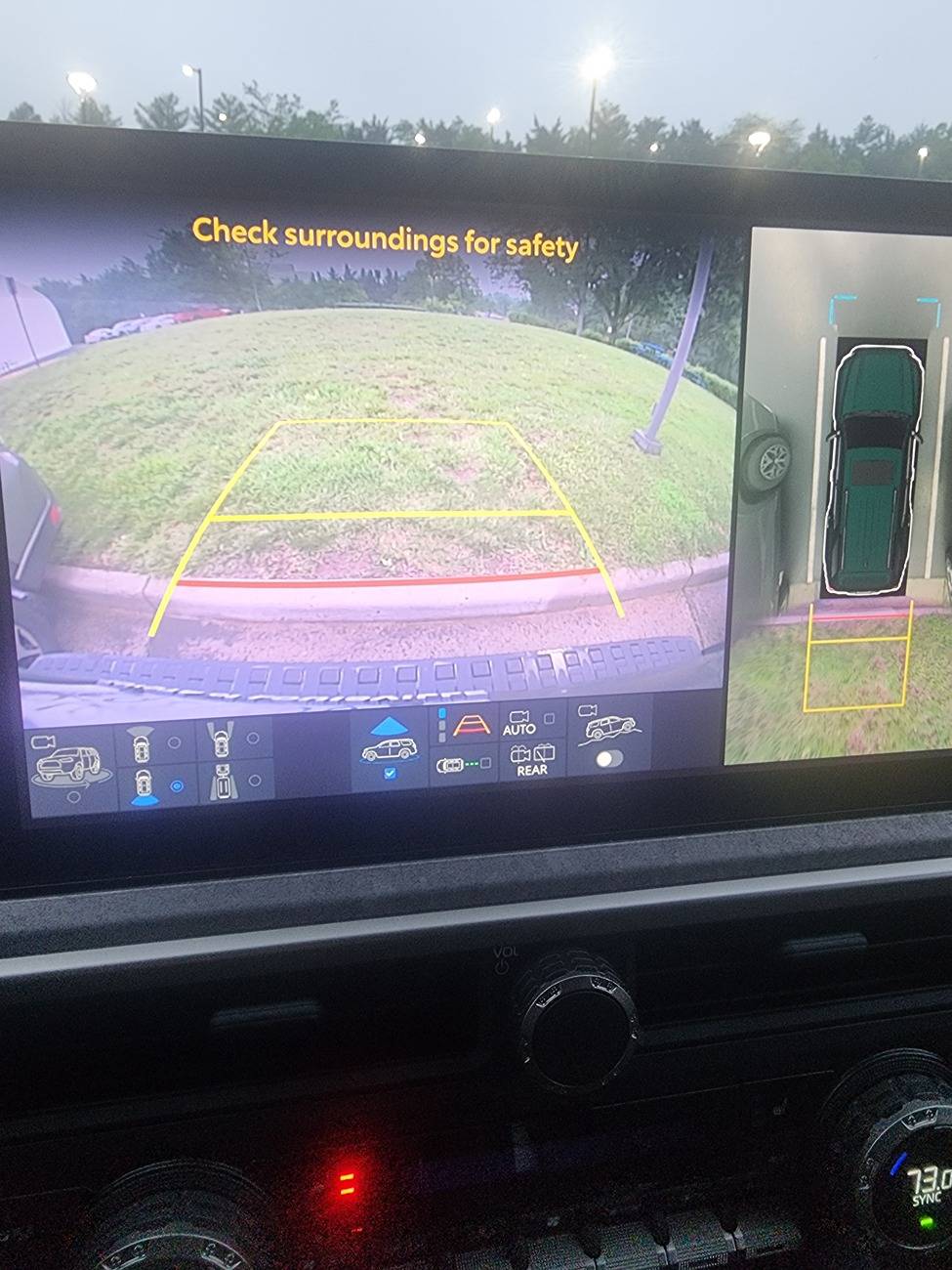

-Pink tint on back up camera sometimes when close to objects.

- Camera issue could be due to the software trying to adjust the image based on the environment. Similar to a night vision camera.

Interesting issue with the backup camera. I haven’t experienced anything like that after 5,000 miles. I’d say something isn’t right if that was a daytime image (which it appears to be)
Yea I noticed it happens after it rains (picture was taken around 6am) and I get close to objects not when they are far away.
I have the same issue, especially when it's raining, as soon as it stops, it clears. But I also have issues seeing in low light, looks like heavy fog.
I thought it was just a feature of an electronic backup camera but if others aren't having these issues maybe I should take it in and have them check it.
