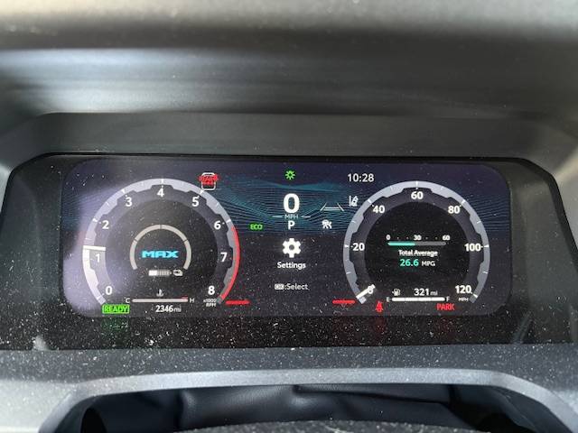

I have found that the car seems to want to avoid downshifting (e.g. when going uphill) by using the electric motor to assist the gas engine while staying in whatever higher gear it's currently in. It'll give up and downshift if/when high electric power isn't sufficient, which can result in fairly abrupt acceleration. Not sure if this is the same symptom you're experiencing, but here's how I've drawn the above conclusion:
If you enable the "motor power" gauge display, it shows when the electric motor is running (or not). The LHS side of the attached pic shows that the electric motor is NOT running because the analog gauge is all grey. When the motor is running the gauge will show blue, from a small amount of electric power to a lot. Charge level is shown by the bar graph below the blue "MAX" (3 out of 8 bars in the pic).

That is helpful, thank you. I’ve experienced similar so I‘ll check this out on mine.
More importantly how are you getting 26.6mpg ors did you just reset it after a fillup?
jimr
jim
Jun 19, 2025
colorado
6th gen, 3rd gen
Extra good mileage came from buying gas at 9000 feet elevation, resetting, then driving home 30 miles away at 6000 feet.
