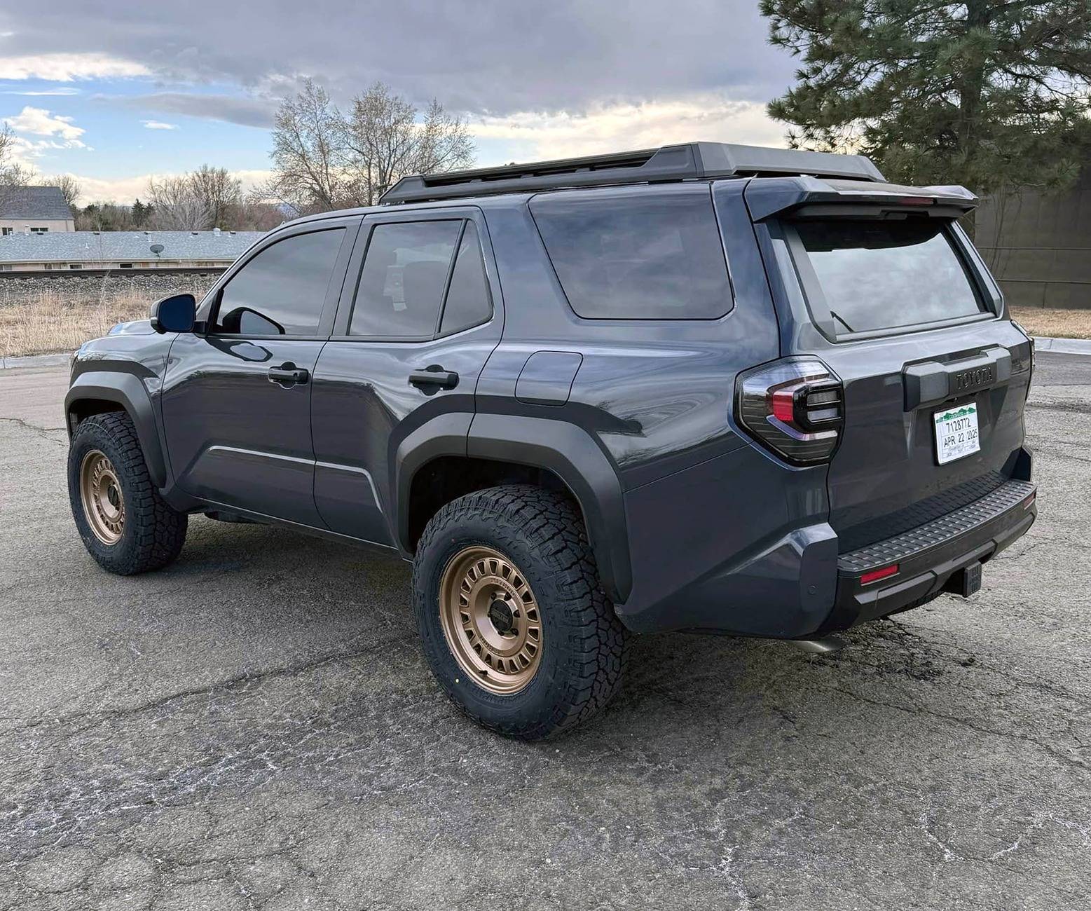

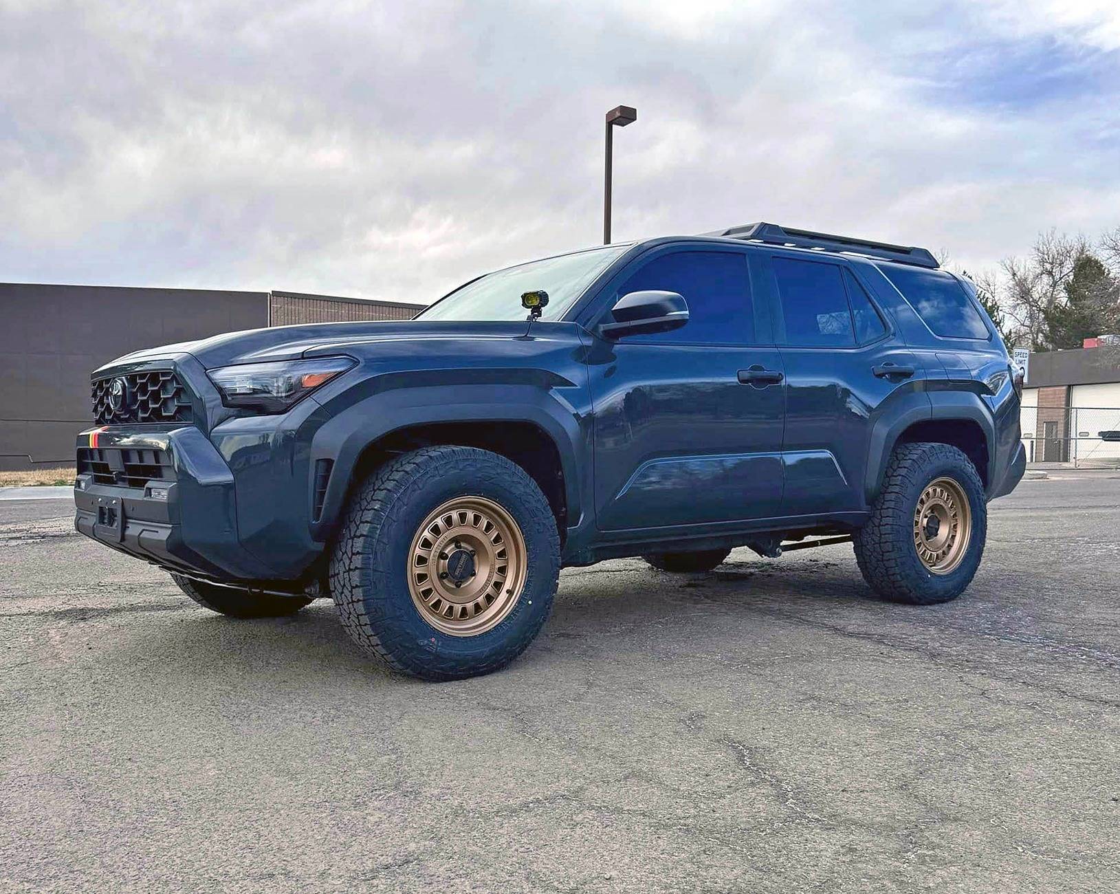

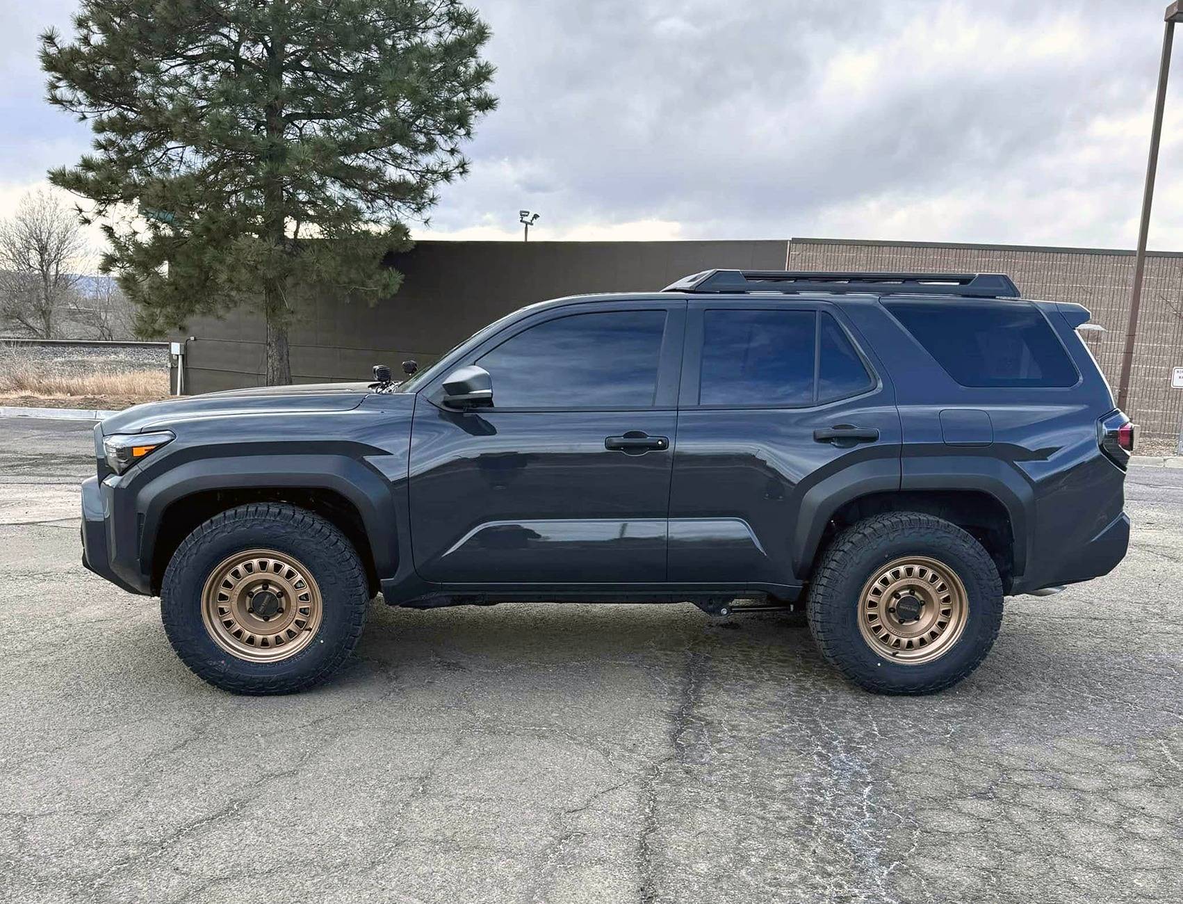

18" Method 320 (+18 offset) Bronze Wheels
Falken Wildpeak AT4 275/70/18
Factory suspension - no lift
Very slight rub - Pushed the liner in, no cut
2 cops pulled into the parking lot while I was taking pictures to check it out. Said it was the first one they saw live and they both had 5gens.
18%22 Method 320 (+18 offset) bronze wheels + Falken Wildpeak 275:17R18 on Underground TRD Off...jpg

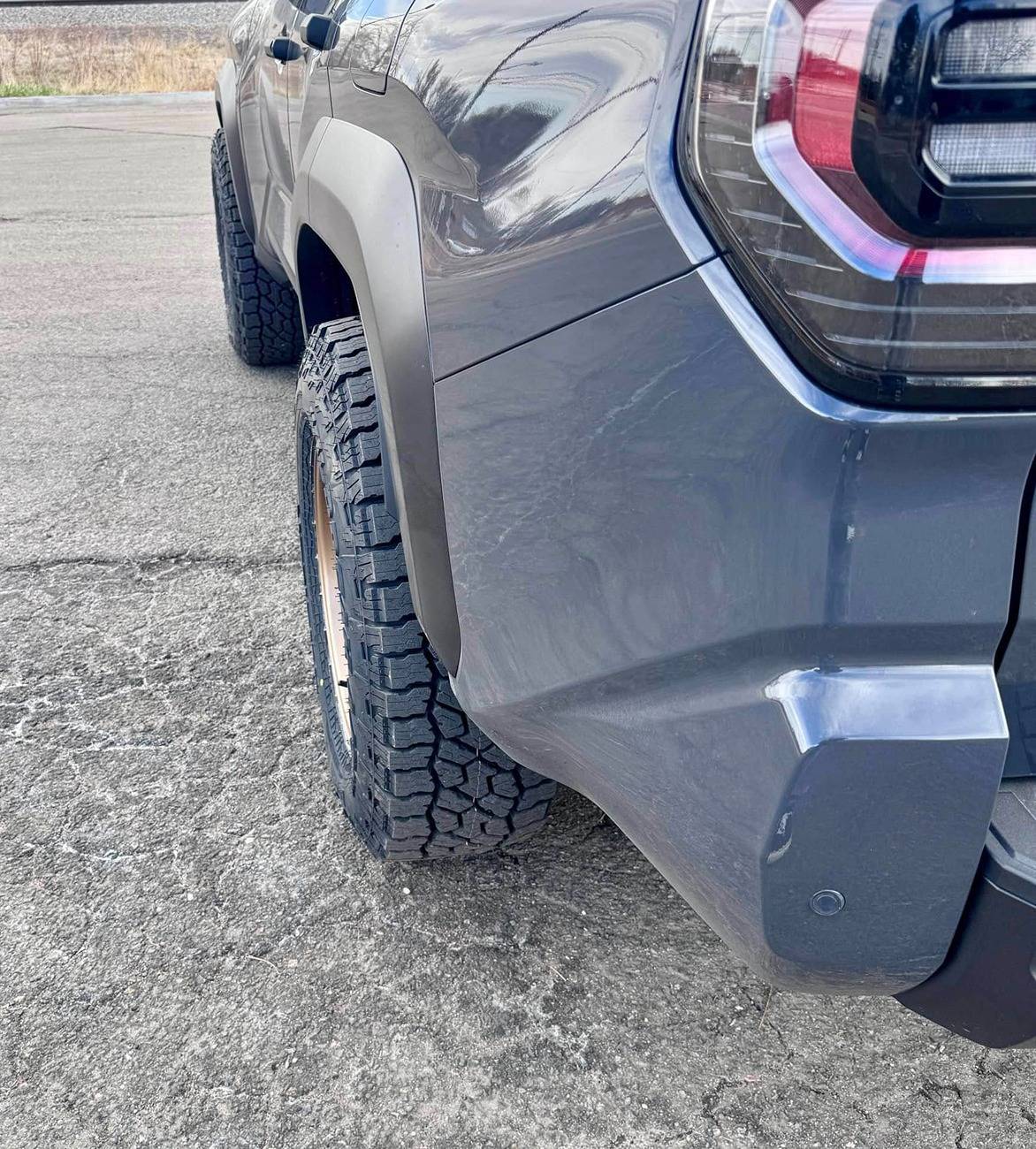

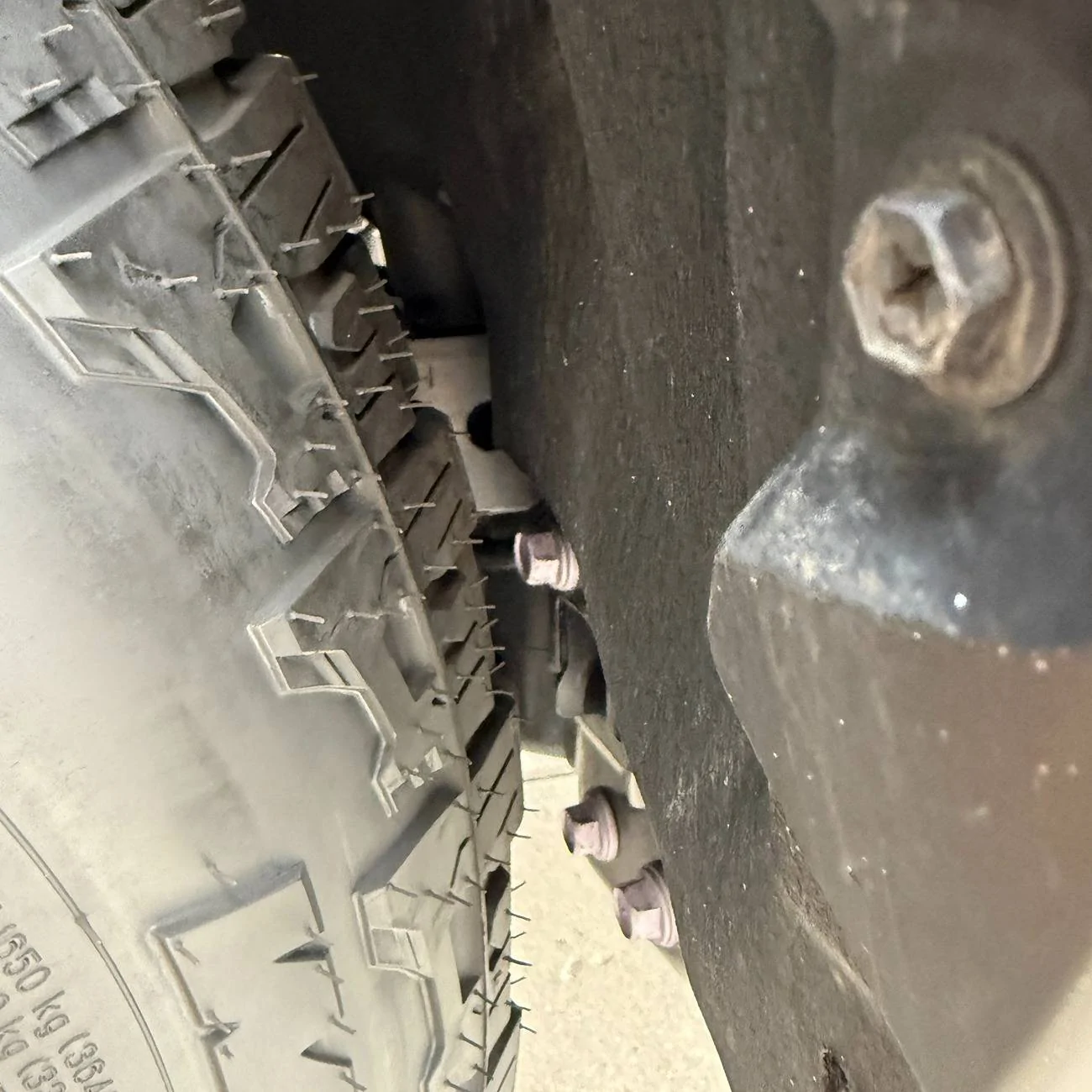

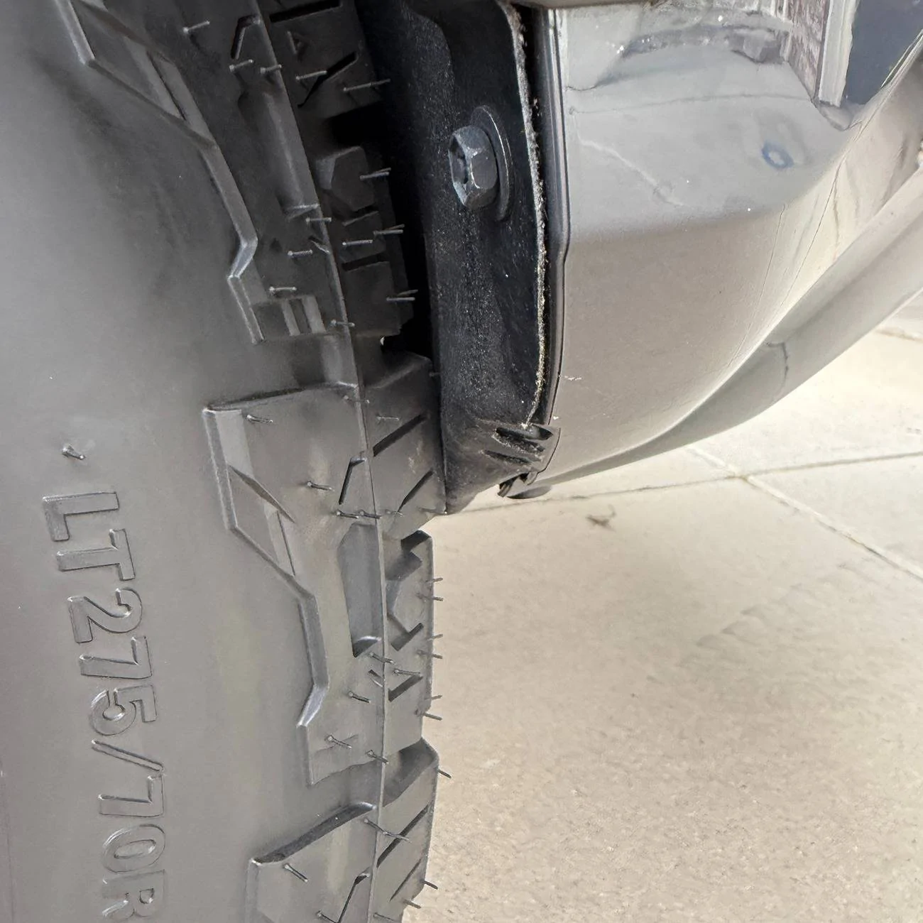

No lift kit, yet. Slight rubbing at full lock in the front. I just need to push that felt wheel well liner in about 1/2 in the front to be safe and it will be fine. I do plan on putting 2in lift on the front so it's fine for now. The back I did remove the part that gives more room there and there is +1 inche in the rear.
Front
2025 4runner 6th gen 18" Method 320 (+18 offset) bronze wheels + Wildpeak 275/70R18 on Underground TRD Off-Road Premium IMG_7612
Rear
2025 4runner 6th gen 18" Method 320 (+18 offset) bronze wheels + Wildpeak 275/70R18 on Underground TRD Off-Road Premium IMG_7611

Yeah put like 1200 miles on them on a road trip 2 days after having them put on with no issues. I think with any lift they wouldn't rub at all. The rub is just at the very bottom of the fender liner. I do also think my +18 offset is causing the rub, others report with the stock +55 offset the same size tier has no rub.
