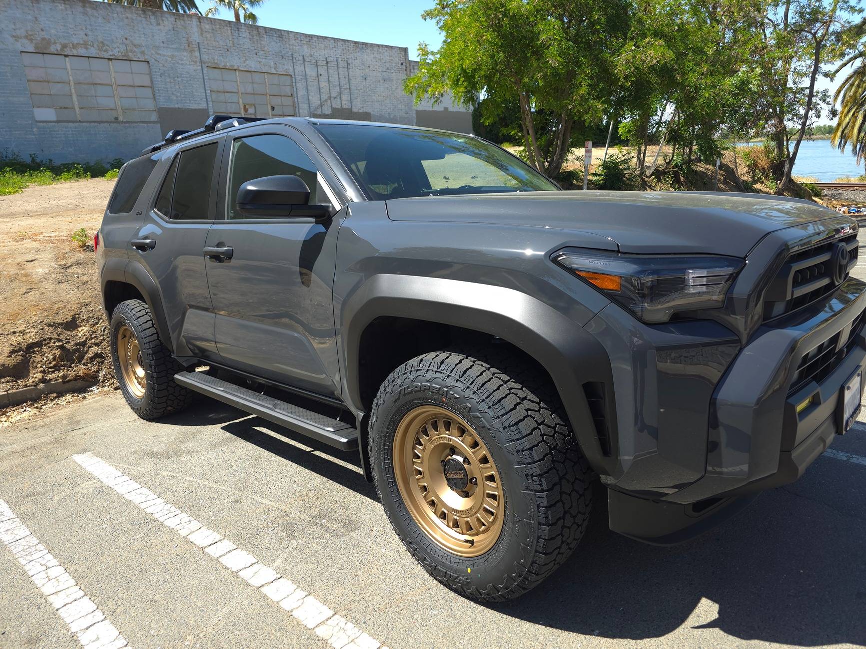

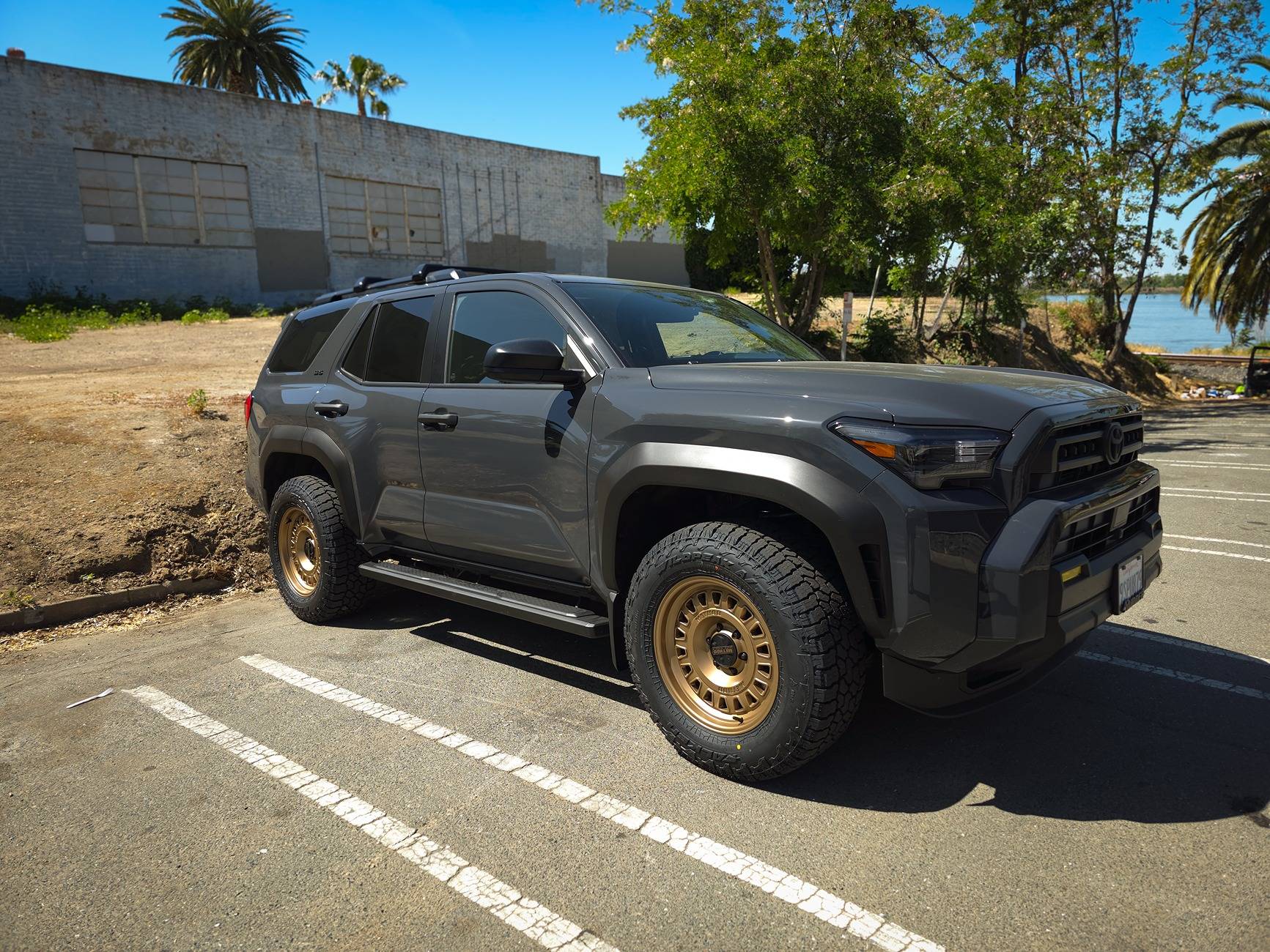

Installed on my Underground 2025 SR5. I'm going to a certain look. I'm not trying to have look off-roady at the moment. This is pretty much my daily. But I do want that little poke. No rubbing but pretty close to the mudflaps when turning all the way. I don't want to remove the mudflaps. Not for now at least.
I will install Rought Country leveling kit soon.
2025 4runner 6th gen Bronze Method 320 18x9 (6x5.5) +18 offset w/ Falken Wildpeak A/T4W 275/65/18 installed on my Underground 2025 SR5. No lift. Bronze Method 320 18x9 (6x5.5) +18 offset w: Falken Wildpeak A:T4W 275:65:18 installed on my U

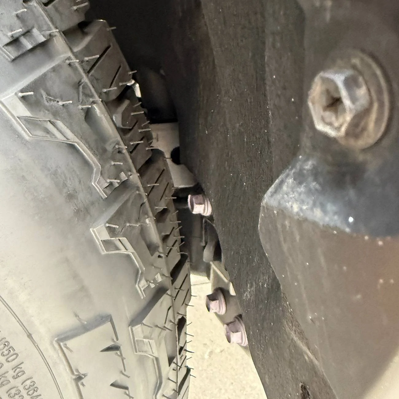

I run 275/70/18 and the mud flaps will rub. Mine were taken off as well as the part behind it, I think it's called safety something. They also rubbed at full lock in the front very slightly so I pushed in the liner to give them clearance. Will install the rough country 2in lift in a few weeks and won't be an issue but stock 275/70/18 do rub slightly. Offset does make a difference as well, mine at +18.
Rear of the front tire with flaps removed and safty thing removed
2025 4runner 6th gen Bronze Method 320 18x9 (6x5.5) +18 offset w/ Falken Wildpeak A/T4W 275/65/18 installed on my Underground 2025 SR5. No lift. IMG_7611
Front of front tire at full lock before i pushed the liner forward.
Thanks. I’ll go with the 265/70/18. I don’t want to lose my mud flaps as they are protecting the body because we travel on a gravel road everyday. I appreciate you.

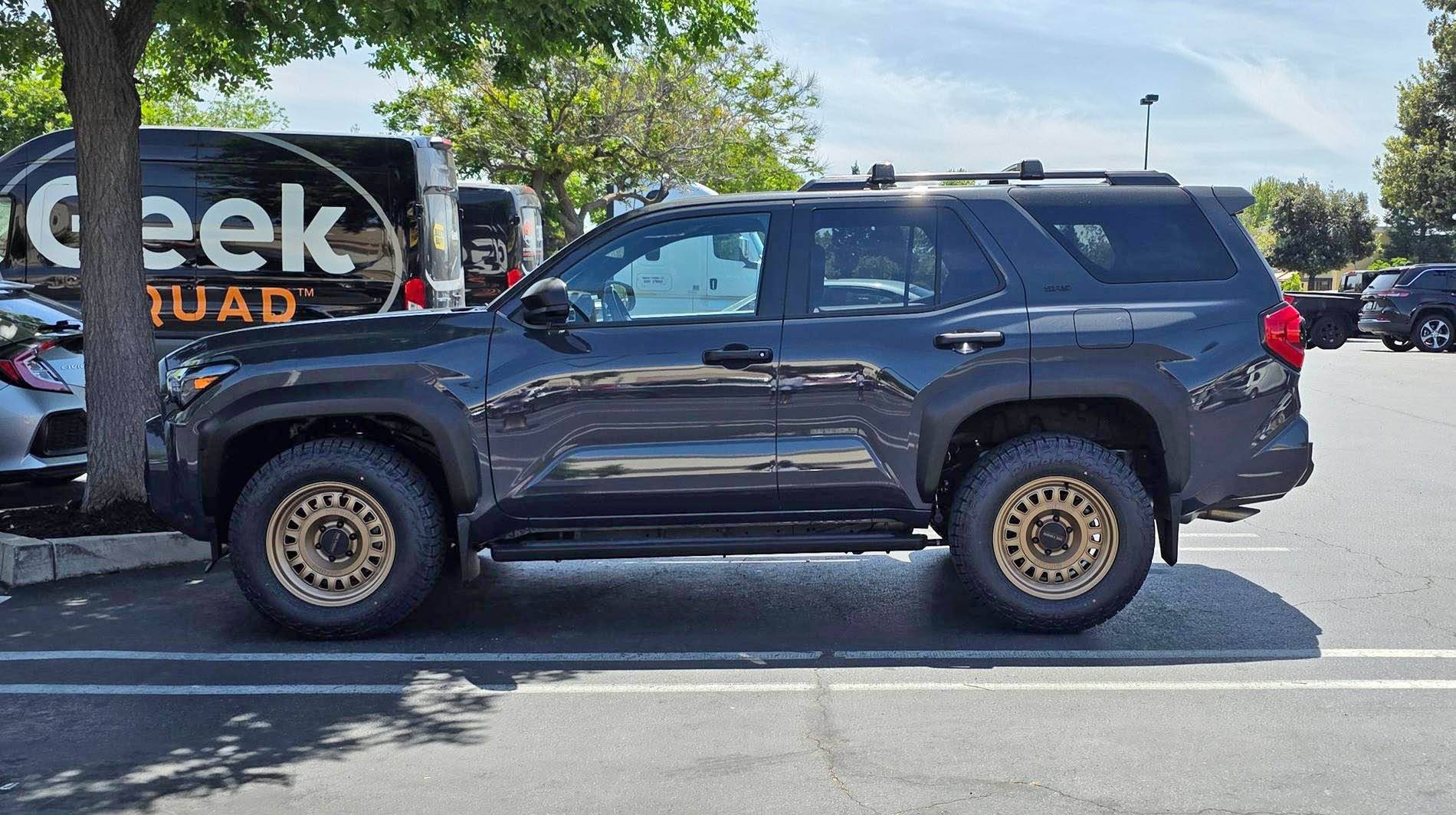

I was going to show you Relim's post actually. Beat me to it. You're going to install rough country leveling kit correct? I think you should be ok after. In my opinion, 265/70/18 still rub either way without the lift. 265/70/18 either way will be taller. As far as looks, 265/70/18 might be pushed in more because of your offset. I was originally deciding to go with 285/65/18 instead of 275/65/18. But I wanted that little poke. And I'm glad I stick with 275 because I got about close to an inch poke with +18 offset. If you want thr wider look, I would go with 275. But do it after the lift. I originally thought about doing both at the same time. But I held off on the RC leveling kit because I wanted to see how it look first. Now I want the 1.5 lift.
My opinion, I would go with the 275/70/18 if you want to at least have that flushed look.
Go check Mjmotorsports808 on IG. They're based off hawaii. And thier build is the reason why I went with 275/65/18. It will at least give you some ideas.

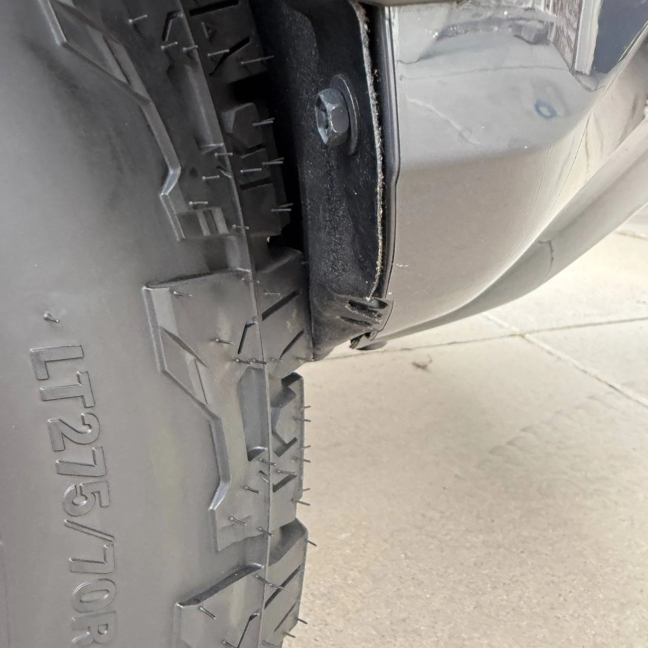

Try this for your mud flaps. Wider and flatter. Specially for the front tires if they rub. The ones on my TRD had a small bump of plastic that was hitting my tire 285/70/18
2025 4runner 6th gen Bronze Method 320 18x9 (6x5.5) +18 offset w/ Falken Wildpeak A/T4W 275/65/18 installed on my Underground 2025 SR5. No lift. IMG_5283
2025 4runner 6th gen Bronze Method 320 18x9 (6x5.5) +18 offset w/ Falken Wildpeak A/T4W 275/65/18 installed on my Underground 2025 SR5. No lift. IMG_5282
