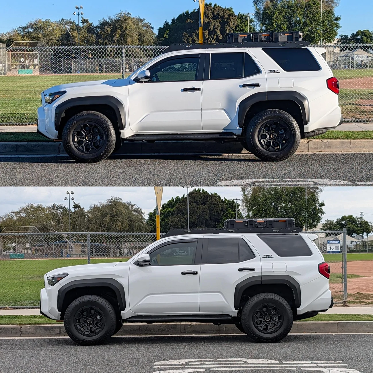

I got my 5100s installed yesterday. The front circlips were placed in the #4 position, which should give a ~1.6" lift according to Bilstein. It looks pretty much level to me. I really love how much more of prominent stance it gives the 4R. The ride so far feels better than the OEM red Bilsteins (Off Road trim). Some bumps feel the same. Some bumps feel much less jarring. Looking forward to taking it off pavement for a better assessment.
Before and after

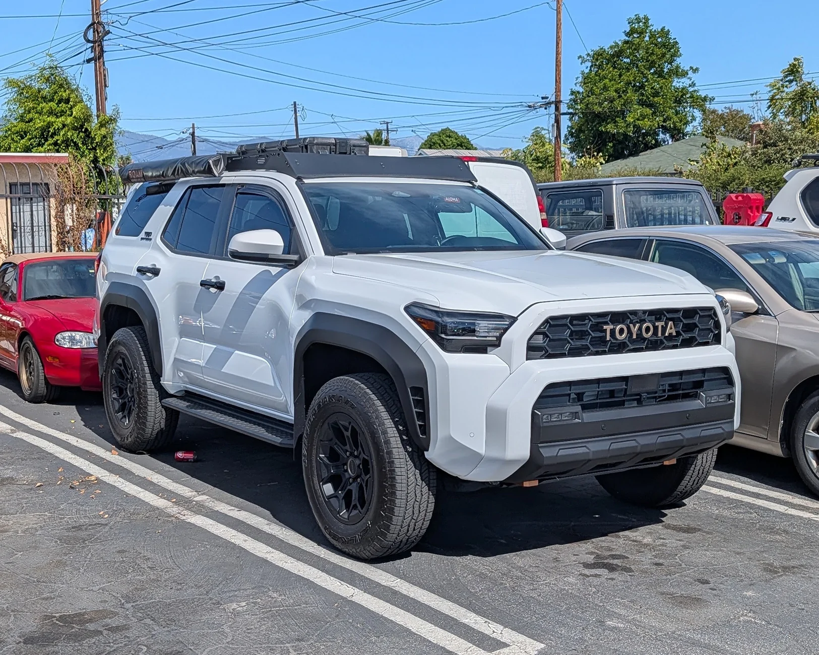

2025 2026 4runner 6th gen Post your Bilstein 5100 / 6100 pics, reviews, alignment specs, etc. signal-2026-10-21-12-33-38-910
After
2025 2026 4runner 6th gen Post your Bilstein 5100 / 6100 pics, reviews, alignment specs, etc. PXL_20261016_200616595~2(1)

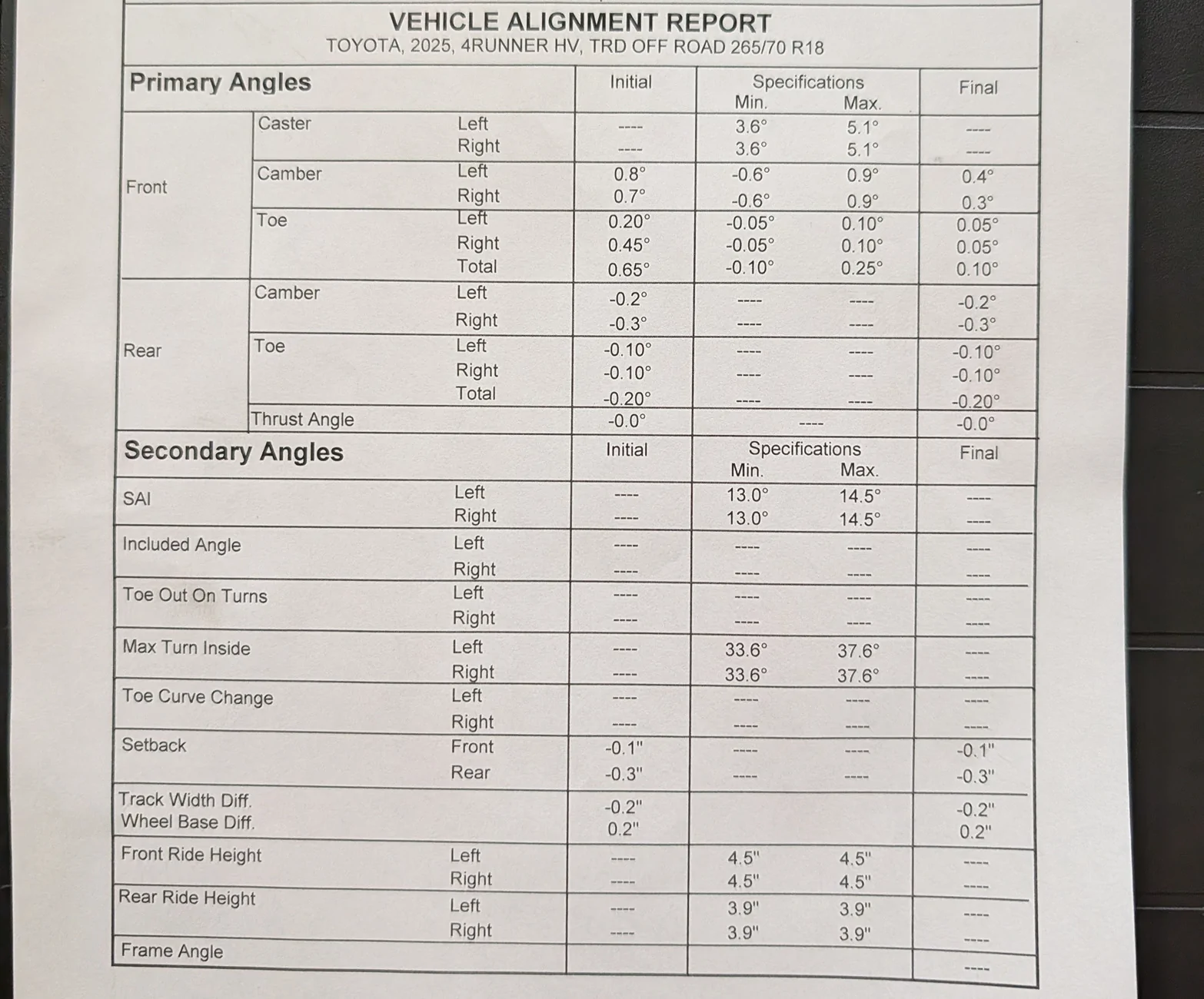

Alignment specs
2025 2026 4runner 6th gen Post your Bilstein 5100 / 6100 pics, reviews, alignment specs, etc. PXL_20261017_204852829
Shoot me any questions you have. Looking forward to seeing more from others!

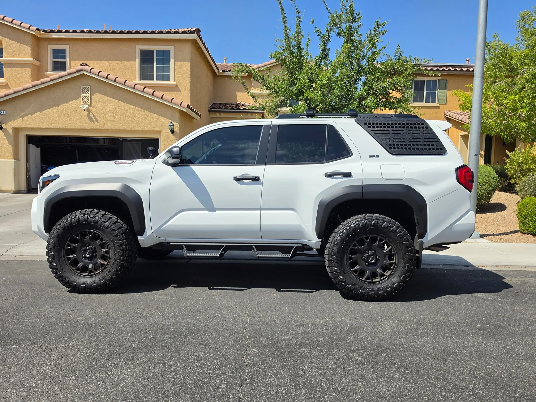

Never saved the print out on the alignment highest clip with 2" OME rear springs.
2025 2026 4runner 6th gen Post your Bilstein 5100 / 6100 pics, reviews, alignment specs, etc. 20260716_102349

Before
After
Alignment specs
I only saw your first pic above the fold and I was like, that ain’t level. Then I scrolled down and saw the after pic and I was like, oh yes very nice and level. 😂
