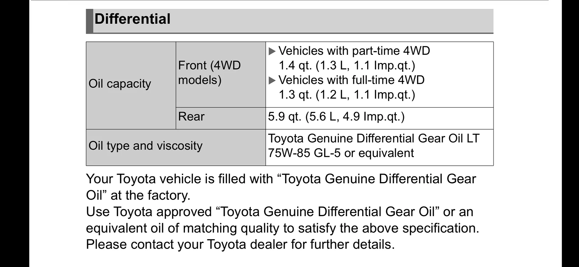

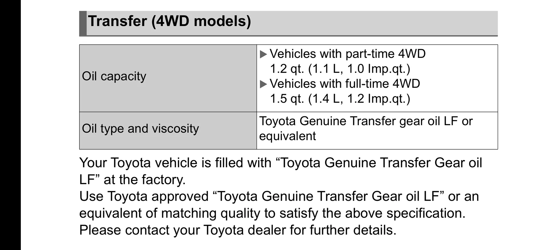

Specs (owner's manual)
2025 2026 4runner 6th gen 2025+ 4Runner Diff & Transfer Case Fluid Guide: Part Numbers, Torque Specs & Prices IMG_1471
2025 2026 4runner 6th gen 2025+ 4Runner Diff & Transfer Case Fluid Guide: Part Numbers, Torque Specs & Prices IMG_1470
ComponentFluidCapacity
Front diffToyota Differential Gear Oil LT 75W-85 GL-5 (or equivalent)1.4 qt part-time 4WD / 1.3 qt full-time
Rear diffToyota Differential Gear Oil LT 75W-85 GL-5 (or equivalent)5.9 qt
Transfer caseToyota Transfer Gear Oil LF (or equivalent)1.2 qt part-time 4WD / 1.5 qt full-time
Buy: 8 qt diff oil and 2 bottles of transfer case fluid. (Some guides say 6 qt for the diffs, that's the Tacoma number.)
