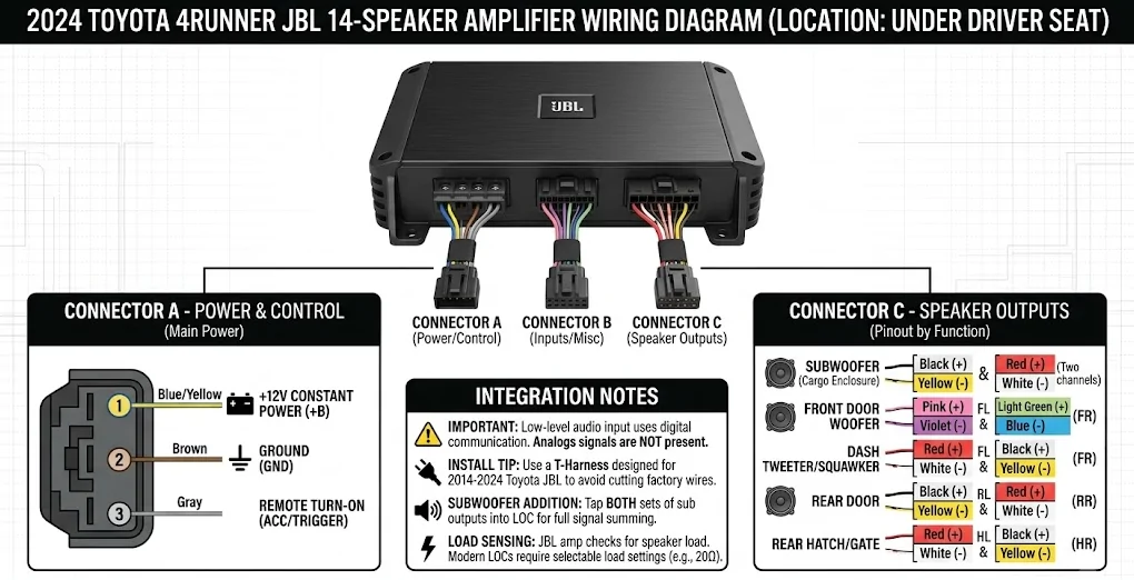

Still need a harness to T off the factory amp to send signal to the speakers, optional SOS fix, and voice\chimes. Lots of that is generated from the factory amp not the head unit. Something to keep in mind just the PAC device does not tick all the boxes. You would then have to mix those extra channels back in with a DSP. Also the fading and equalizer from the head units are usually done on the factory amp so those features would need to be tapped into as well. I think this head unit only puts out two full range channels that the PAC amp would see.
Check this video out from Pac/Stinger, he talks about the integration & t-harness. He mentions the stock chimes etc at around 5mins 30 secs :

Yes, you can either add more amps, or DSP with amps. If you just use amps you'd need to filter the signal to each speaker with a x-over (using either built in x-overs in the amp, standalone passive or active, or DSP).
My intention is to do the front stage and sub with optical out to a DSP, then I can do filtering, EQ, time correction and more amplification individually to each speaker. I will leave the rest of the speakers (center, rear doors & tailgate speakers) to run off the stock amp and turn those down in volume relative to the front stage.
