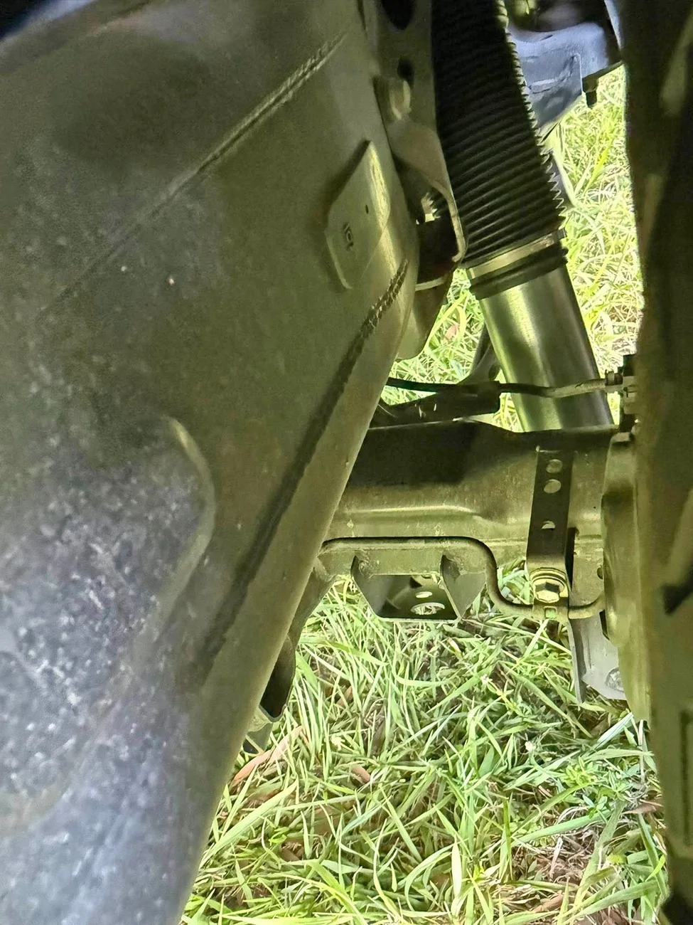

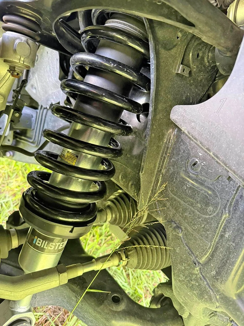

Finally found a set of Bilstein 6112 for the front and 6110 for the rear over at SoHi Performance. Having run a similar setup on my old 5th Gen, I’ve been searching "moding" sites like a kid at Christmas waiting for these to finally drop for the 6th Gen.
The install was actually pretty straightforward—mostly because I’ve spent enough time under 4Runners to do this in my sleep. The front is definitely easier than the 5th Gen. Disconnected the steering arm, pulled the factory shock, and did the "compress and swap" routine for the top hat.
I did have to get a little "creative" with the re-installation, though. If you ever find yourself lacking leverage, turns out a jack from a Toyota Corolla (don't tell my wife) fits perfectly between the frame and the lower arm to give you that extra clearance you need.
The rear, however, was a different story. I attempted to install a 1.5-inch puck on the coils, and after about an hour of sweating, swearing at inanimate objects, and questioning my life choices, the puck won. I gave up.
Right now, she’s sitting at a clean 38 inches all around. Based on my previous experience, those front coils should settle about 1/4 to 3/8 of an inch lower, which is the exact stance I’m looking for.

I just did the install yesterday, but feel more cushiony on road and less rigid off road, compared with stock. Had the same setup in the 5th gen and really performed well off road on rocky trails, hopefully they’re the same recipe.

Initially I've went with the 4 clip, but when I got in trouble with the rear pucks, then re-did the front on the second clip with no rear lift. That gave me 2 inch of lift(should have been 1.7 according to Bilstein) and I'm expecting to drop another 1/4 or 3/8 after a few days. It did drop 3/8's on my 5th Gen, but I had a winch bumper and winch in the front so that's that.
