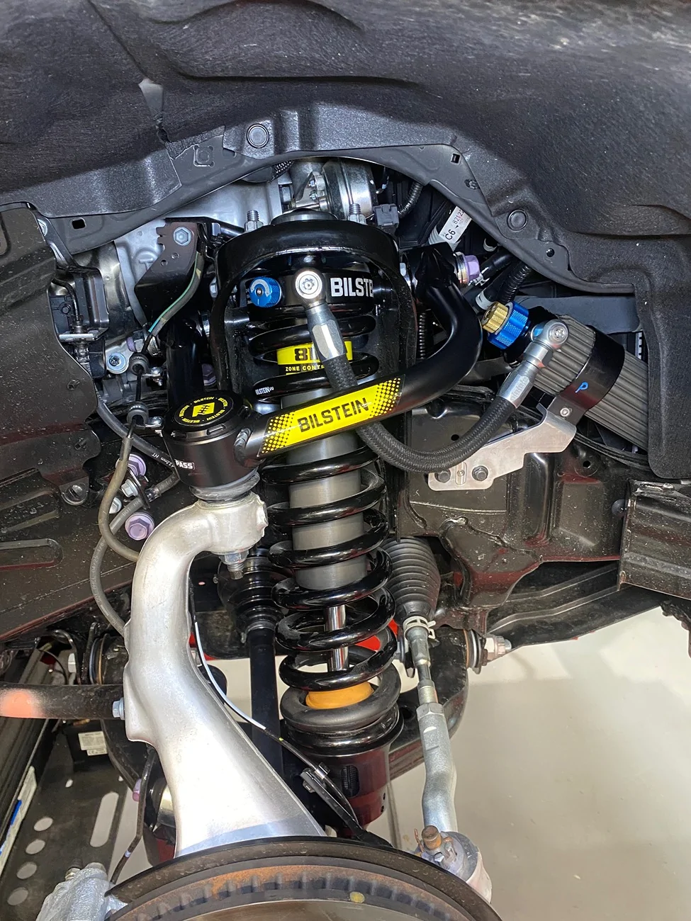

@Furrypanda1121 B8 UCAs fit the gen 6? I’m so down if that’s the case! Where did you get yours!?
Bilstein used my 4runner Hybrid for their fitment and testing back in December. They offered me the 6112/6100 combo with UCAs for letting them use it for 3 weeks. It'll be going in next week for install finally. Not sure if its specifically the B8 UCAs or if it's a different model, I just know that is part of the deal I set up with them. The photo they sent me had the 8112 kit installed with Bilstein UCAs so I know they have something that fits, not sure when it'll be available for purchase.
Oh yes, I've seen this build in another thread, didn't connect the dots that was your Runner!
First off, Bilstein set up your Runner Sick!
Second please keep us posted if you find any information about their UCA offering, that UCA would be the ones I'm interested in getting.

Will keep you posted. Pickup date is now set for tomorrow and I'll have it back in another 2 weeks. Also got a little tidbit from them today. They will be testing out heavy load springs paired with the 8112s while they have it this time. No release timeline for the springs though.
Once its back Ill post some photos.
