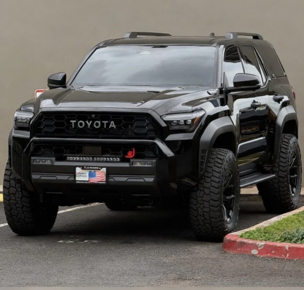

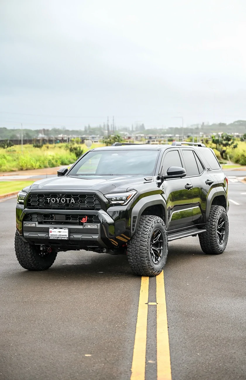

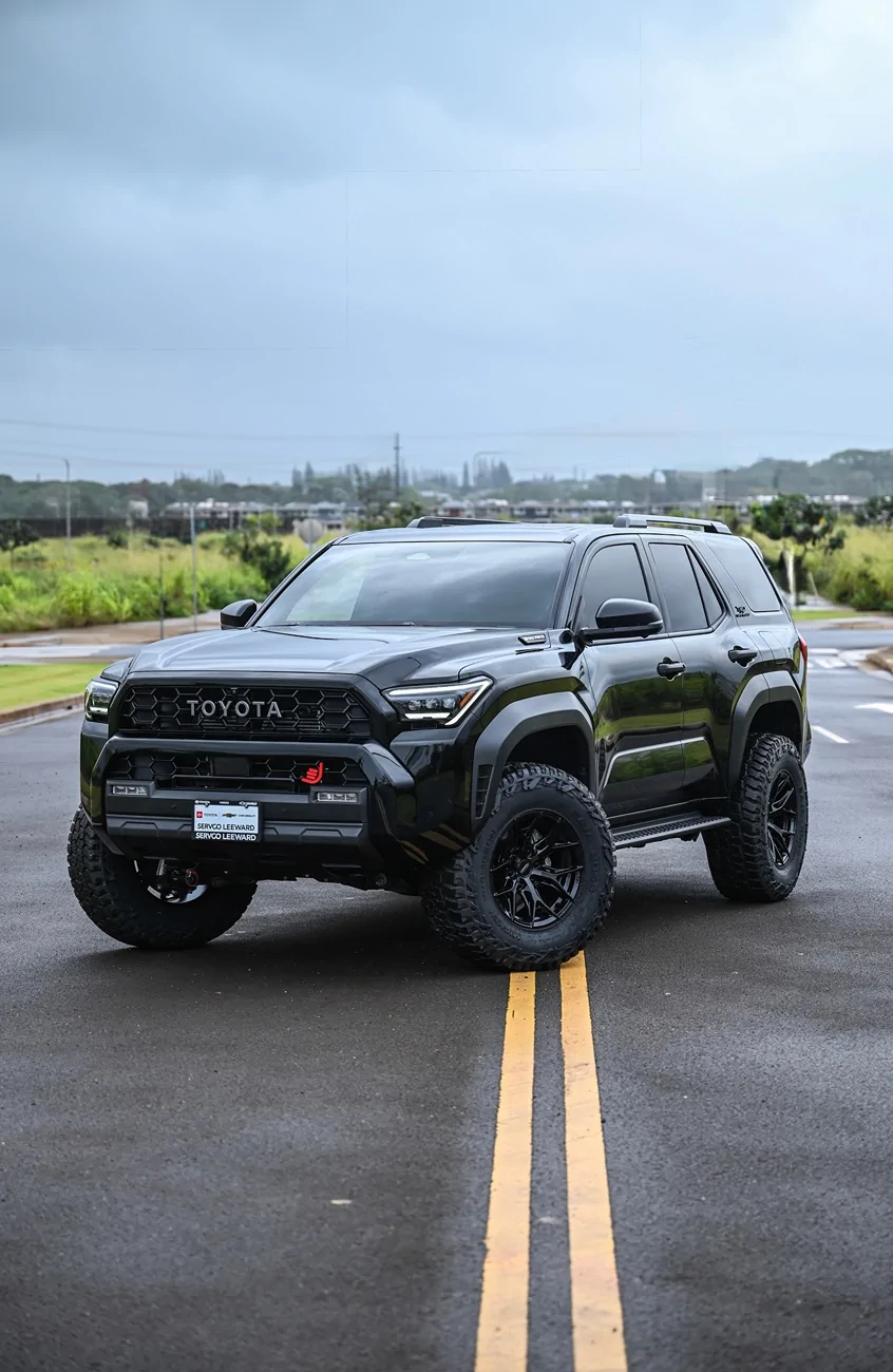

I like the aggressive look. I’m running 295/70/17 Mickey Thompson AT tires with 17 in Vossens zero offset.
