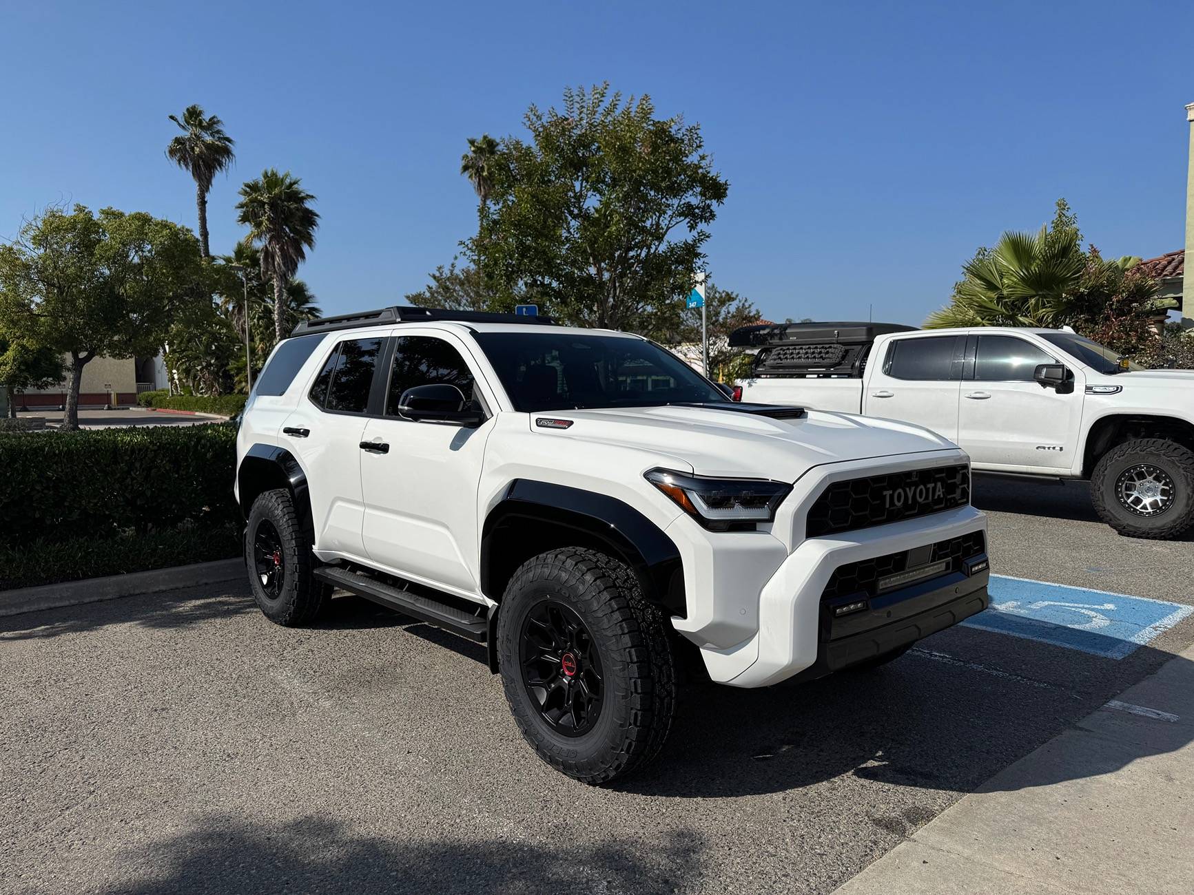

Hey guys, I got the Toyo open country AT3 285-70-18 and instantly regretted not getting RT trails after my bro in law rolled up in his new Land Cruiser with them. I can exchange my current tires but they only come in 285-75-18. Will this fit on my pro without rubbing? Thanks!

I mounted 295/70/18s without my lift yet and they rub on the rear crash plate at full lock. I removed the crash plate and no more rubbing. I'm also getting it lifted shortly too so I won't have any issues. a 75 will rub for sure, but you can stuff them, remove the crash plate, lift it and it should be fine.

I'm running WildPeak RTo1 285/70/18, 34x11.7 no rub so far, even offroading.
