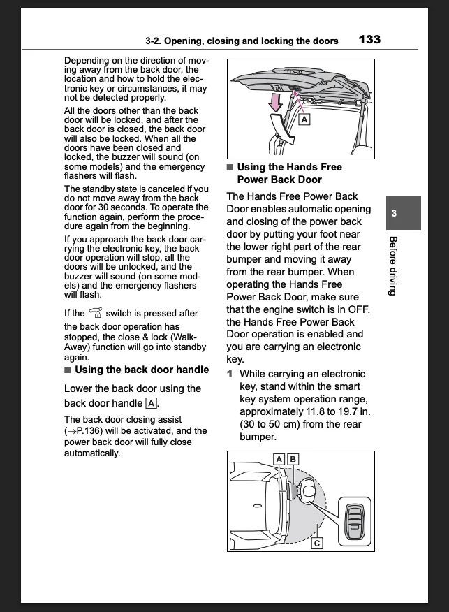

It will only close and lock if it can sense that the key is both not in the vehicle and not too far away from the vehicle. I found there is a sweet spot you have to have the key for the lock button on the tailgate to actually work.
This is what I have found too, if I'm off to the side or have the fob in my pocket on the opposite side of my body at full arm's length it's far enough where it wont detect it. I've just started to make sure I'm standing close to the bumper and works better.
Edit:
Was curious what the manual says, apparently the range is 11.8-19.7 in from the bumper
2025 4runner 6th gen Why doesn't the rear hatch close and lock button work all the time? 1760726736228-un

I've had it work but it is inconsistent.
You need to walk away (per the manual) but I can't yet figure out exactly the pace or distance after hitting the button.
I like the feature but its more reliable (and thus saves time for the random not working) to just hit the close button and tap the front door handle on the way by. So that is what I tend to do.
I find the kick open/close feature to be similarly unreliable - but a great help when hands are full so I keep swinging my leg until it works.:rolleyes:
