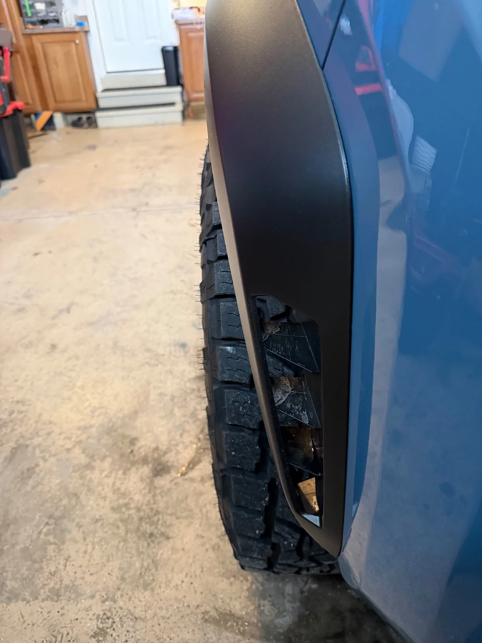

I have zero issues using spacers - in fact my wife's older Jeep (TJ) has had spacers on it for the past 15 years with no ill effects. The biggest issue with them is having to deal with 2x the lug nuts when doing a brake job!
But I'm coming in here as a different sort of devil's advocate. There have been a ton of folks on here complaining about the paint on these new 6th Gens. I'm not sure if it is a brittle paint issue or a thin paint issue - but it seems like there are a lot more chips on these than older generations. Do you think the spacers will increase the issue once the tires are kicking stuff past the flaps? I'm not asking rhetorically either....genuinely curious. I have looked at spacers for ours too as I like the wider stance and it is cheaper than a new set of tires.
Let me know your thoughts on this perspective.
