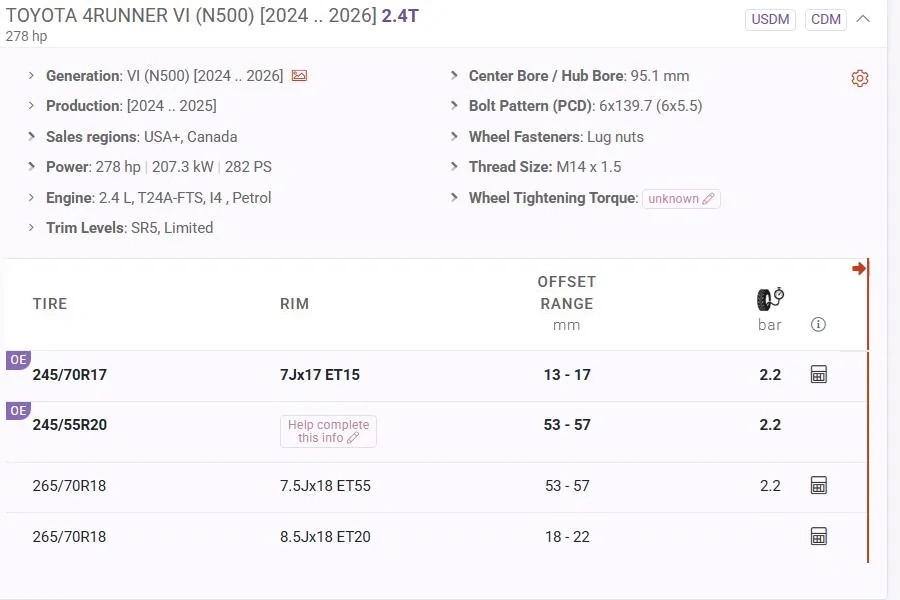

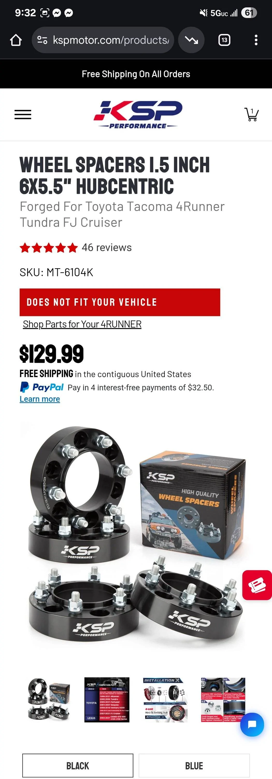

Can anyone confirm fitment of the KSP 1.5" hubcentric wheels spacers? Their website currently does not show them as fitting, but unsure if that's just due to them not having a confirmed fitment test done.

i mean you can try since the hub size is 106 on a 5th gen vs a 95 on the 6th gen. you can fit larger to smaller (but you cant smaller to larger) but meh, that would be your call and your liability.
luckily the bolt pattern is the same between the 5th gen vs 6th gen
70
2,950
1,640
the only issue i also see is that the lugs are 14.x1.5 on the 6th gen vs 5th gen 12x1.5
70
2,950
1,640
but then again this is all in the sticky thread already in this sub forum, so your question was already answered before you started the thread.

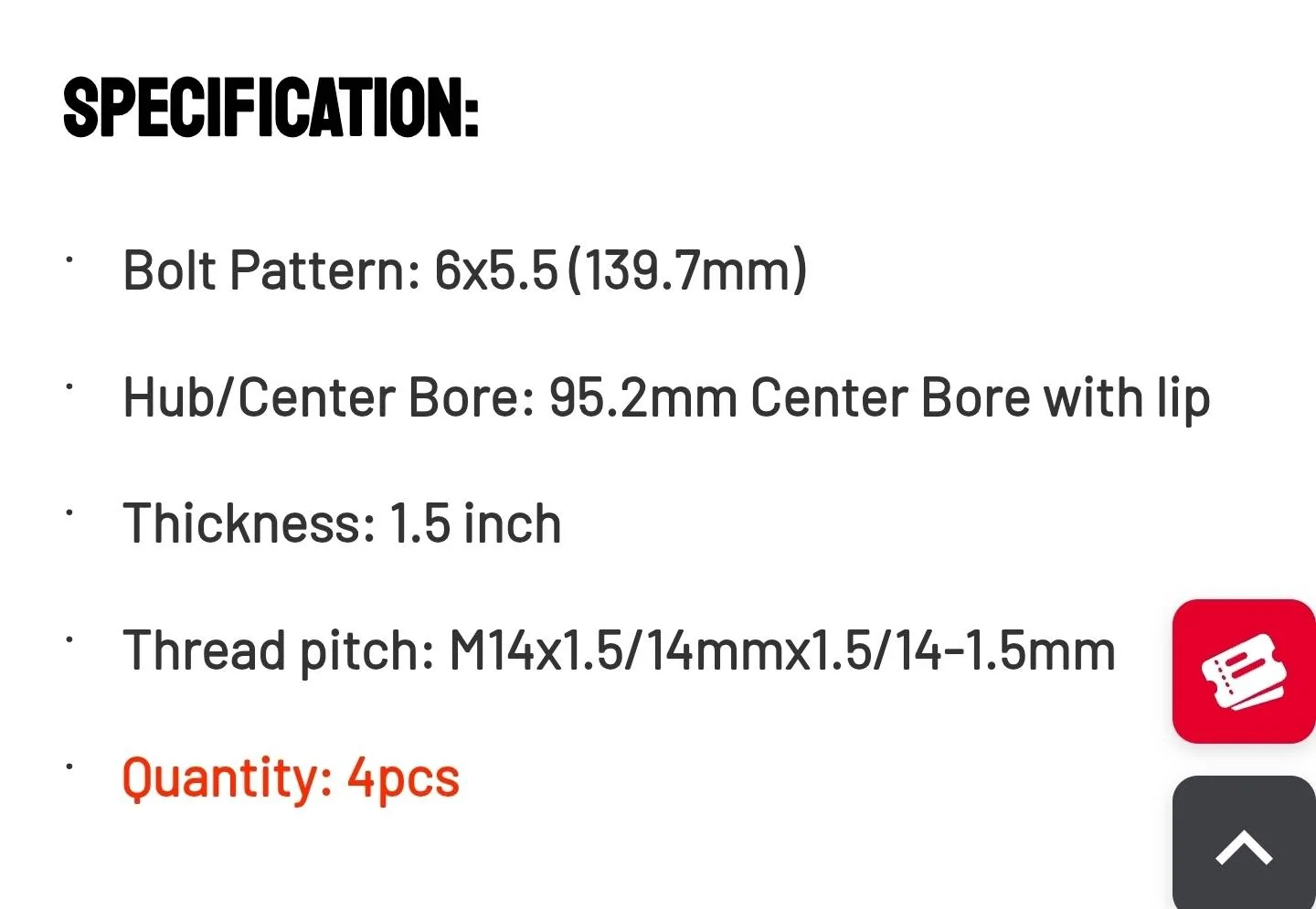

Just had a dumb realization. The spacers for the Tacoma are the correct specs, considering the hubs are the same. And yes, I neglected to check the sticky. Didn't occur to me to do so.

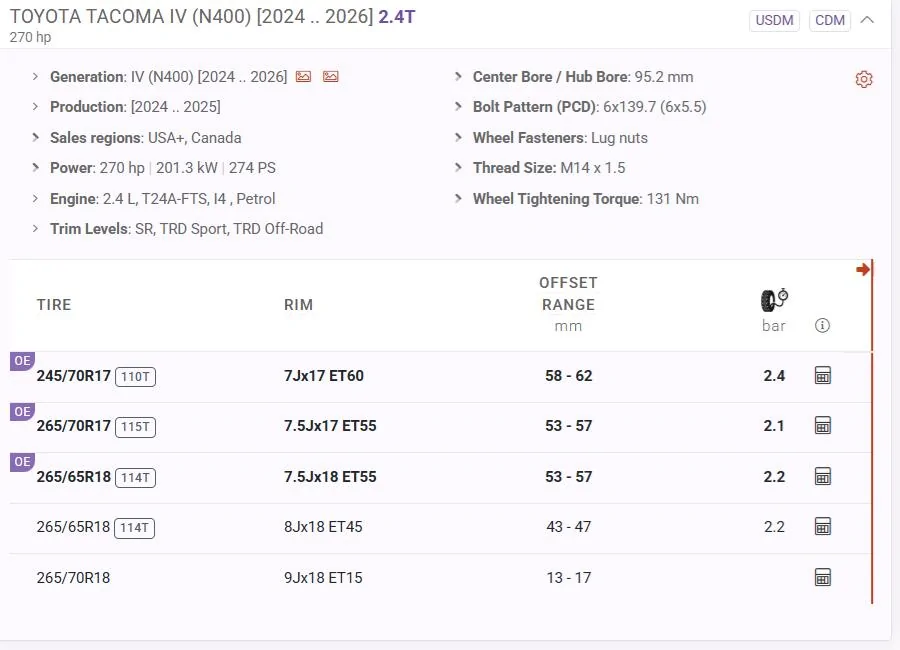

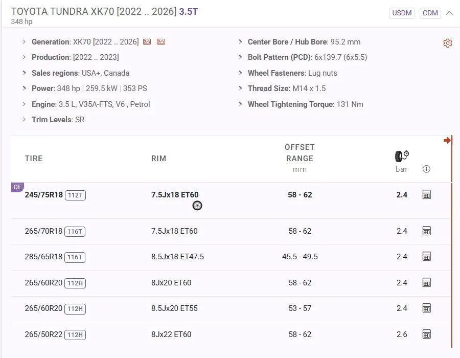

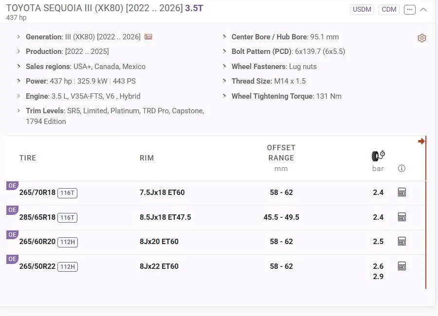

the good side effect, the wheels from the new gen 22+ sequoia, 24+ tacoma, 22+ tundra fit the 25+ 4runner also.
and they all have the same torque specs. you just have to watch the offset.
most of the wheels across all 4 BoF are roughly 52-57 for the 20s, but you get reall small offsets on the 17/18's
