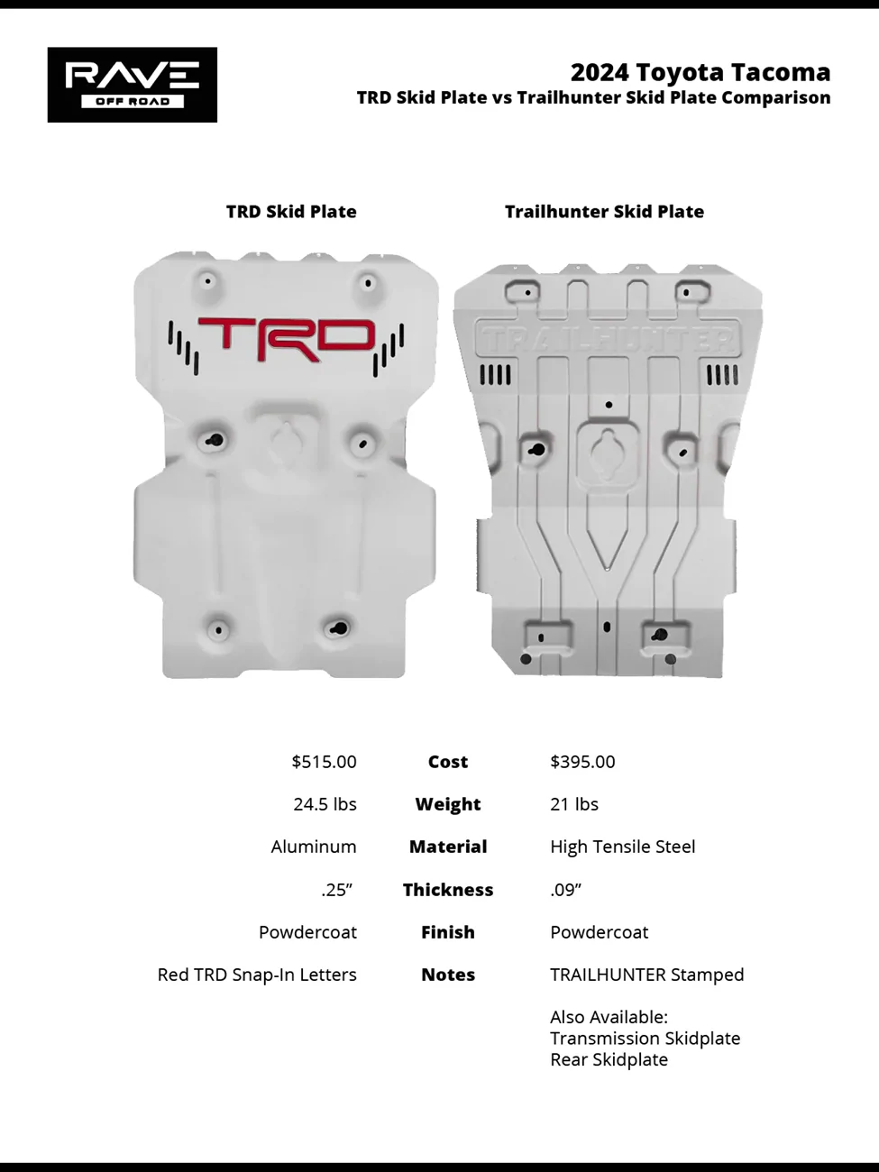

Curious if anyone knows the weight of the TRD Pro AL vs the steel Trailhunter front skid plates. My dealer hasn't been able to find out.
i ordered the front trail hunter skid for my limited… they only have one of the protection pieces underneath the limited
weight on the box was 24 lbs.. so its 24 lbs or lighter… i think i saw it’s actually closer to 21 lbs… unless im missing something
2025 4runner 6th gen Weight of front skid plates (TRD Pro aluminum vs. Trailhunter steel)? IMG_3315
