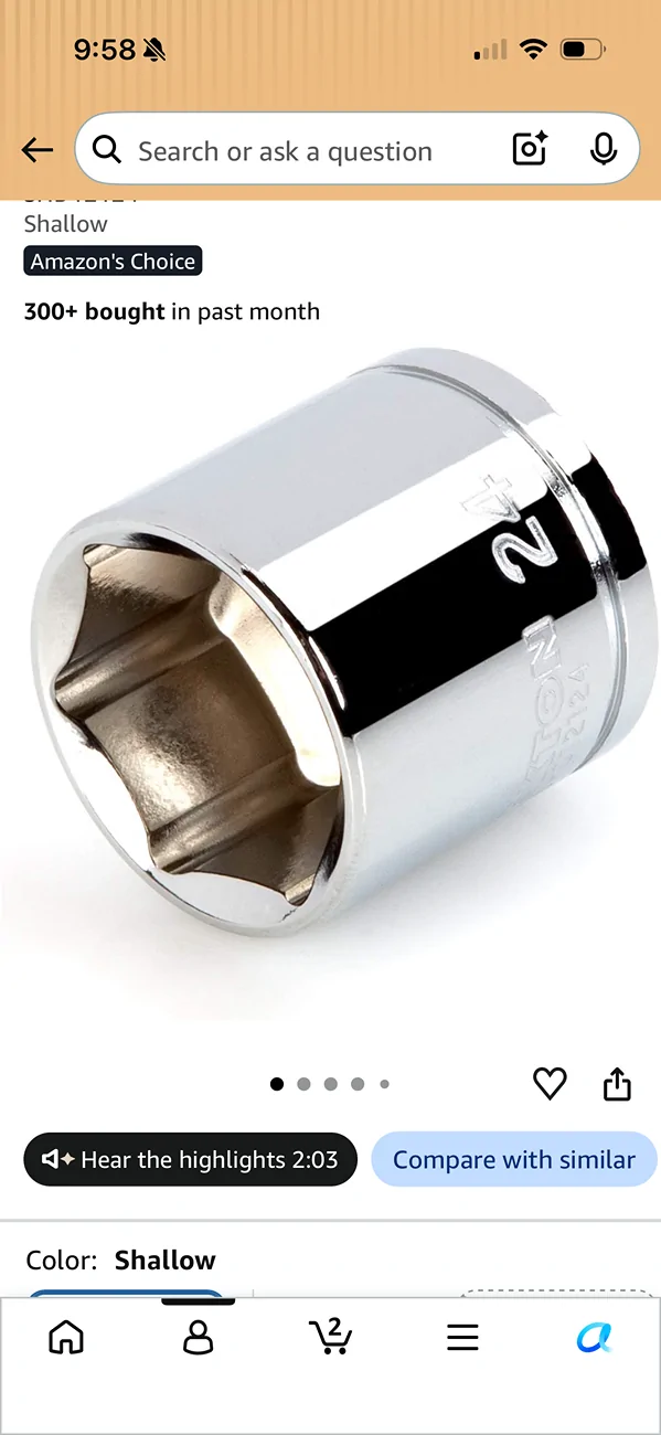

Sounds like a plan! I just changed all fluids in the 20k-21k range. It’s a 24mm socket for the diff, and I recommend getting the short ones, hex. You will want to replace the crush washer as well.
