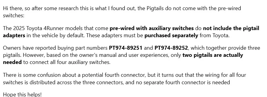

TRD ORP Max here and I have been causing a stink with the sales rep I worked with, apparently their parts dept filed a warranty claim to get replacement pigtails (i guess the proper process for parts that are missing/broken upon delivery) and received this email as a response from his parts dept manager:

I also have noticed that most of the people on here saying the wires were included happen to have a TH or PRO, so it makes me wonder if the factory included them in those top tier trims, but maybe the add-on feature was installed port-side or something and ToyotaUS didn’t include them. Who knows.
I was an inch away from convincing the sales guy when I took delivery he was “going to go grab them” but they didn’t have any in stock, nor any other 4Runners on the lot with the Aux package, otherwise I think he would’ve just handed them over.
Super frustrated either way because it’s an accessory we paid for that can’t be used as delivered, they should just come with the thing we bought. I’m still trying to convince him to comp. me the wires after buying this expensive of a car so we’ll see what he says. End of the day at least I got the parts #s but NOT COOL TOYOTA.
