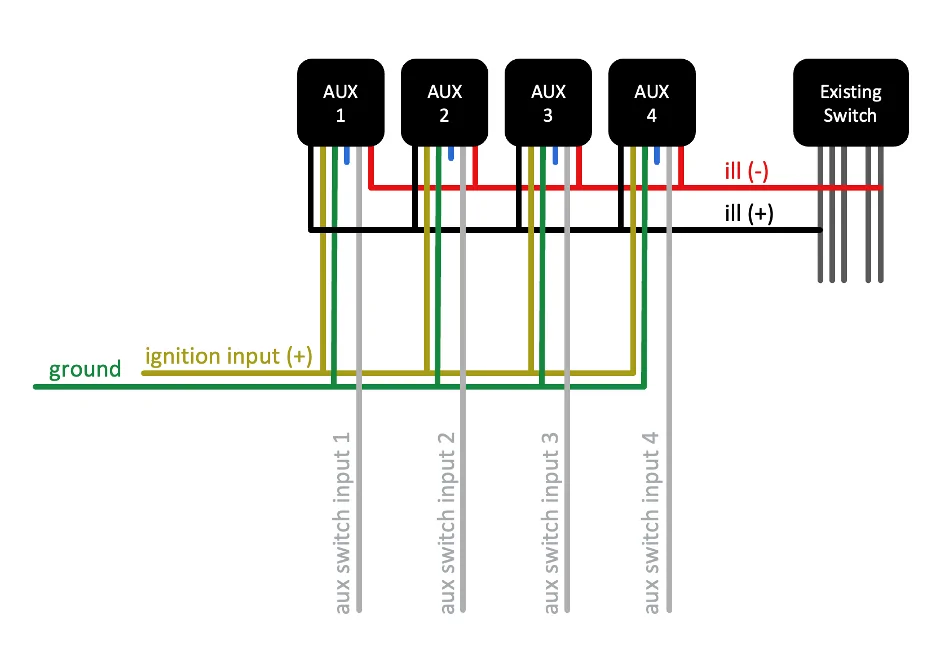

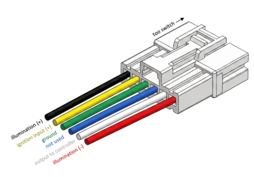

Here's how the connectors get wired and what mine looked like once I had the connectors assembled. You can/should just skip the blue wire, I was doing it before I had the vehicle apart to know which I needed.
2025 2026 4runner 6th gen Add OEM AUX switches (and supporting components) to Limited model? 1783560891674-nz
2025 2026 4runner 6th gen Add OEM AUX switches (and supporting components) to Limited model? 1783560954665-8s
Here's a different view of how they get wired:
You can just grab the illumination wires from a nearby switch and just get them from the same wire placements. I ran a fresh ignition source (yellow on mine) and ground (green on mine) direct to the source. You'll end up with four output wires essentially, which is all you need to run out to the relay center. I used a multi-wire for the run to the engine bay but it's not req'd. https://www.amazon.com/dp/B0D5QKXPN9?ref_=ppx_hzsearch_conn_dt_b_fed_asin_title_33&th=1

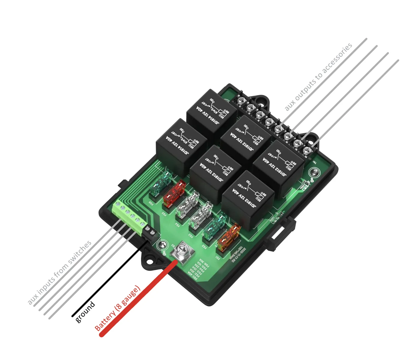

If you use the relay center I linked you're working with this in the engine bay. Super straight forward from here - just wire the primary 12v to the battery (obviously fused or with a breaker), run a ground to the black connections and the four aux input wires into the input side. Now you've got 4 reasonably powered 12v outputs to whatever you want with.
Note: If you want a parking light wire should you run a wire outside from the + illumination wire and feed the 5th input spot. That will give you a solid parking light trigger out of the 5th relay trigger to run backlights or anything else you have.
