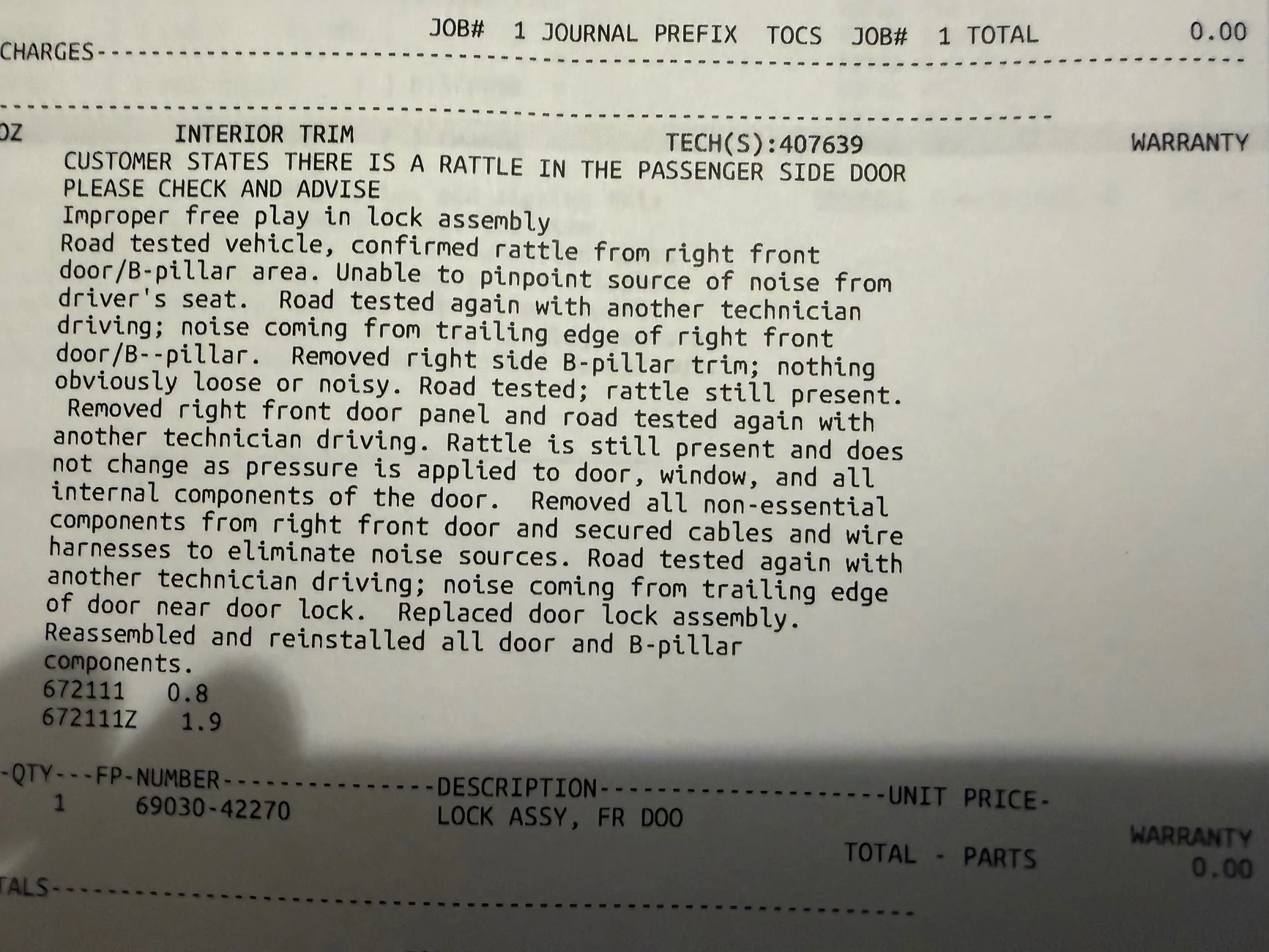

I’ve seen a few posts about door rattle noises when driving. I had this issue in my 26 ORP. I took it in to my dealership and they went through various troubleshooting and ultimately landed on replacing the door lock assembly. See maintenance technician notes below w/ part number.
Noise is gone. Warranty covered the repair.

Wow. A dealer that actually went through the work to troubleshoot. Please tell me you are in the Chicagoland area!

I was quite surprised myself…
I am not in Chicago. This is Charlotte. S/O to Scott Clark Toyota’s service team

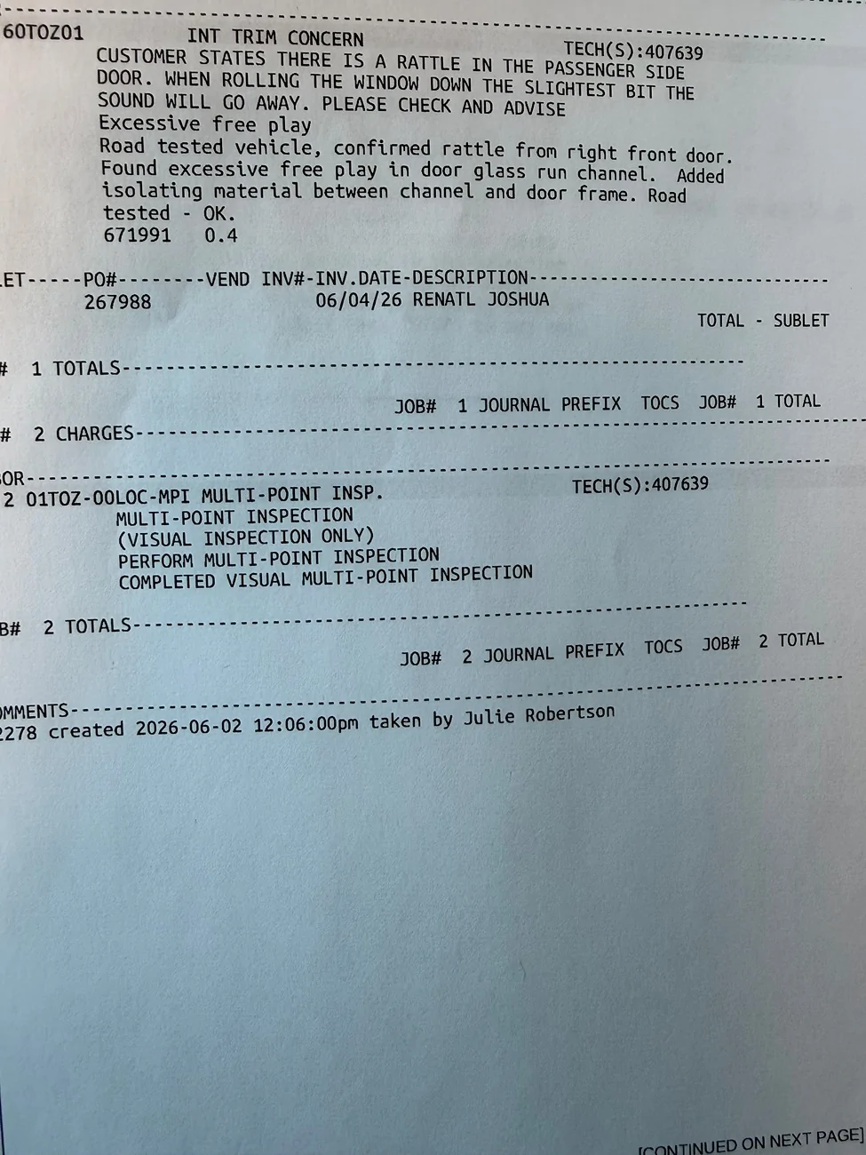

UPDATE: Rattle came back…. So returned to the dealer. I read some other forum posts that it stemmed from the window channel shaking. I advised them to look into that.
They determined it was the free play in the glass run channel and added isolating materials.
Rattle noise is gone… hopefully forever now!
Dealership notes attached

Appreciate you documenting as I think we have the same issue. Are you still feeling it’s resolved? Have an appointment that I’d like to share this info if it was successful for you.

I’m curious did it stop when you reached over and pressed on the door grab handle? Mine rattles but if I reach across the seat and put one finger against that door grip it stops.
