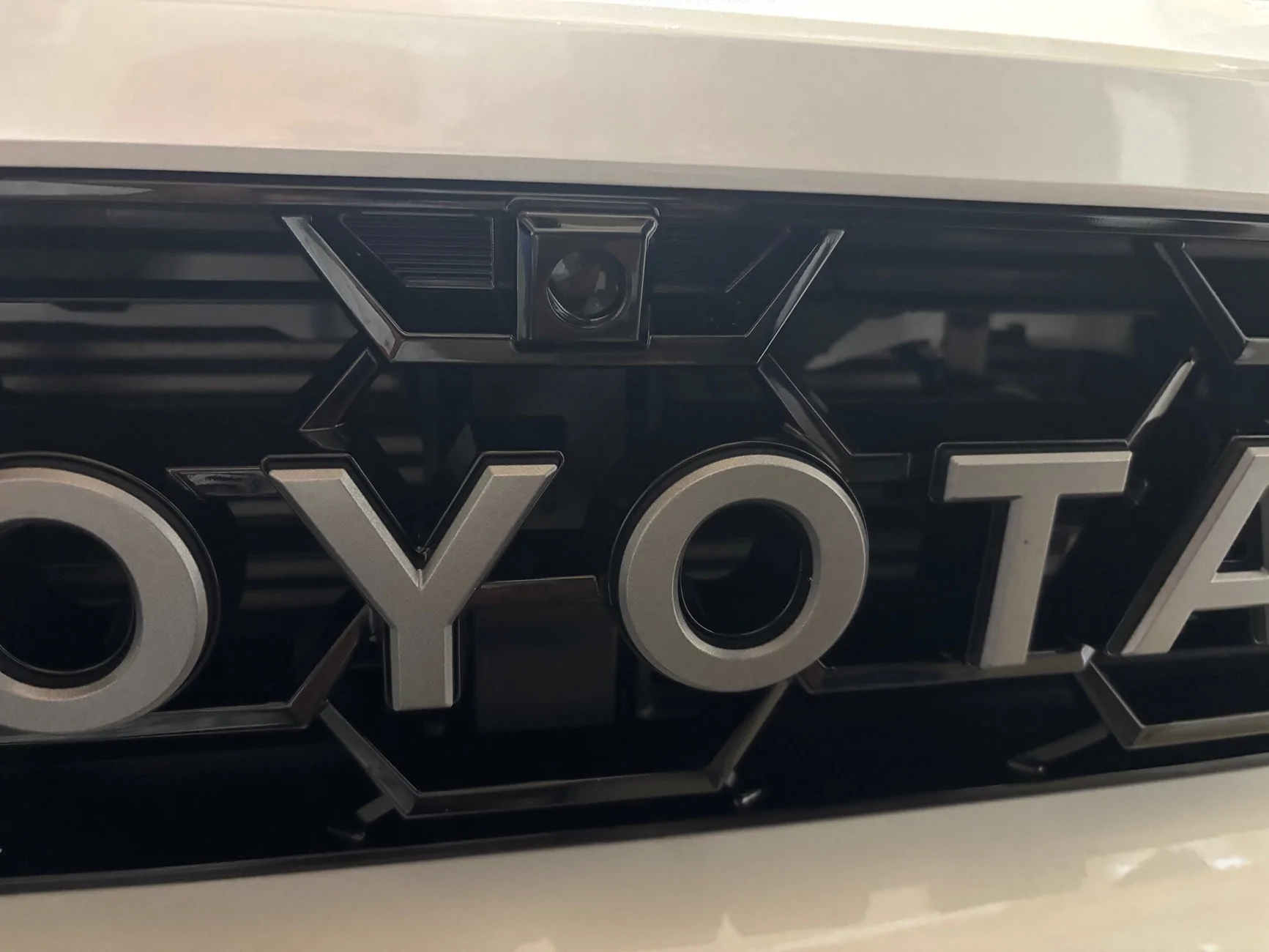

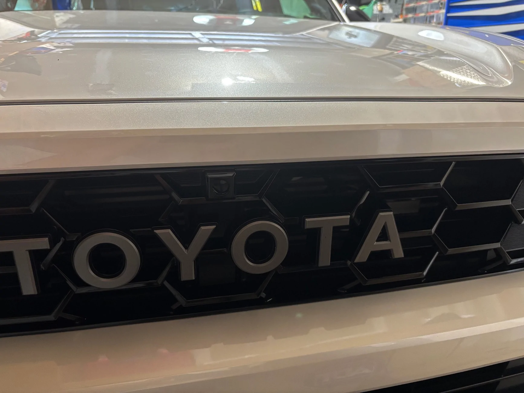

Here is the grill with a MARBLE glue from behind where the camera supposed to go.
Great idea to use a marble, looks good!
I ended up using a plug as pictured here (link to 16mm hole plug in thread): https://www.4runner6g.com/forum/thr...h-gen-4runner-today-👨🏻‍🔧-🧰-🛠.2403/post-116867
