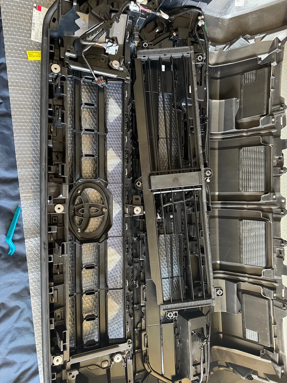

The install is not horrible. A little bit involved, but there a few good tutorials out there. Biggest thing is keeping track of all the screws/pins/clips that you have to remove. I used a bunch of labeled ziploc bags to track everything.
I'm having such a hard time taking the grille off. I've unscrewed just about everything, but I'm not sure what to do next with these pins to get it out and insert the new one. It seems like every video I saw skipped over or just voiced over this step lol

You need to use a flathead screwdriver or something to undo the tabs on the actual grill from the surround. There's a bunch of them and I wasn't super clear either based on the videos I watched

I think this was the video that showed that part the clearest.
Yeah the part I'm having trouble with are the clips on the lower grille - around the 8:30 mark
Can't get those loosened at all
