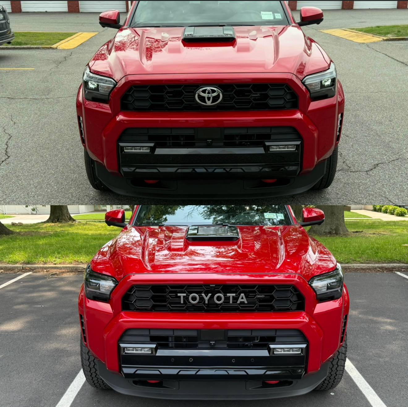

I just went to my local Toyota dealer to order with the part#
Toyota has it listed for $296 , I paid $222

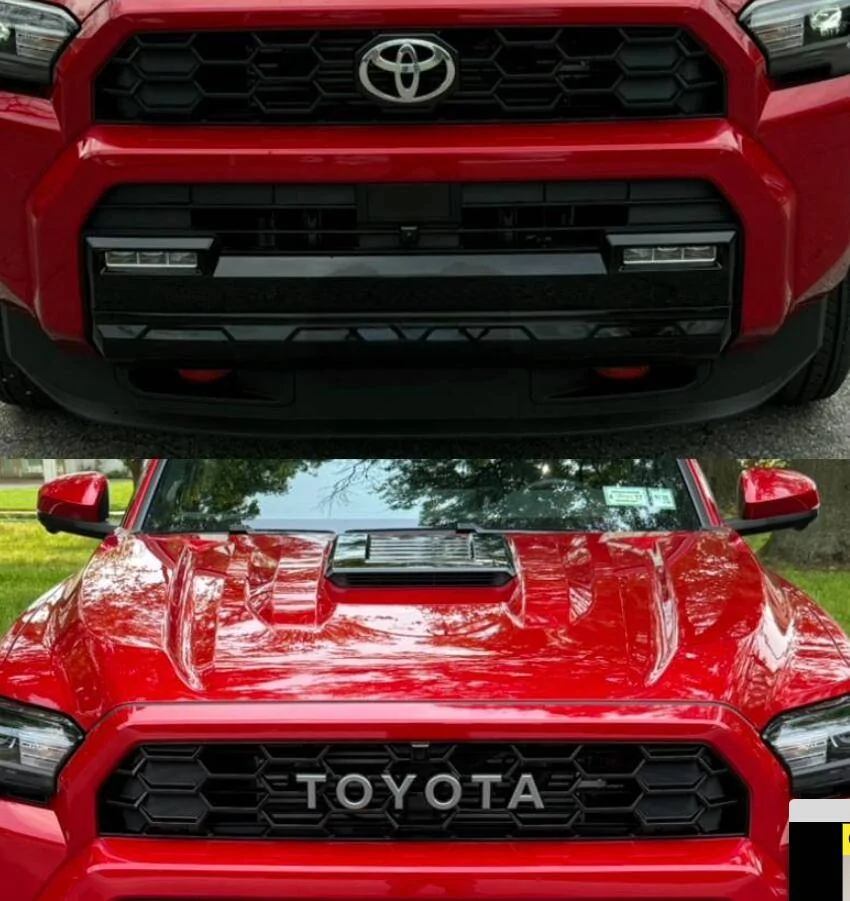

the one I have is TRD pro grille
TRD PRO GRILLE PART NUMBER: 53101-35170
It’s in gloss black with grey letter
TrailHunter GRILLE PART NUMBER: 53101-35160
It’s in matte blwith bronze letters

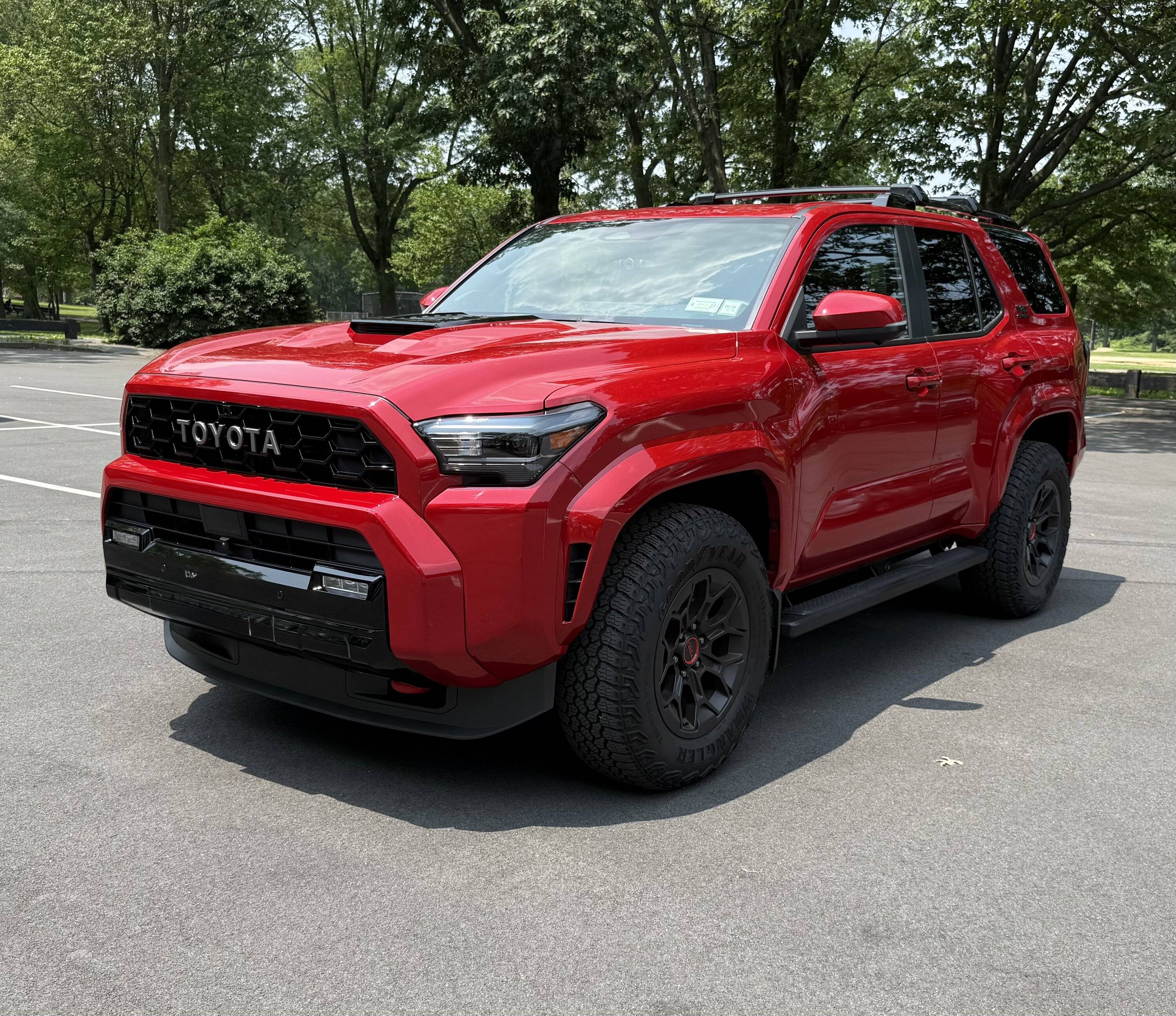

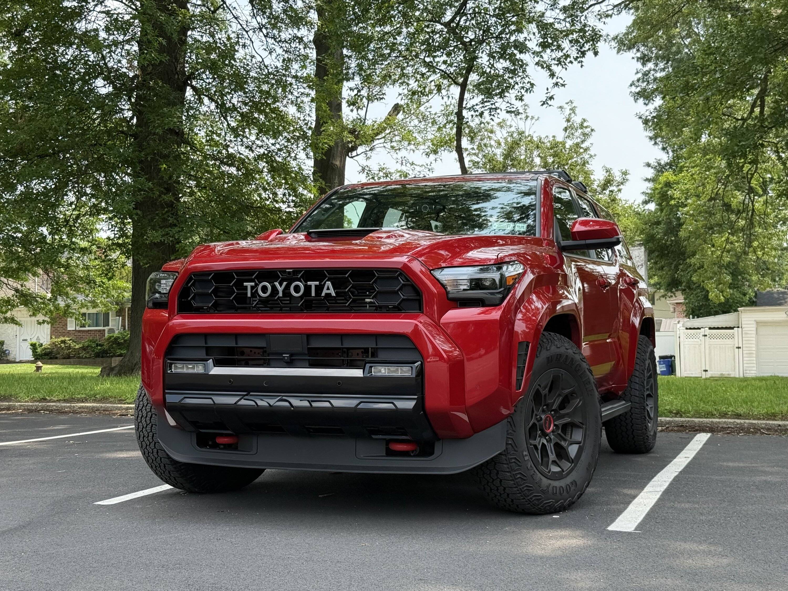

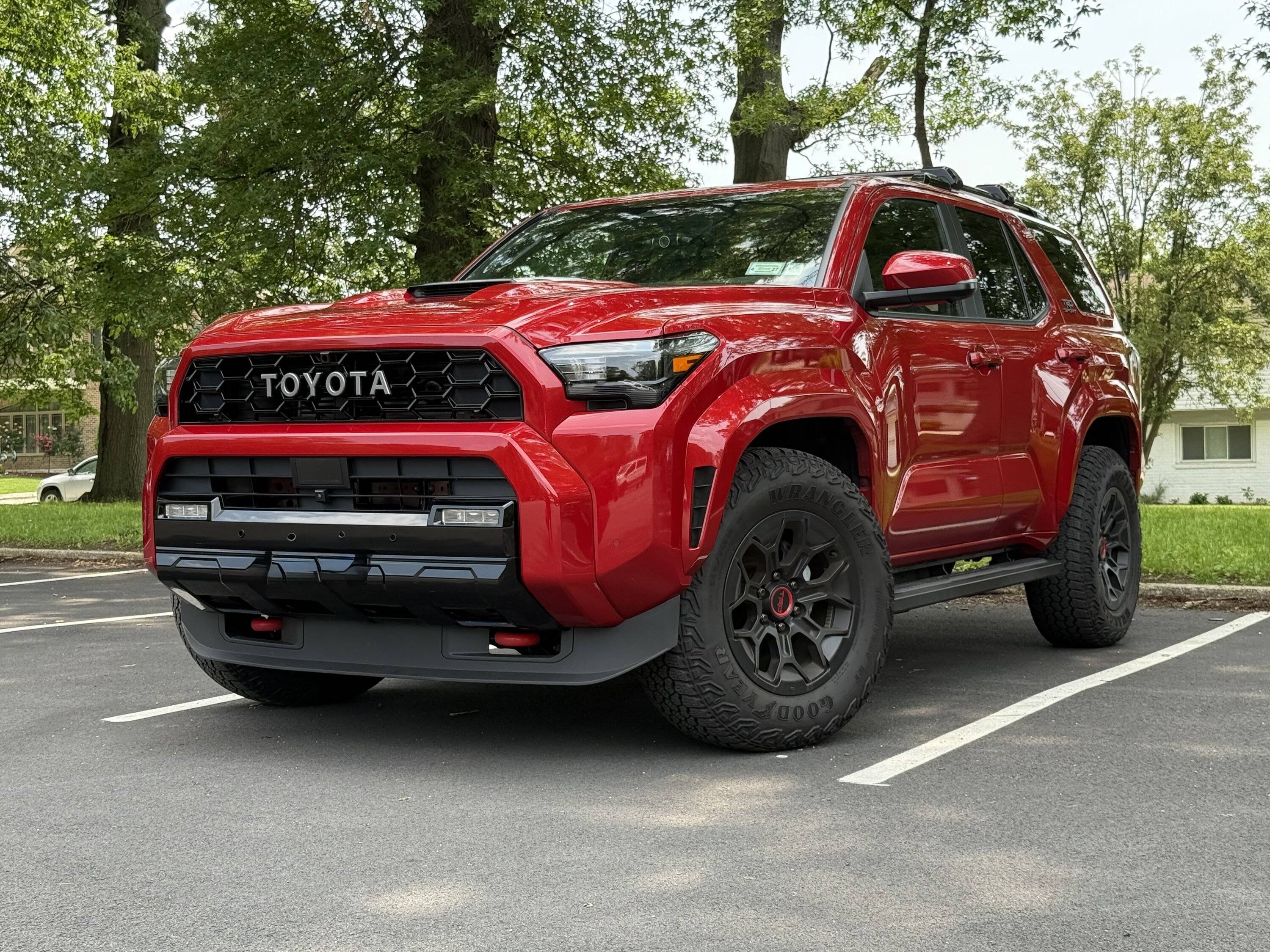

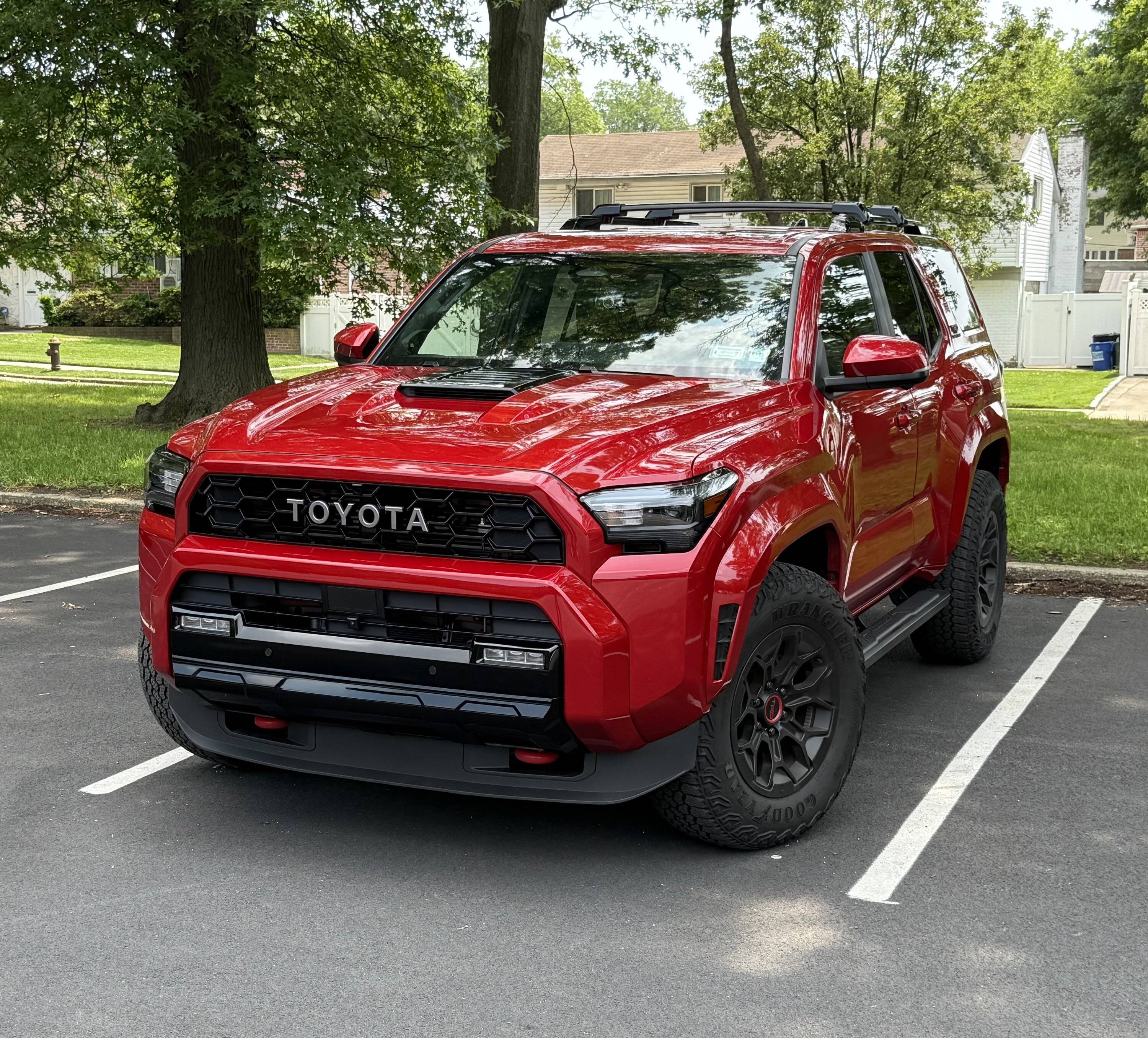

I might be the only one who likes the air dam ?
Looks nice! On the wheels and tires, so you started with a TRD sport, and bought both new tires and wheels I guess. Could you post the part number you ordered for the TRD Pro wheels (and any other related part numbers like center cap, lugs)?
The wheel threads on this forum have conflicting info on the TRD Pro wheel, and the ones you got appear to be matte black whereas the pics posted on this forum have gloss black for the TRD Pro wheels.
Did you do the new tire and wheel mount/balance/swap at a dealership or did you order tires and wheels and have them shipped to Discount Tire or whatever?

Best looking build style I’ve seen so far. The painted fenders and such with those wheels and grill. Perfection.
I like it too ....It looks good on your sporty looking ride. On my lifted orp it didnt look so good so i removed it.
Have you thought about a lowering kit ? it would look sick

Yes. I installed by myself! It took a lot of patient and time consuming. Need to remove the whole bumper , then remove the grille shutter , then the upper grille mustache before you can remove the grille. It takes at least 2hours+
That's a legit job. Would've made a great YouTube instructional video. The truck looks great.

Your mod looks great. Looks very professionally done. Did you do it yourself? How difficult was taking off the old grille and replacing with the new. Any electrical wiring issue to be addressed?

yes. I swap the grille myself. It takes lots of patience and time consuming. Only three electrical connectors need to be unplugged , then you remove the bumper => remove the grille shutter => remove the upper mustache => take lots of time to push out the clips that holding the grille and the bumper.
