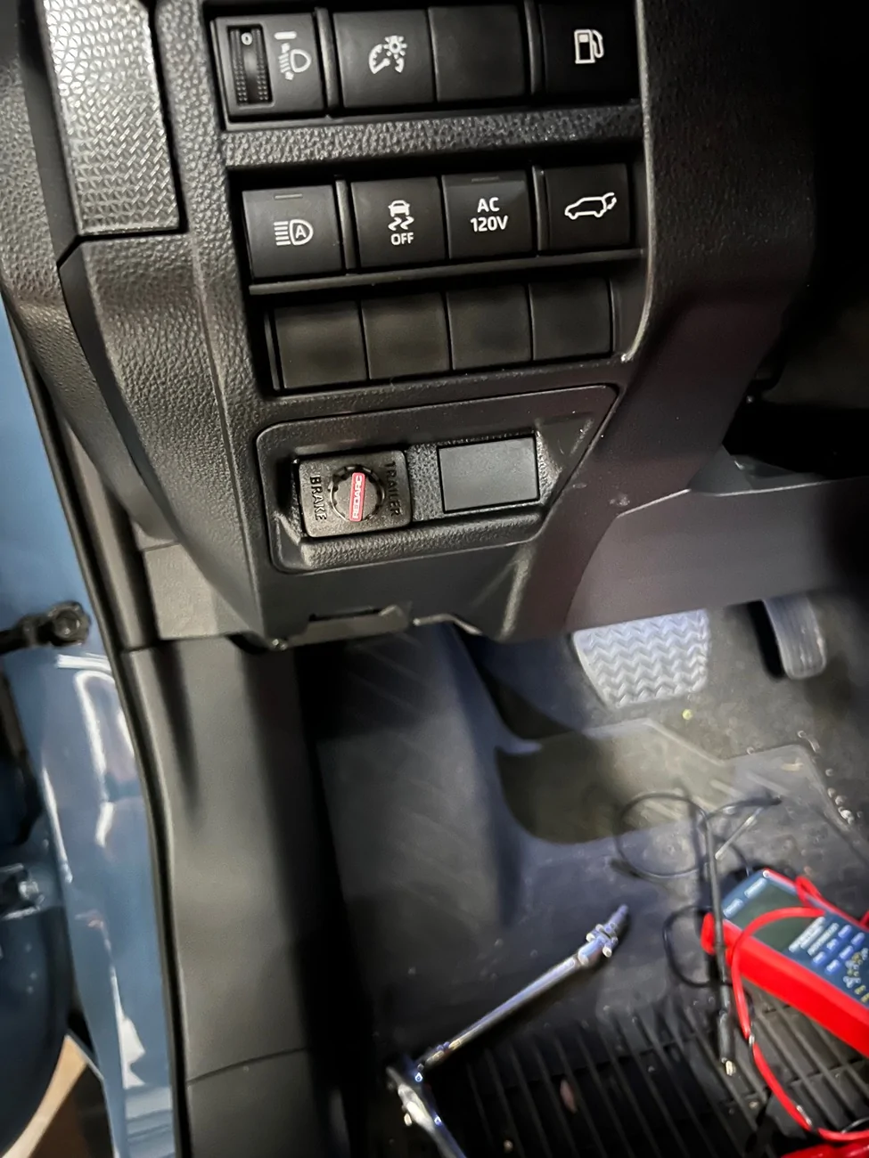

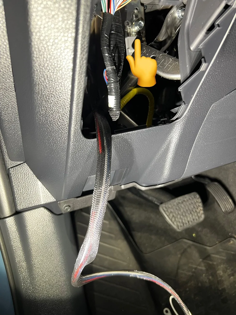

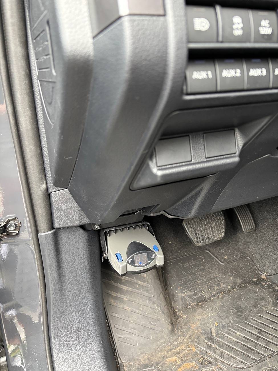

Just installed my Tekonsha P2 Prodigy using my 304100 harness. I was originally gonna mount it higher up, below the Aux buttons (see first pic) but it impeded my knee getting in and out, so mounted it lower. Still easily reachable if a manual adjustment is required and more out of the way.
Pretty straightforward if anyone else is considering a similar setup.
Heading out Sunday on our first camping trip, just finished the miles for the break in period.

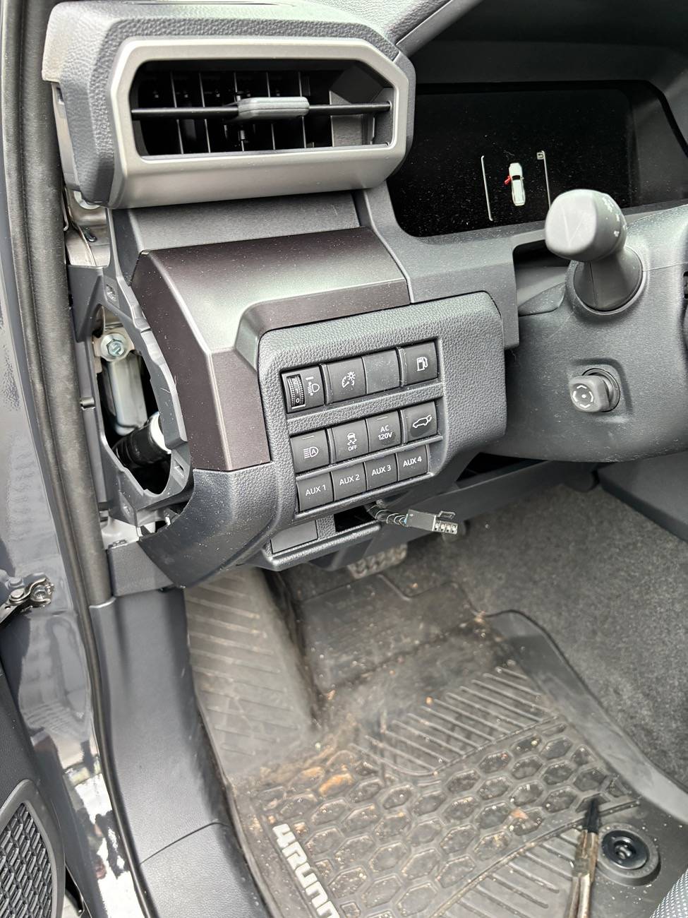

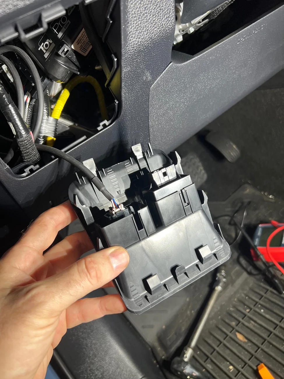

A tip. To get the switch blank out, that I did, I ended up pulling out the top of that part of the dash - need to pull the hard plastic piece off to the top and left as well to do that.
However I don't think that is necessary - having now got the blank out. I think it is possible to get a screwdriver (or two - one for each side) inside the blank and down the sides to the latch and pull them inwards. Here are pictures of the blank, inside and out, and where the latches are.
Just wrapped up installing the Redarc brake controller in my 2025 4Runner. I initially tried the method suggested here, but had no luck — the space behind the side panel is extremely tight. Accessing the switch blank by feel alone was nearly impossible; you can't see anything back there. After 20 minutes of fiddling with small screwdrivers, plastic trim tools, and a lot of patience, I gave up and decided to remove a few extra panels.
That made a huge difference. With better access, I was able to remove the blank cleanly, mount the main unit securely, and route the wiring with a tidy finish. This link was especially helpful in showing how to reach the back of the switch panel — definitely worth checking out if you're tackling the same install.

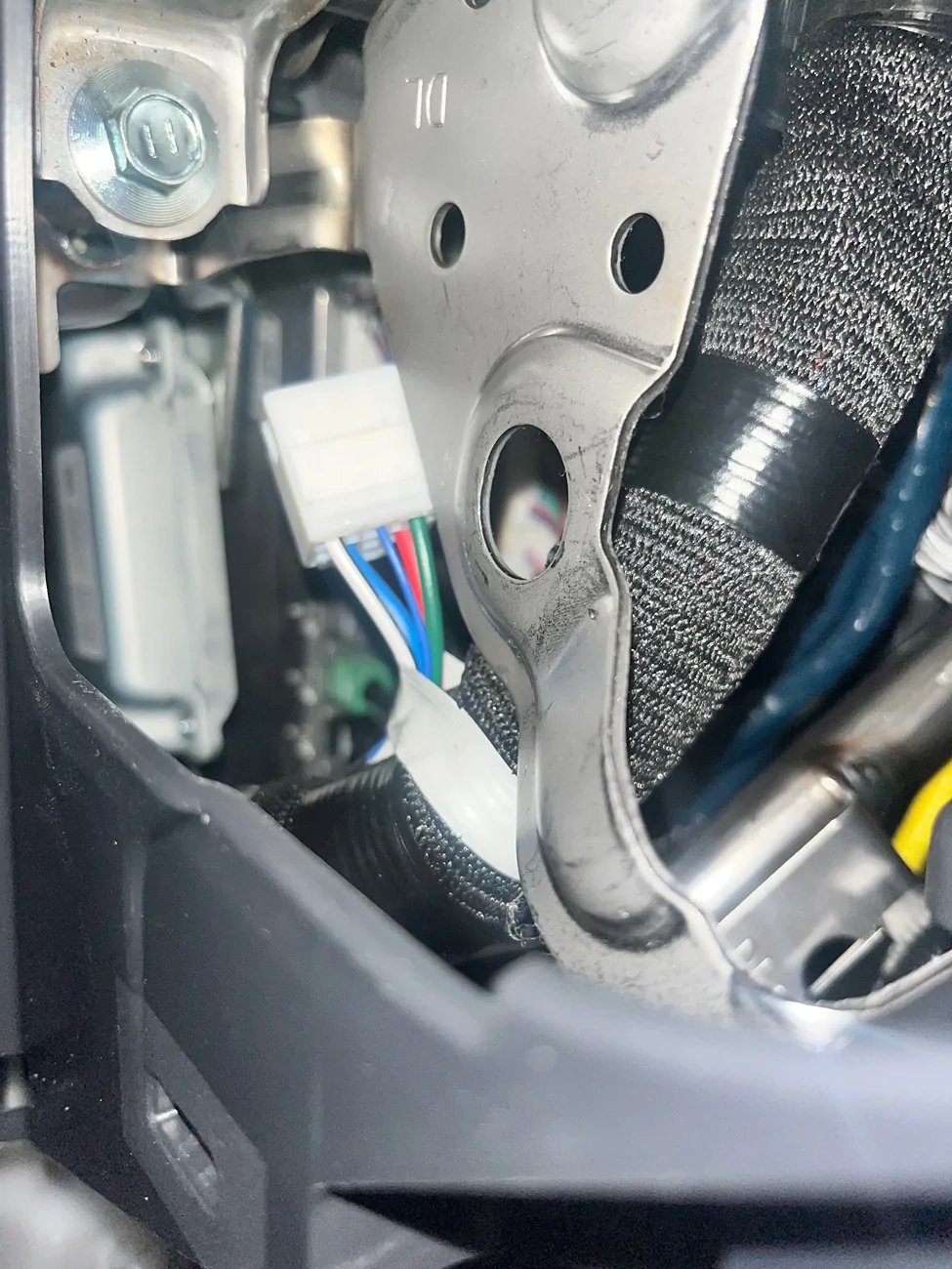

Will confirm the gas limited without the aux package (only limited package available in Canada) does in fact have this connector.

Takes about 30min to install. I just removed the lower switch cover and the brake controller plug is right there. There is a handy screw right there for the ground too.

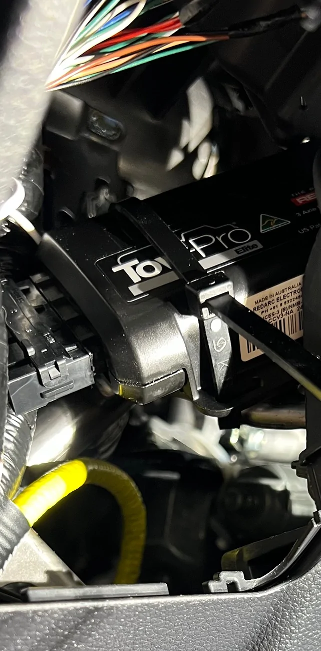

  • Brake controller - EBRH-ACCV3-NA
  • Gen6 wire harness is a TPH-021
  • I think it was a 18” zip tie
  • Regular 3/8 long extension
  • 3/8 universal joint
  • 10mm socket
  • Plastic trim removal tool

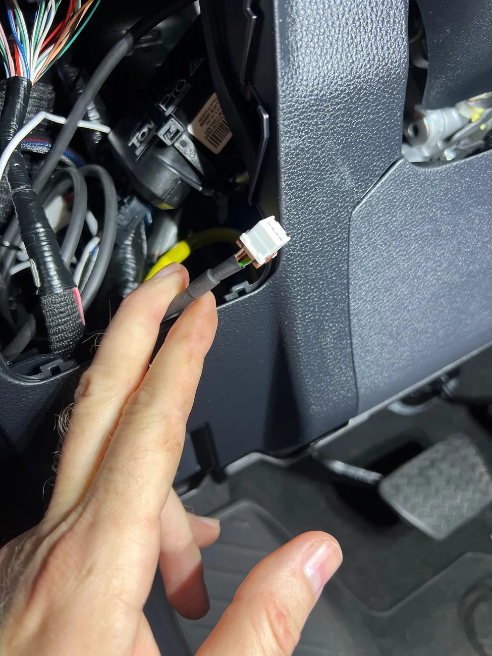

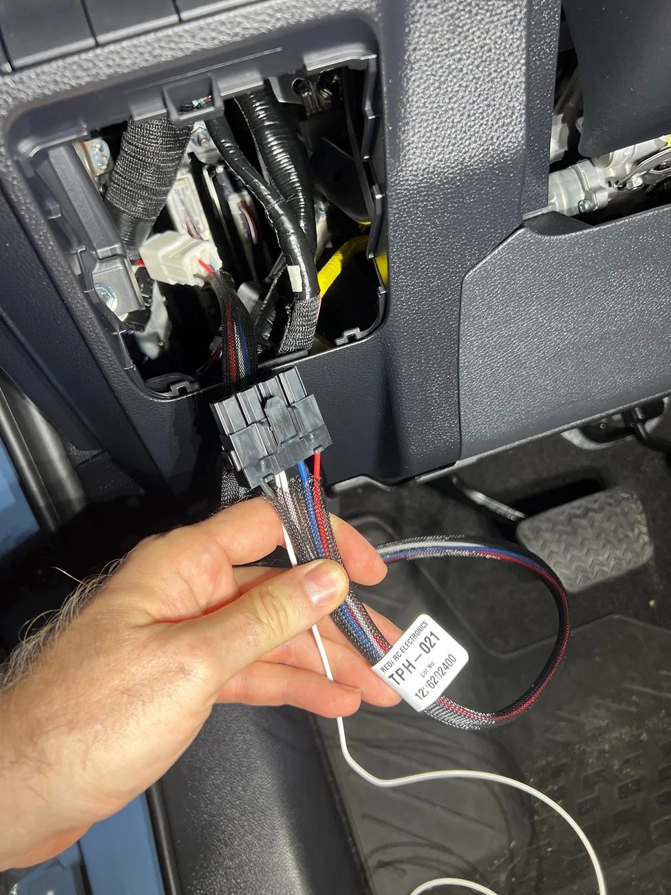

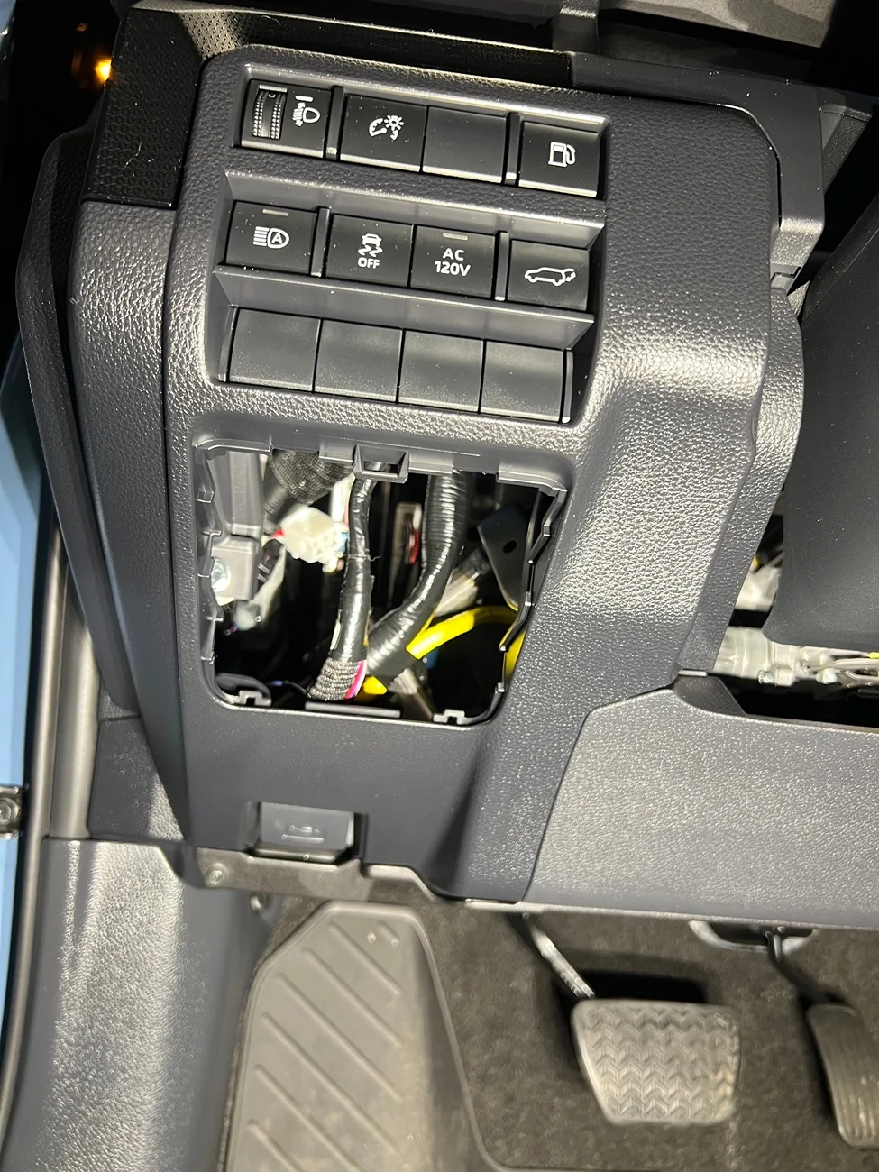

Use the trim tool to gently pop the lower switch cover out from the top center to start.
above, someone shows how to pop the blank plate out. takes a little patience.
the white brake connector should be right there when you shine your light in.

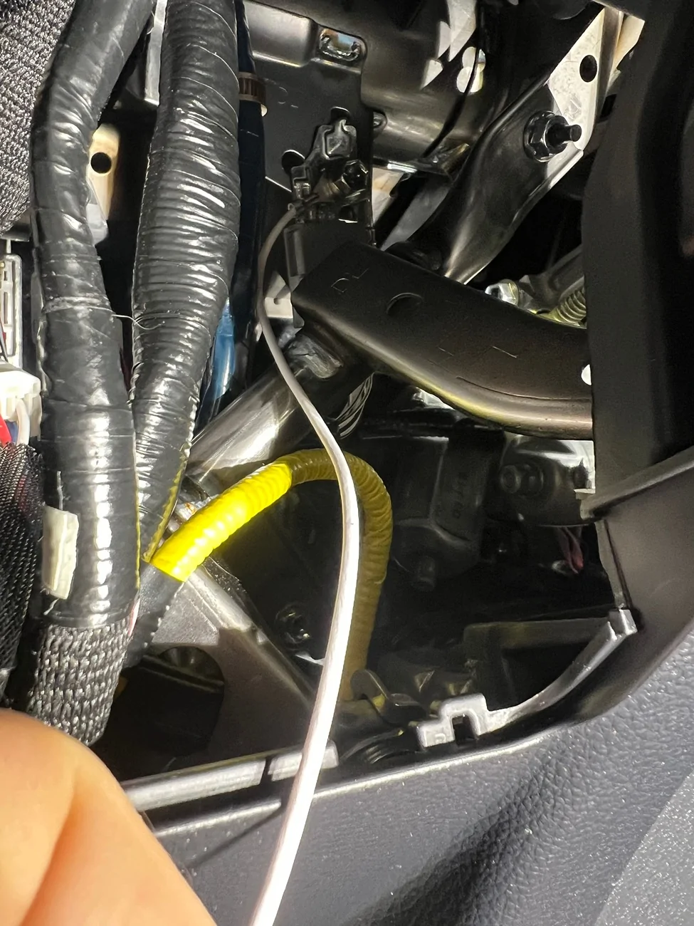

connect the white ground from the harness wire to the screw I show using the extension and universal and 10mm.

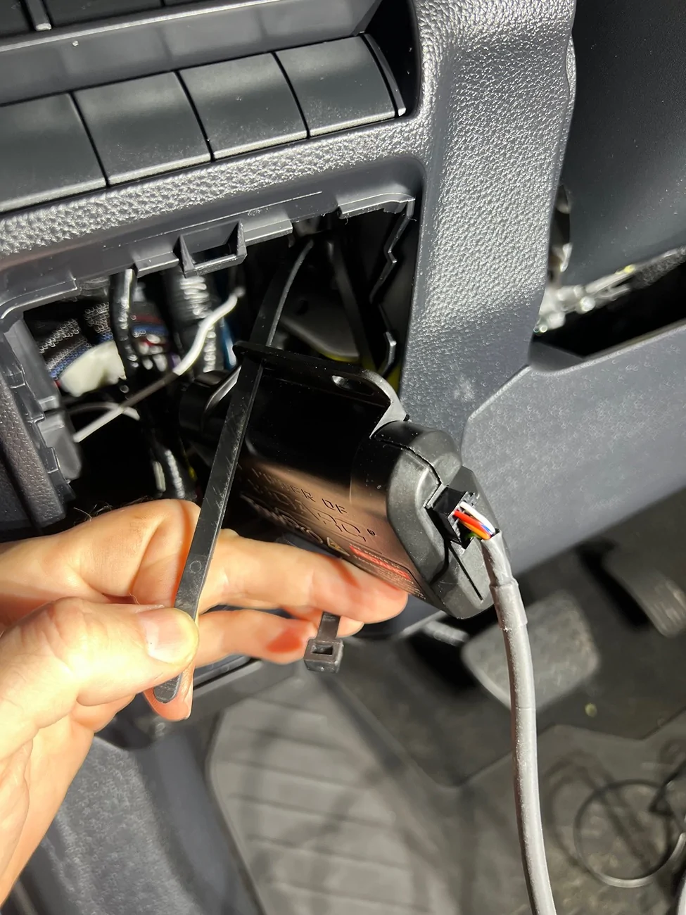

plug the harness in to the connector and controller.
stuff the harness into the dash to the left.

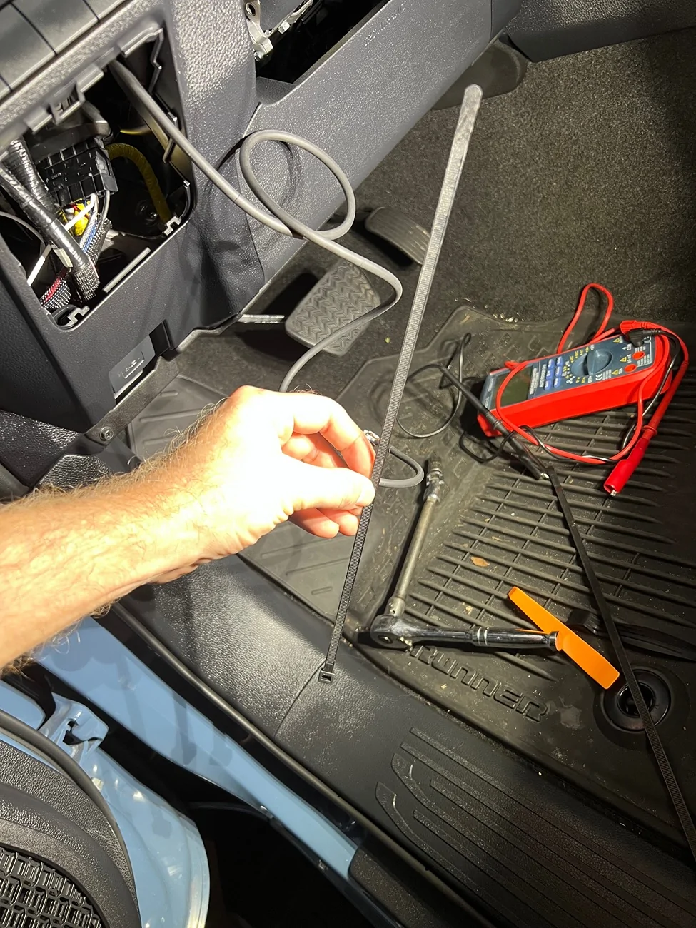

run the zip tie through the bottom mounting holes with the controller oriented have the large connector facing down.
there is a metal brace that the ground wire is now connected to that I zip tied the controller to.
that should be the hard part covered. Snap the switch plate that comes with the controller into the blank hole of the switch panel. Plug the small connector into the switch.

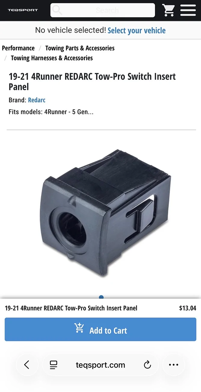

If you want to use the smaller switch blank location I have another source for that. I haven’t received it yet to see how it fits.

That smaller blank fits (TPSI-011) but be aware it’s for the elite and not the liberty. You’ll need to mess with it for the liberty remote to fit correctly
