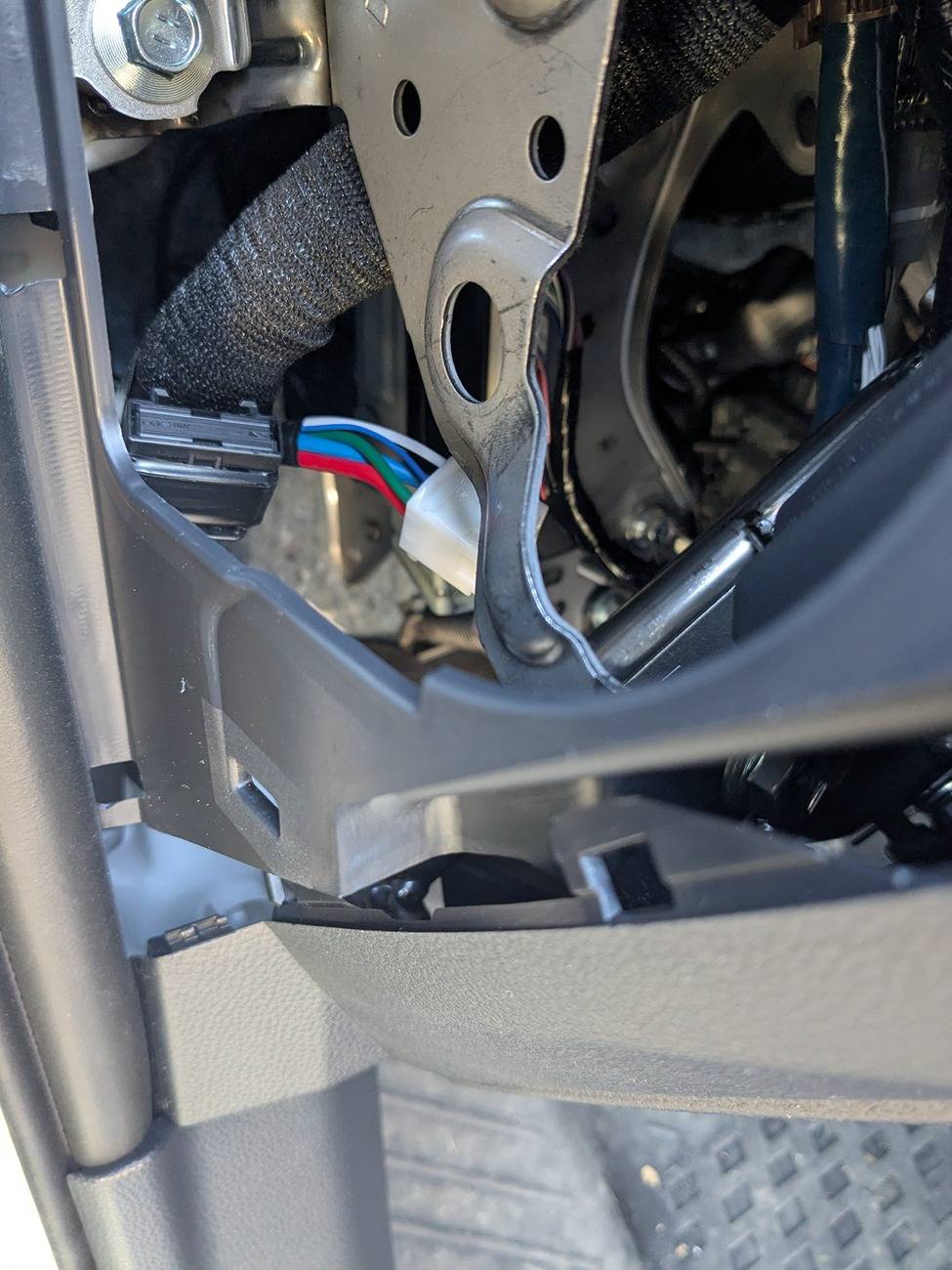

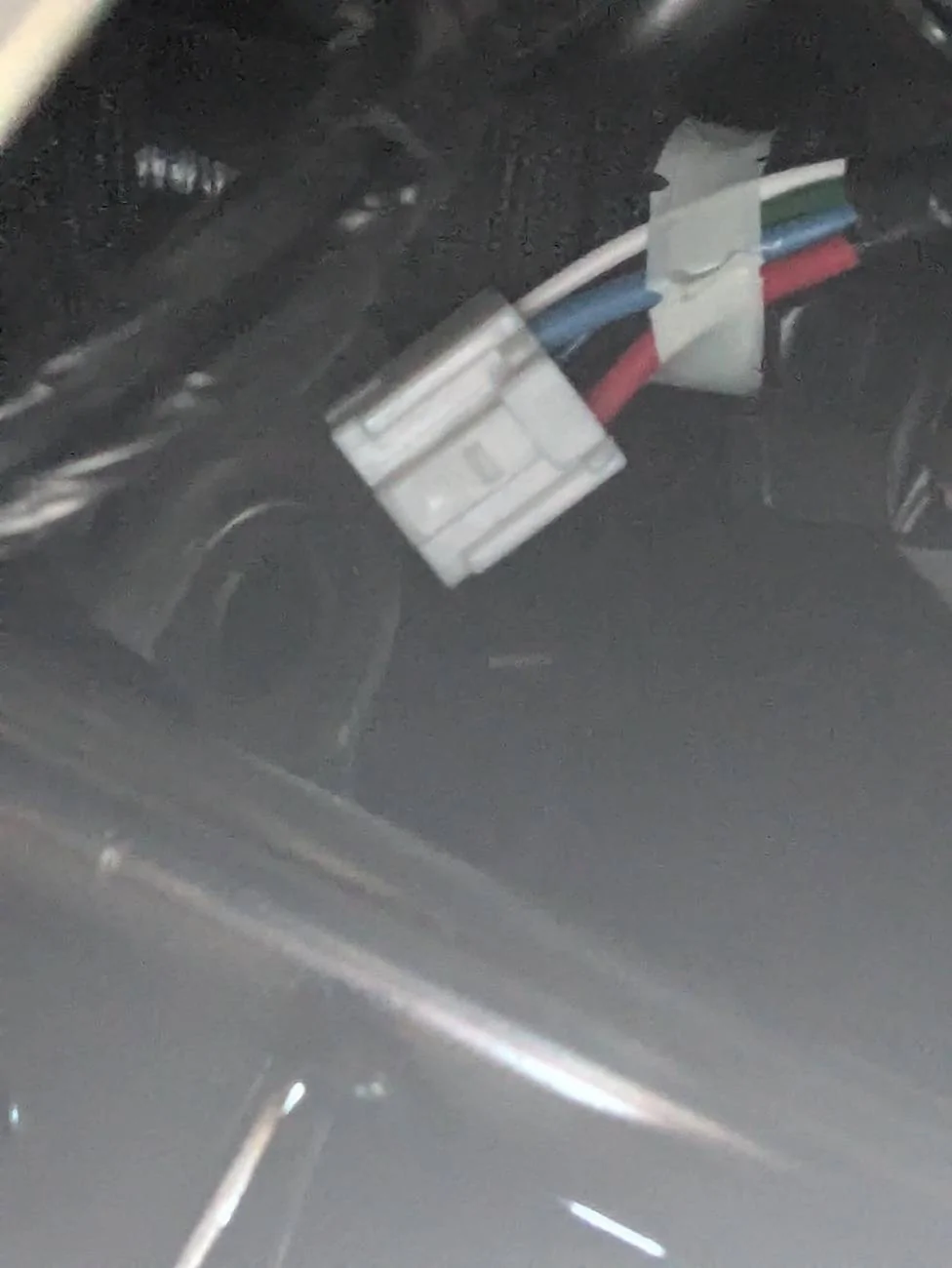

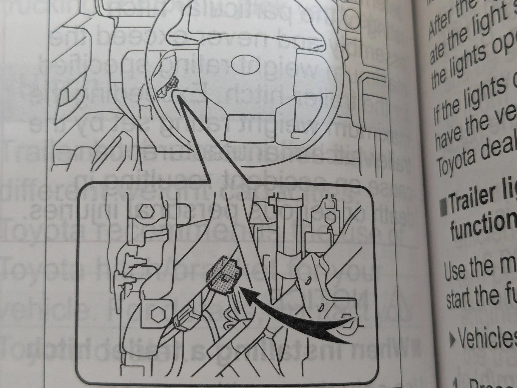

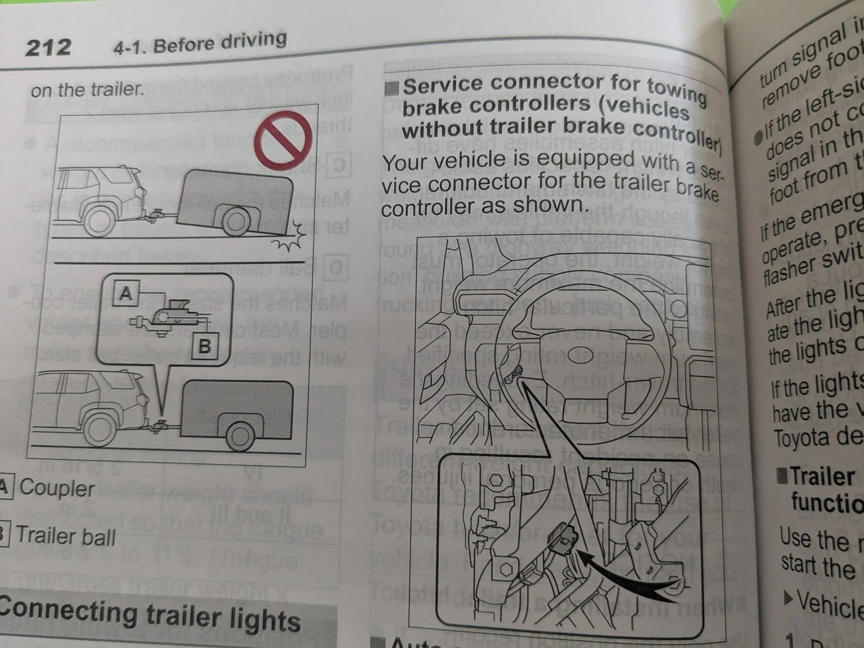

@Kokorone and @Gastan I read the book! It clearly states that this is the wire. Has anyone done any further testing. I was going to look at the pinouts for the 304100 from Tekonsha and see if it looks right. I ordered the RF, but I already had the P3. hopefully I can figure it out. Wish the book had instructions on removing the plastics. :rolleyes:
Wow I totally missed this in the manual. Good find! It should work natively with the harness from the Redarc.

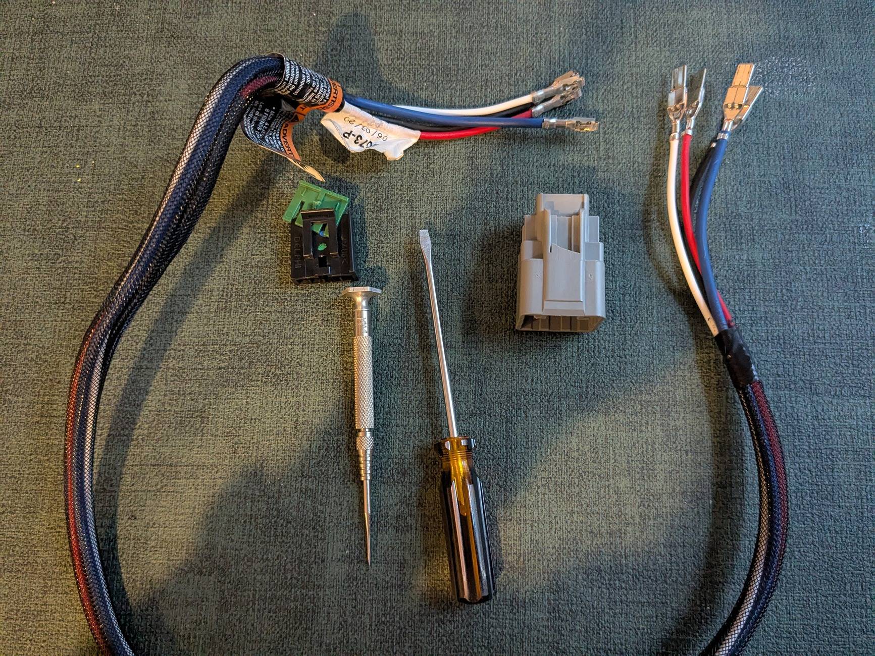

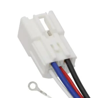

@Kokorone I took a look at the pinout for the G6-4R vs the G5-4R and they look different so the 304100 wont work. But I still have a Tekonsha harness from my JLUR 4xe. So I took it apart. Going to see if a 304100 connector fits and rewire if it does. Does anyone know this connector type? (see last)
2025 2026 4runner 6th gen Trailer Brake Controller Prewiring PXL_20250415_235917199.MP
^Took old one apart
2025 2026 4runner 6th gen Trailer Brake Controller Prewiring PXL_20250415_210920260
^G6-4R seems to be clockwise Red , Green, White, Blue
2025 2026 4runner 6th gen Trailer Brake Controller Prewiring 2025-04-15 19_13_29-TEKONSHA _ 304100 _ Trailer Brake Controller Custom Harness, Vehicle & Br
^G5-4R would be Black, White, Red, Ground, Blue (reversed cause of M vs F connectors) All educated guesses here; if there is a SME in the forum please weigh in. Do we know what this connector is called?

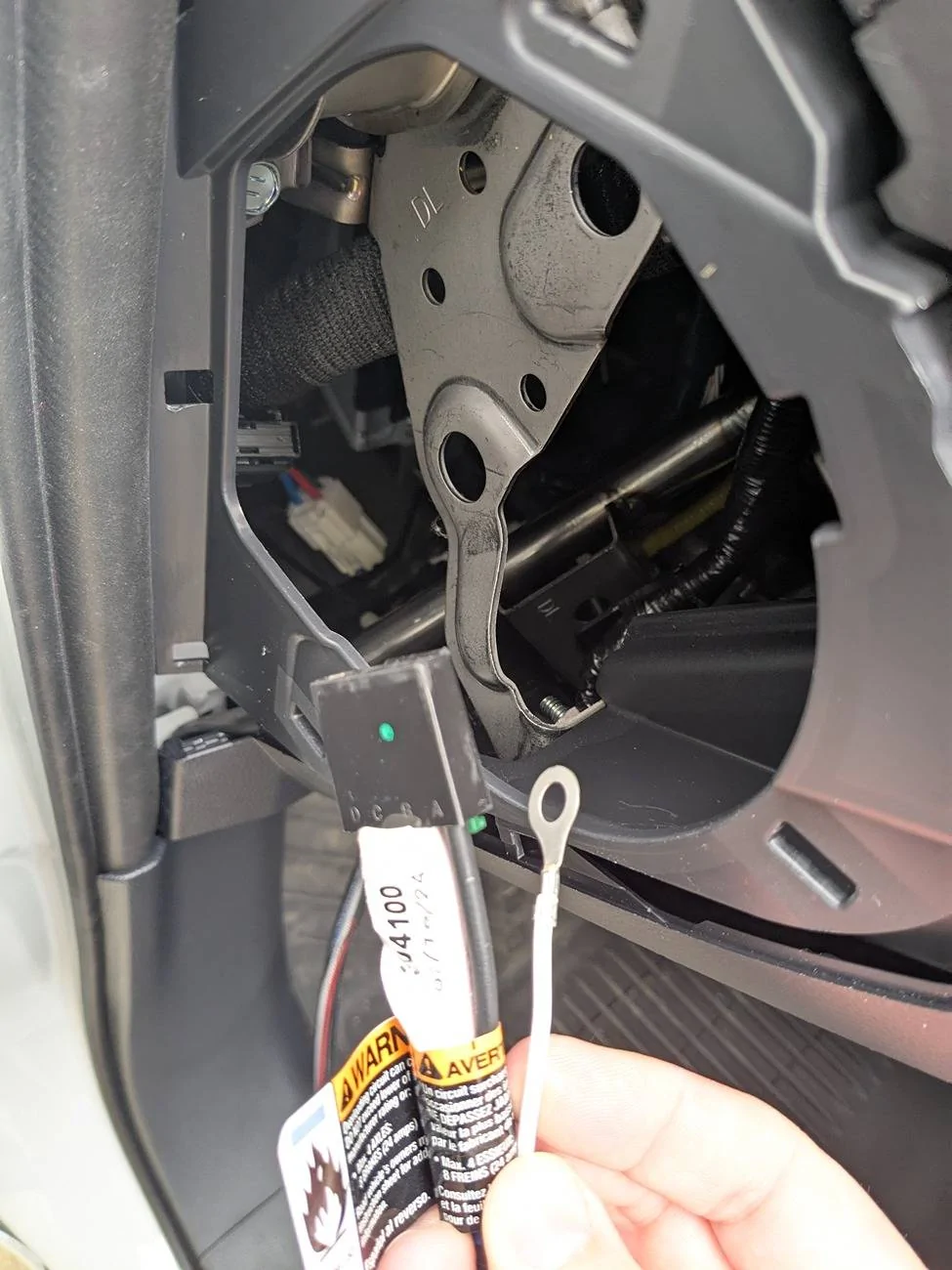

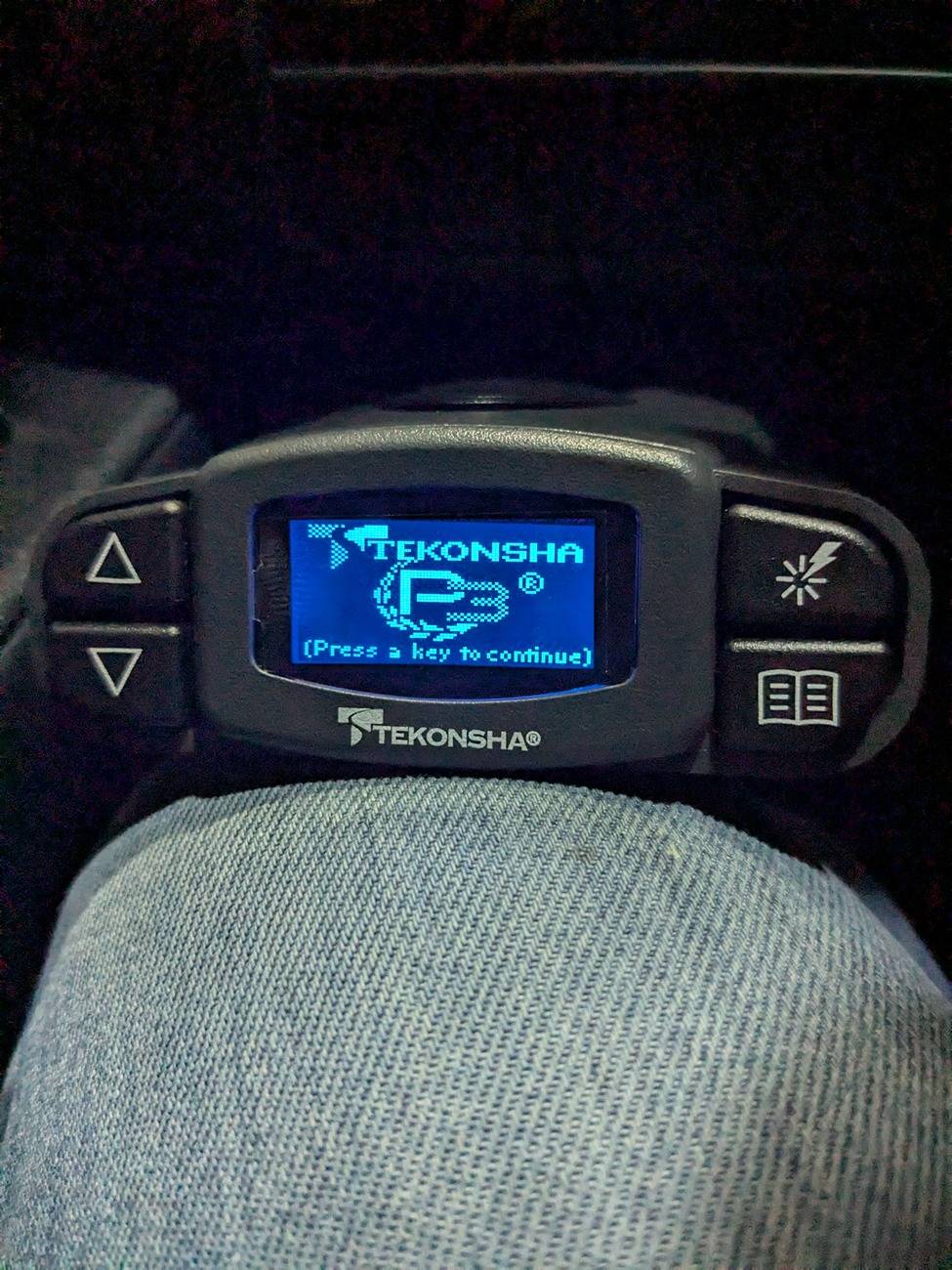

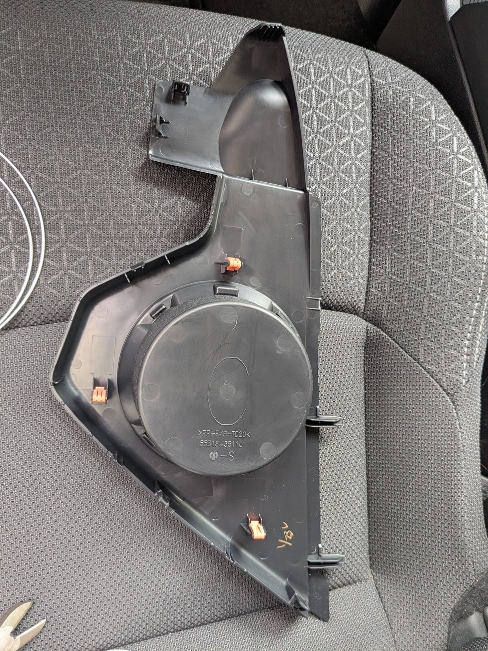

Plugged in!
2025 2026 4runner 6th gen Trailer Brake Controller Prewiring 1000128055
2025 2026 4runner 6th gen Trailer Brake Controller Prewiring 1000128052
Pull this out port ways to detach clips, then aft to slide tabs out.
2025 2026 4runner 6th gen Trailer Brake Controller Prewiring 1000128051
There's a place to ground on, right above the right terminal in the picture. I put an additional M6 10mm nylock nut to sandwich the terminal. For now I removed a button blank and fed the plug through till I locate the final location. The cable is a 304100.

I used the same Tekonsha part that the 2024 used. Plug-and-Play if you will. Tekonsha Harness
I dont have a Redarc to test with, but it seems that this would be my start if was going to. Redarc Harness

I emailed Redarc and they suggested the CIKTP-NA-012 kit which includes the TPH-021 plug and play harness.
