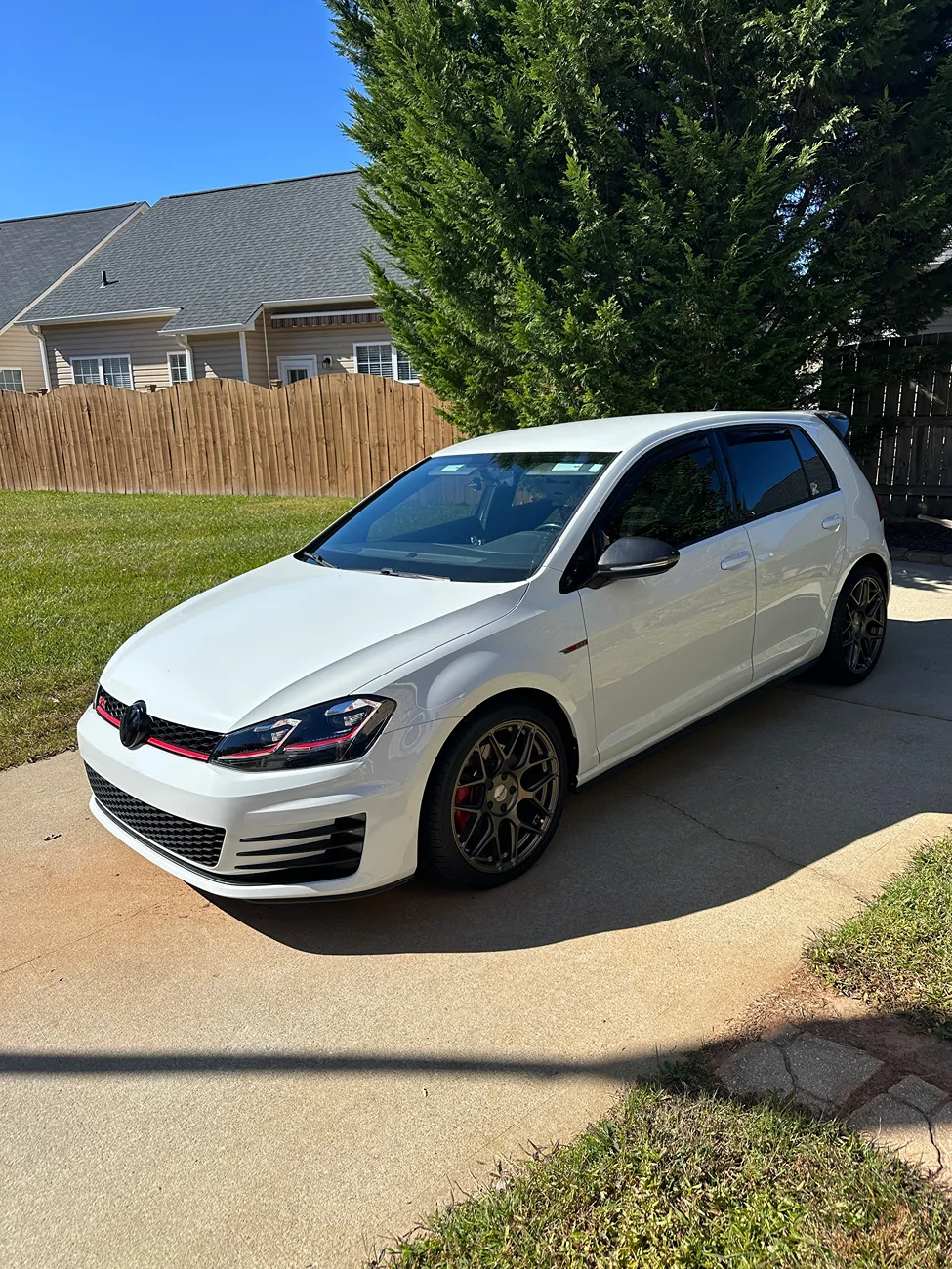

I agree...ran it in my GTI and it ran better than with 87. My 4 runner will not be getting it. My GTI got 36 mph on the highway and 30 in the city and was very quick...it earned 93! All high octane gas did was make it a little peppier and increase throttle response. 4Runner is plenty peppy enough for a truck running 87. Not paying another $19 a tank to make it more peppy.
My other ride.

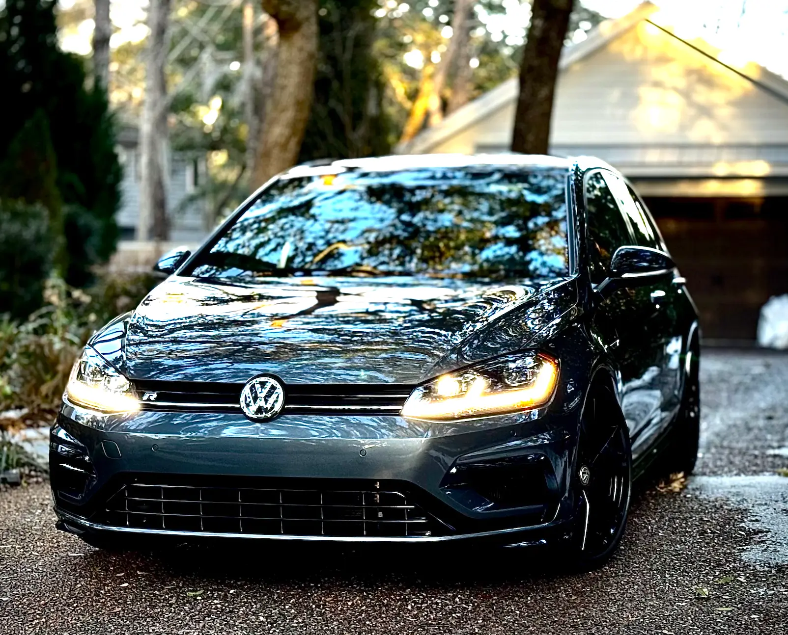

'25 4runner SR5, '19 Golf R
+1 on the side-fast
RE: 93 Octane
I have been running it in my SR5. It may be a waste, but... my likely flawed logic is running 93 octane in my SR5 during break-in at least is that it gives me the most stable combustion and consistent performance while the engine is still seating and adapting. The 2.4T is designed to run fine on 87, but its knock control strategy will pull timing under certain loads on lower octane. Higher octane doesn’t add power by itself, but it does reduce the chance of the ECU needing to reduce timing to prevent knock, especially on long highway pulls or in hot conditions. It’s not required, and I may go back to 87 later, but for break-in and long road trips, I prefer the smoother, more predictable behavior on 93.
RE:OP
FWIW, my motor sounds a lot like yours. Phone recordings tend not to do it "justice"... in terms of all the knocks, toots, whistles/whines, tweets and everything in between. I am also trying to get used it. AND... getting the hood insulator. 😂

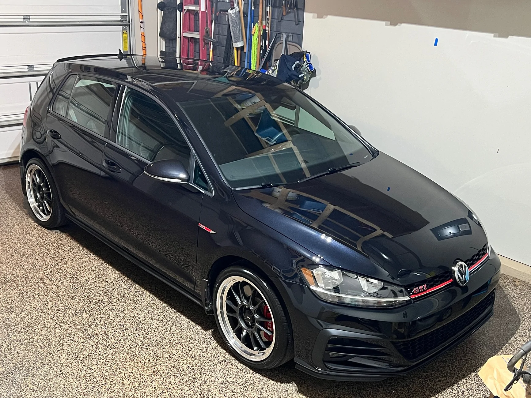

Yeah...I can tell you a VW GTI drives a bunch better on 93 octane...no difference in MPG...very noticeable throttle response difference. Not all turbos are the same though. I agree with you though. Don't need my 4 Runner to be as quick as a GTI. Just enough power to merge and pass.
Absolutely
