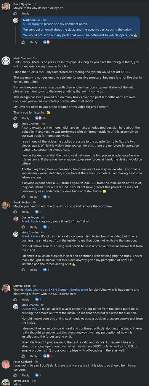

See SXTH's responses below from the videos I shared of the leak test:

SXTHMark
Oct 5, 2026
Spartanburg, SC
2024 Toyota Tacoma
I think Sxth but off more then they can chew with this one. That air that leaks between the flange and the plastic pipe under boost will be sucked in through the leak along with the air in the pipe. Creating unstable air flow to the compressor. I don’t believe the product was intended to leak by design but because they never got a CEL light they just stuck with it and said it’s good. Not a good move in my opinion
Hey there! I will be performing an experiment trying to suck smoke into the inlet from the outside. I will update when I get that complete and set up. I have to print some fixtures and pieces and do some other research.
Smoking the tube under any positive pressure from the inside is just showing an assembly smoking in a situation that doesn't happen in operation. I disagree it that validates a normal operation malfunction.
This is also making an assumption here that a 5+psi smoke test will show the equivalent leak of the operating vacuum inside the inlet. I am digging into this info as well but my initial guess is that the very large amount of smoke in the last video would not enter in that joint from the outside given vacuum pulling thru the tube from the turbocharger at wide open throttle.
Another thing to note, pressure from the inside would naturally push components apart, while vacuum would help pull them together. This still needs to be confirmed.
I am also searching thru the OEM manual and will hop into my OBD reader to look at mass flow during operation. Once you know max mass flow in g/s, you can calculate a % of leak knowing the dimensions of the all the parts. I have calculated the possible gap (o-ring present or missing) and the amount of possible air leak in g/s is VERY small, less than .1 g/s - when the OEM manual shows me MAF testing procedures at 25-30 g/s - this comes to be a 0.004% ~ .003% effect, which is very negligible to say the least based on the geometry.
Either way, I believe while the smoke tests being done currently have good intentions behind them, they are not properly executed for real world conditions.
Give me a couple days, I have to:
- order some longer vacuum hose to measure engine vacuum at the turbocharger with my manometer
- print a new inlet with a measurement port for the manometer
- do some driving to measure real world vacuum generated the turbochargher
- print some jigs to do a bench test - I need to make sure my vacuum generator can match the vac generated by the turbocharger
- get a new smoke machine myself (already ordered)
- research the OEM manual for the correct values for sensor operation and CEL thresholds
- compile all of this together
If anyone has any other suggestions, please post up.
If you are still with me, thanks for reading :)

You are correct in theory. The only thing I would disagree with is the leak/turbulence point.
The turbulence doesn't matter, it's post MAF measured air that does here. Any post MAF leak in the intake air path will cause a CEL if past a certain threshold which I am searching for, just to have the number.
As I said earlier, the physical gap itself only presents a 0.004% g/s leak if the o-ring is not there.A value like this is a moot point and figuratively the same as zero in the grand scheme.
I will confirm all these numbers in the coming days but yes, you are right in the function of the inlet itself for reduced pressure drop so the turbo operates more efficiently.
