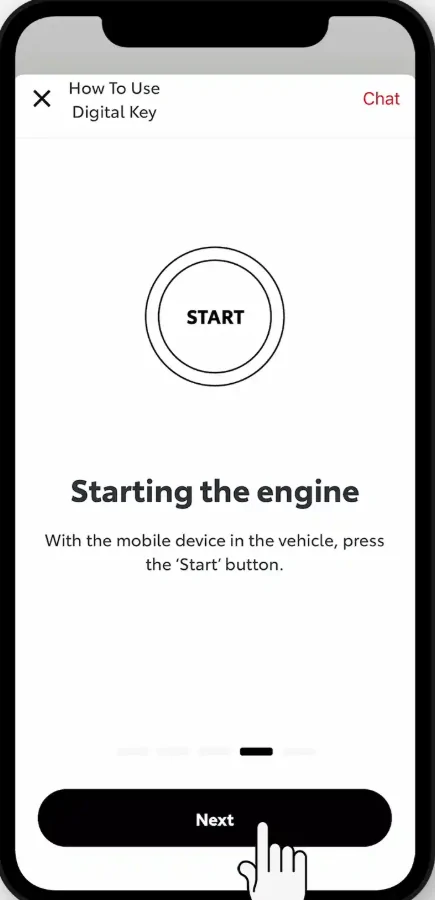

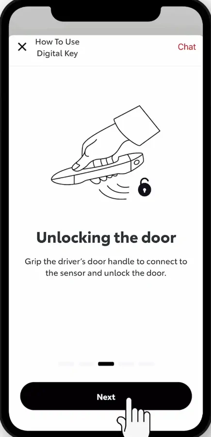

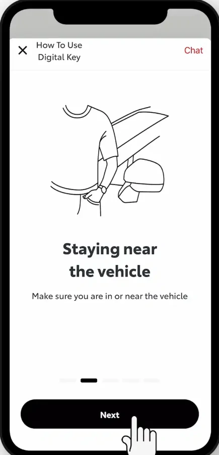

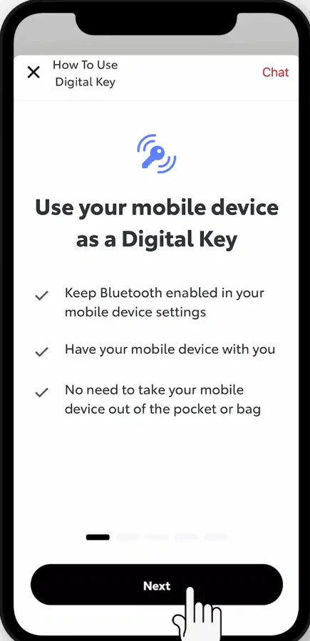

if you are using the digital key, you need to have the app on your phone and then you must have bluetooth turned on.
if you want to thwart cloning, you turn off bluetooth. simple as that.
but you must have the remote connect subscription and the digital key option (PIO that costs $275) when you buy your vehicle as its a hardware restriction. right now i dont know of a way you can add the digital key feature after the fact.
most car's that are stolen are using the fact that most fobs send out a constant signal so when you get close to your vehicle it knows to unlock when you grab the handle. hence the videos you see people carrying a antennae array to pick up a fob signal to clone.
one way to thwart this is to have a hidden start interlock regardless if they clone the key.
another option is to put your key fob in a faraday cage when at home
there are some canbus interlocks that require you to input a pin to start the vehicle (but this will defeat remote start for cold climate areas)
to solve the cloning issue while you sleep, you can turn off your fob from sending this signal as stating in a post above.
below is the process for using the digital key for toyota's

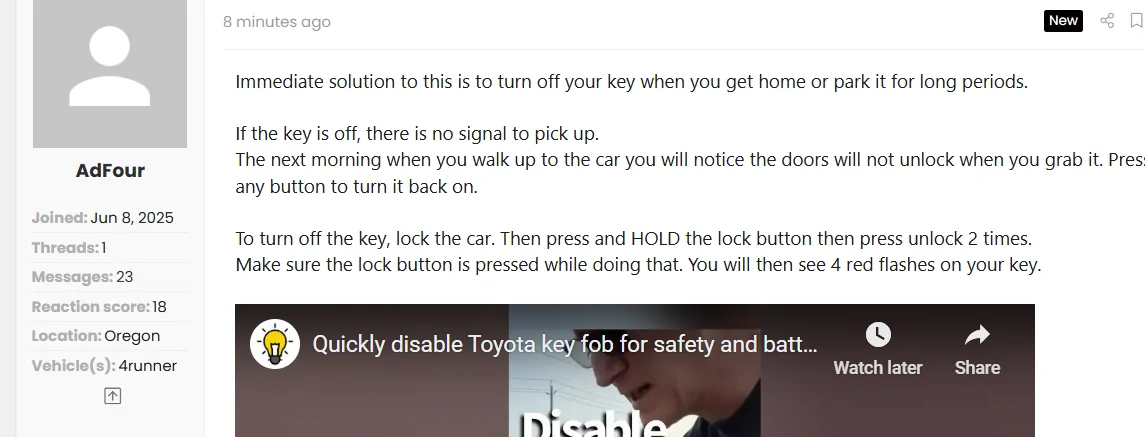

a faraday cage or bag would be more convient, the process of turning off the fob will get tiresome really quick
the turning off the fob is mostly for a long term solution for like when you go on vacation or something else for long term.
its not really meant to be done on a daily basis since you need to initiate the process when you leave your vehicle and when you return to the vehicle to turn the fob back on.
the instructions are in the manual
