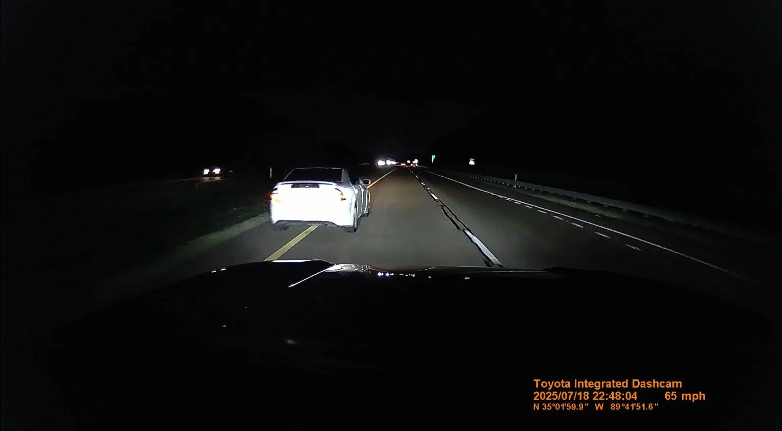

So I was driving home from vacation on Friday night, and while changing lanes, got side swiped with a mirror from the car in this picture. The stock camera does not do any kind of job picking up the license plate. Cant decide if it's a camera or a headlight problem. I guess I'm switching it out for either the @Wolfbox or Viofo cameras.

Just found this out too. The plate looks like AI in the footage. Can't get a single clear number and I was about 15 feet behind the car in broad daylight. Absolutely useless garbage.

90% of dash cam out don't have good image sensor for night time license plate read out from a distance. You need a real 4K sensor but that comes at high cost, heat & storage. During day time, most will do fine.
Here's a pro tip: if you witness an accident while driving with dash cam active, speak the license plate out loud! All dash cam also record audio. It's a lot easier to view the footage & write out the plate from your audio.

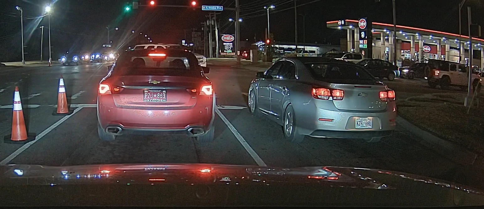

most of the high end dash cam's run a starvis 2 sensor, dont settle for less than that.
the viofo 329 series run starvis 2 sensor (so does the 119 mini)
viofo posts all the type sensor on the specs section of each camera
starvis 1 (also known as just "starvis" is the old gen sensor)
