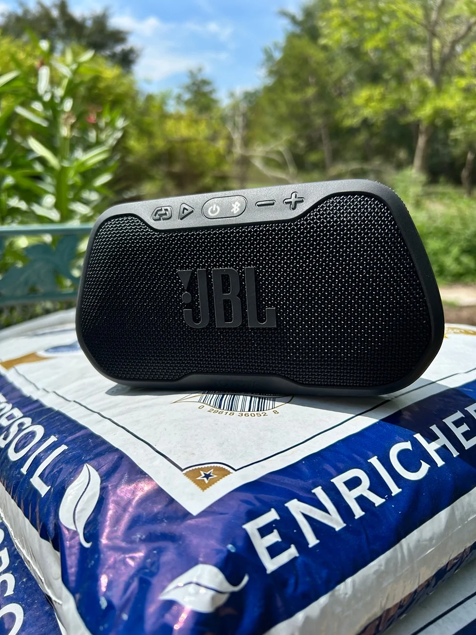

Discovered i like the JBL dash puck speaker (never thought i would use it) but seems i can only get it to work with my iPhone. It really works well with my iPhone.
I can’t believe it will not work from using it with the 4Runner on XM and playing if i wanted to set it outside the vehicle? I’m sure it’s me screwing something up. Any advice please?

if your phone is connected to the head unit via BT, usually you cannot connect to a secondary BT device at the same time.
if i remember correctly the removable speaker when in its cradle pulls data from the head unit but when out of the cradle it connect to a paired BT device.
