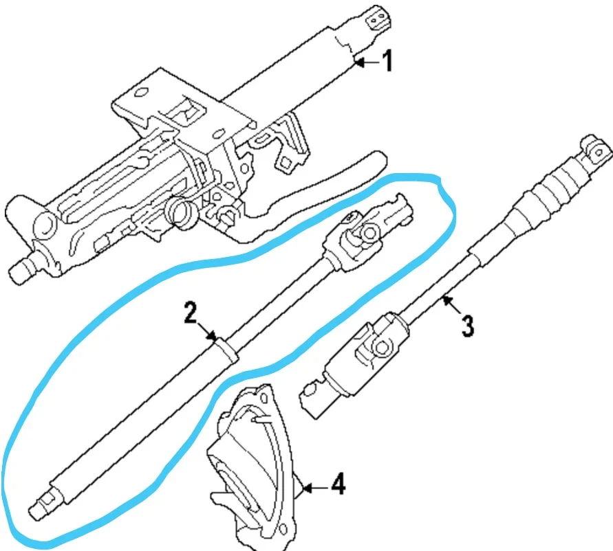

Your steering intermediate shaft needs replacing. Search for threads about that on here, there should be a few

The part they replaced is the lower #2 shaft, 45203-60300. All good for now.
