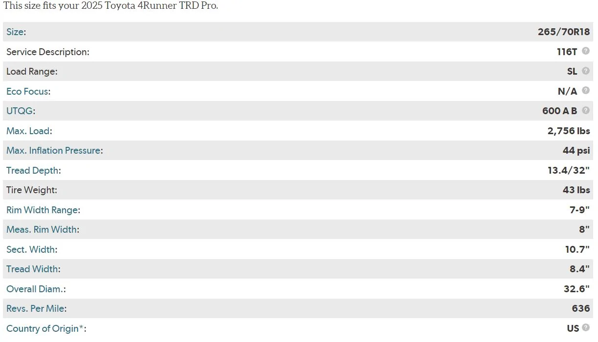

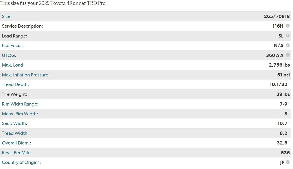

I would appear that Toyota is outfitting these trucks with Toyo Open Country A/T III GA tires which should have 10.1/32" tread depth @ $330.00 a tire from Tire Rack
The tire that is also availble for us to purchase is a Toyo Open Country A/T III with 13.4/32" @ $296.00 a tire from Tire Rack.
2025 2026 4runner 6th gen Can’t fix TRD PRO Steering wheel vibration! TOYO Specs
2025 2026 4runner 6th gen Can’t fix TRD PRO Steering wheel vibration! TOYO GA Specs
One correction: the OEM tires are Load Range E.....not SL.
The tires that come standard on the 2025 Toyota 4Runner TRD Pro are Standard Load (SL), not Load Range E. Specifically, they are typically Toyo Open Country A/T III GA tires in the size 265/70R17, according to a 4Runner forum. While the TRD Pro is designed for off-roading, the tires are still typically SL-rated, not LT (Load Range E), for a balance of performance and comfort, according to a 4Runner forum.
