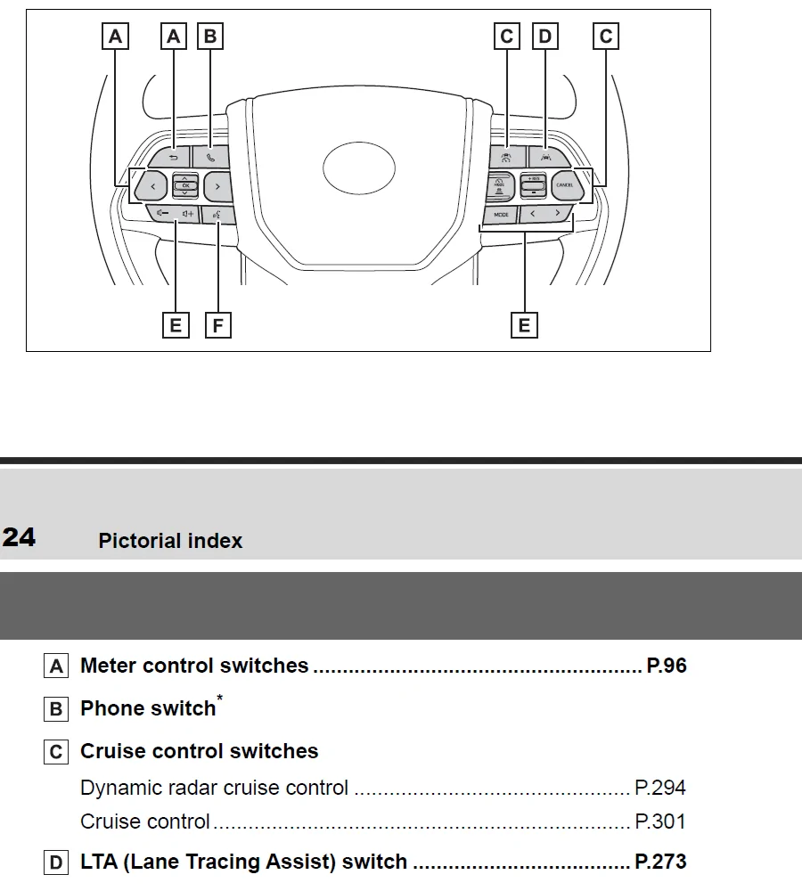

to change between dynamic an constant cruise control you hit the toggle just below "C"
to initially set cc speed, you have to hit "C" button.
to increase to a higher set speed you have to push up on the toggle labeled "+ RES / -"
to set a lower cc speed you have to hit "C" again
if you want raise or lower the set cc speed in slow increments, you hit the "+RES/-" toggle
its completely counterintuitive from the old days and more complex than it needs to be
and a complete pita vs our 23 tundra

I assume you know this but as noted above you have to toggle to the “standard” cruise control option BEFORE pressing the cruise control button above the toggle switch. You cannot toggle to standard option after pressing the cruise control button. I see that error message if I try to do so. It is not intuitive.
