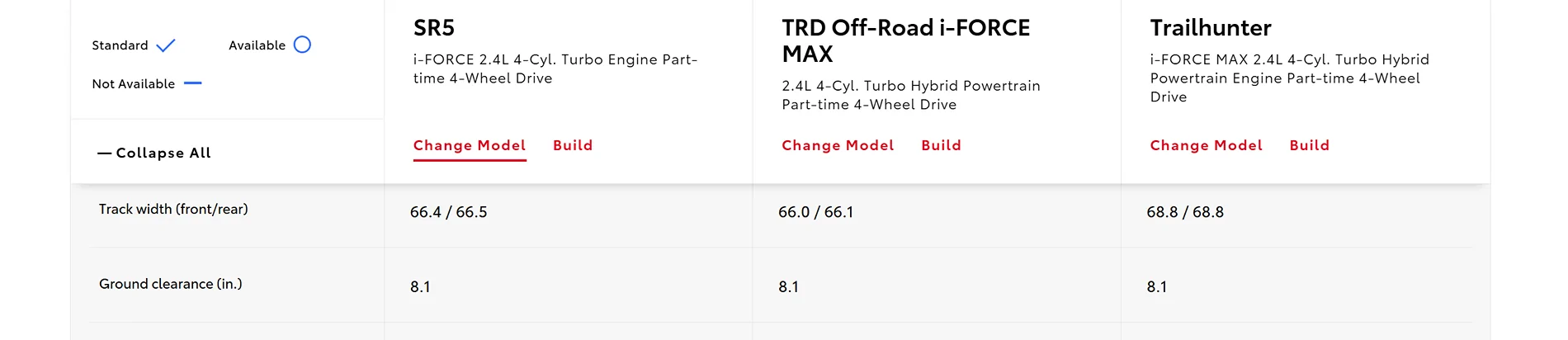

*all* of it comes from a larger tire(*), a lift won't change the distance between the rear pumpkin and mother earth.
(*) unless you add portals
One has to wonder how the OR has 1” more clearance from a tire that is 0.5” larger in radius!

I have no idea how Toyota measures ground clearance...
There is 1.05" difference in radius between the SR5 245/70R17 and OR 265/70R18 tires. That is the ground clearance difference as @shine stated.
