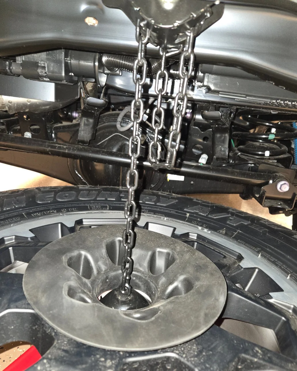

I watch closely and my chain is not twisted. Like OP stated, the tire breaks loose, drops a little, but then will not lower.

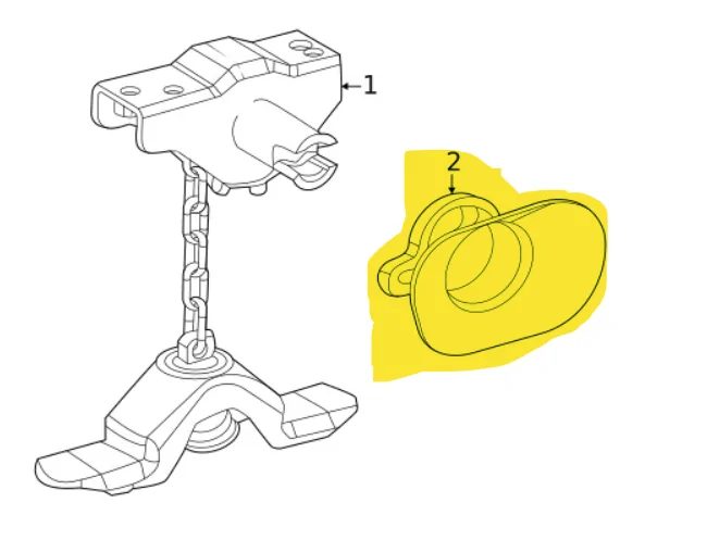

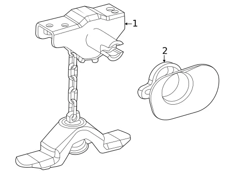

Shake, wiggle, push, pull, twist right, twist left, doesn't matter. But there's only so much you can move it when the tire has barely broken loose. Also not dirty. Still won't come loose. Unless something broke, it's just not a good design. This shouldn't happen.
Feb 14, 2026
EastCoast
Mine got stuck/hung up and it was part #2 in the diagram that was making it difficult to lower the tire. Mine is now on the floor in my garage, but I can raise and lower my spare ;)
2025 2026 4runner 6th gen Spare tire won't lower 1791677162264-nl
Yours was getting stuck on the plastic funnel-shaped crank tool guide ?
2025 2026 4runner 6th gen Spare tire won't lower Chain 2
