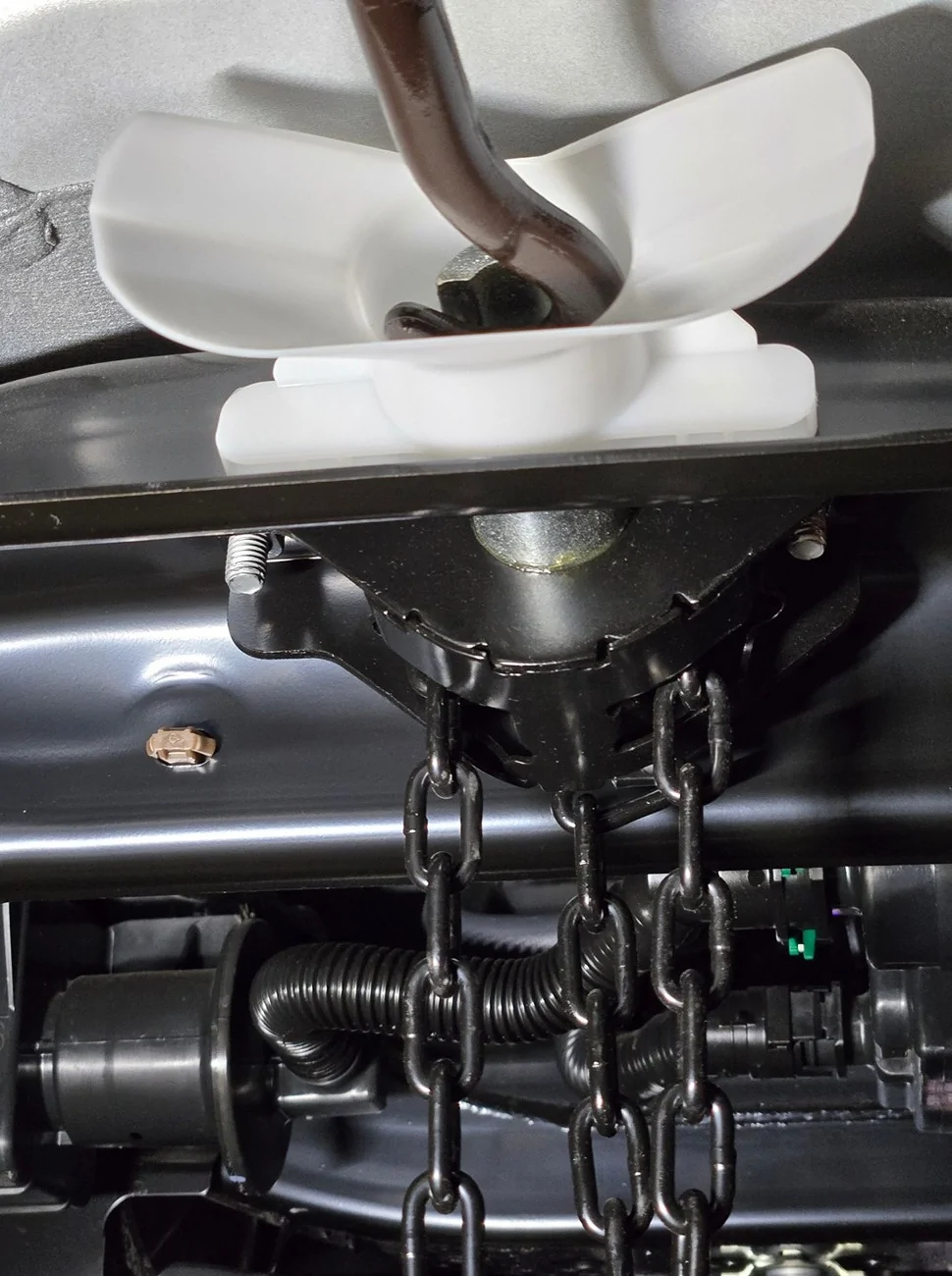

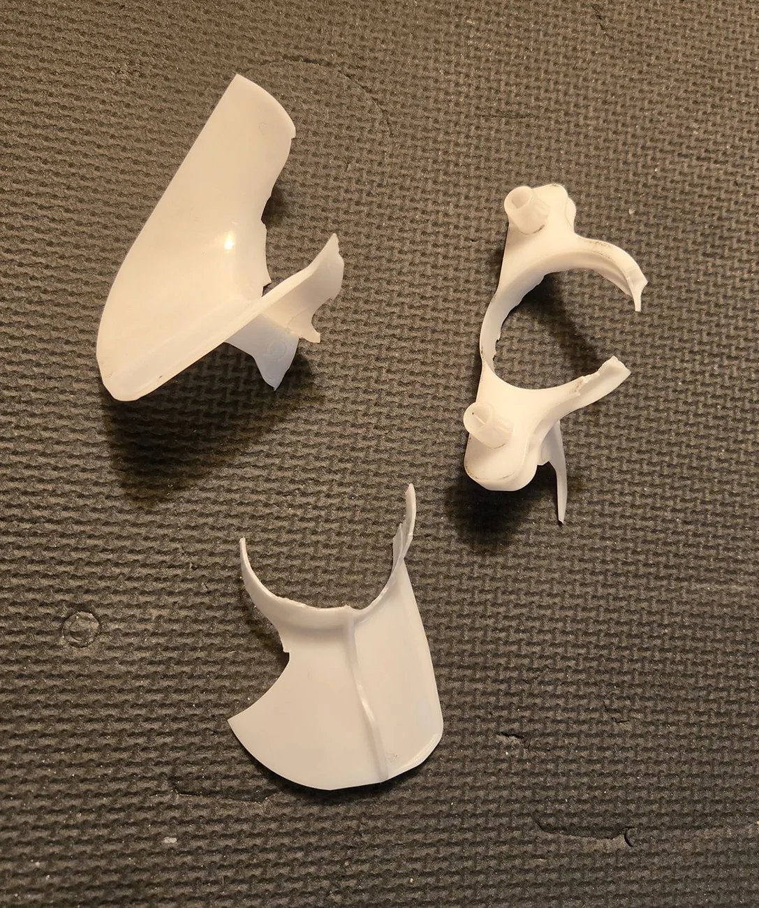

Yours was getting stuck on the plastic funnel-shaped crank tool guide ?
Yes, sorry I should have explained. The plastic guide is held on with 2 tabs and one of those was broken so the whole piece was loose which made connecting the hook challenging, but it would also rotate which felt like resistance on the chain when trying to lower it. Don't know if I broke it when putting a full size spare under the truck or if it was broken during assembly, but I removed it and haven't been motivated to fix or replace. As others have said, the overall chain and gear assembly are pretty basic and reliable.
