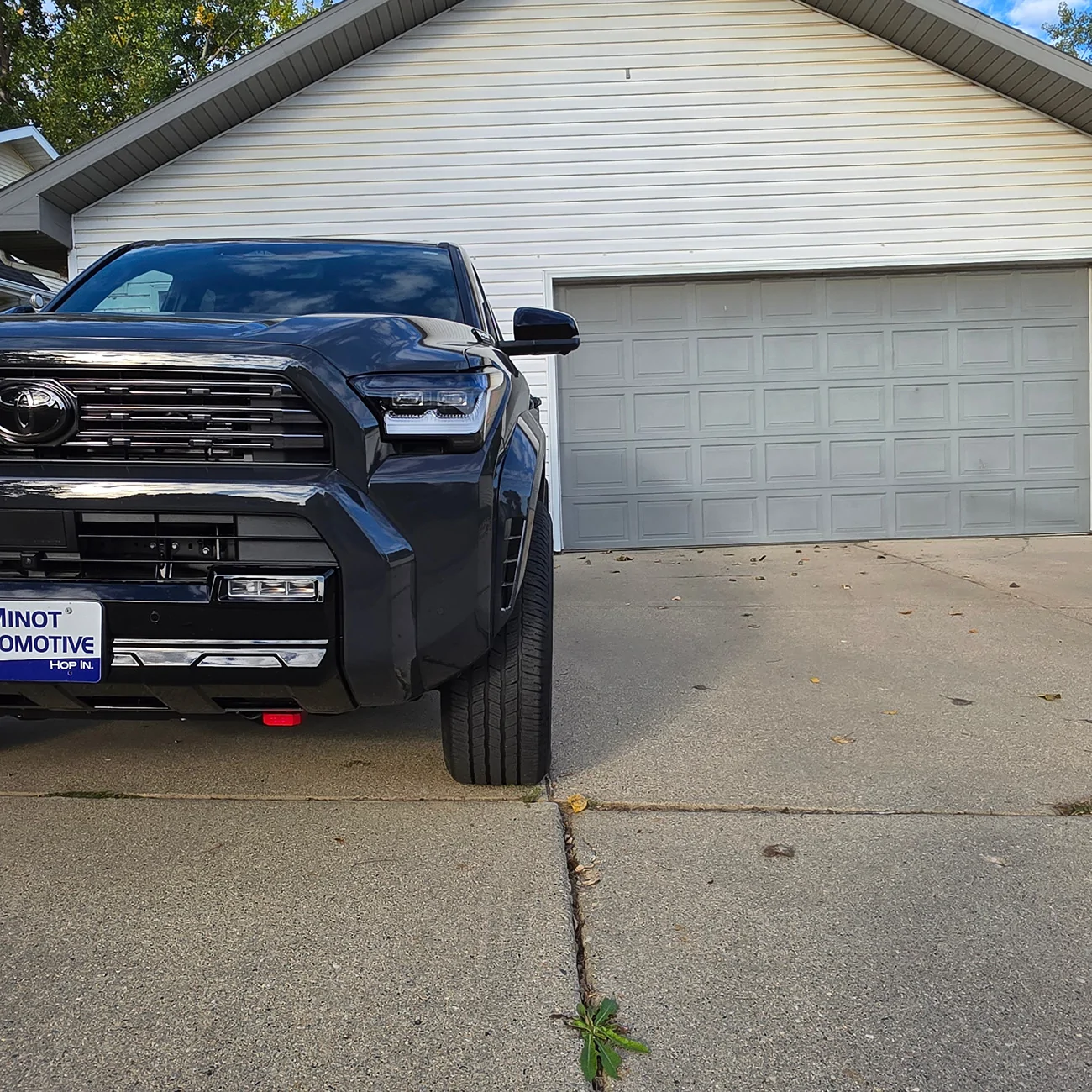

just install a good set of aftermarket wheels. around 20mm offset will get you about 1in of poke past the fender well without even using spacers
the oem offset is like
45 for the 20in wheels
55 for the 18in wheels
50 for the 17in wheels
you will be hard pressed to find aftermarket wheels that even come close to oem offsets to justify spacers to get some poke.
im using 20mm offset wheels from fuel and here is the poke
2025 2026 4runner 6th gen Spacers 1-in vs 1.25-in vs. 1.5-in, etc 2026 Driver Side Wheels Pok
