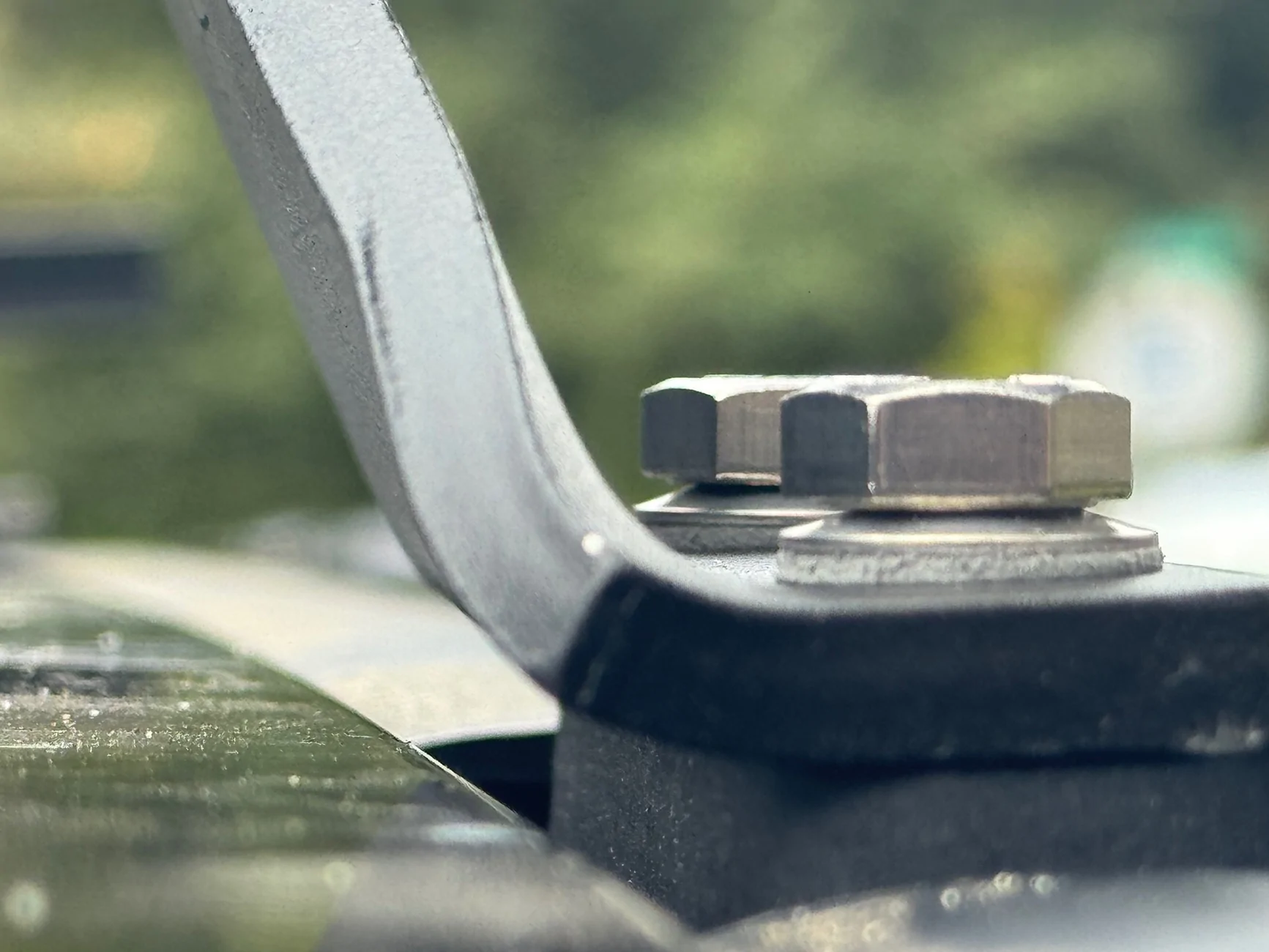

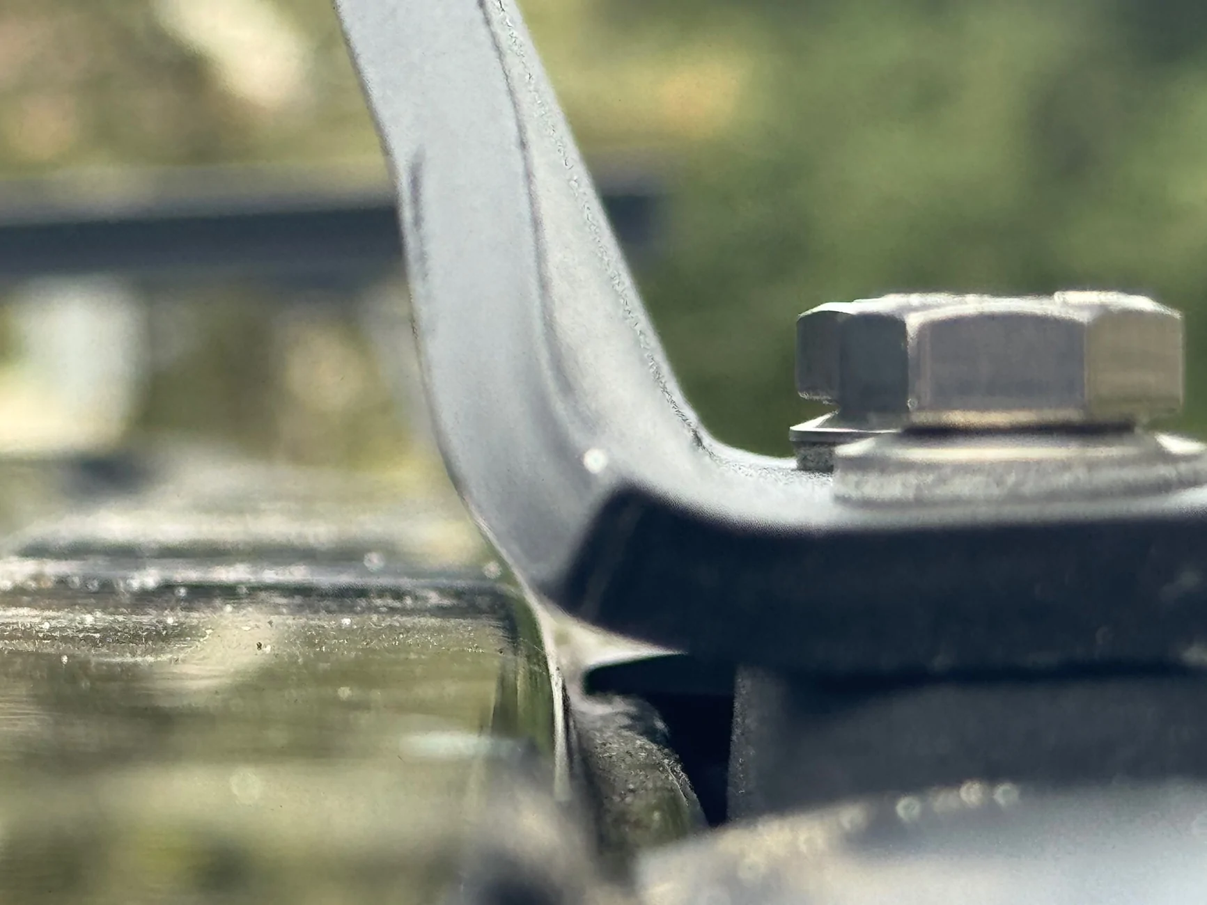

went with the capitol from sherpa, since i’ve never installed a rack (let alone one from sherpa) can someone who has installed the same sherpa take some photos of what the rubber stoppers and the bolts look like on theirs? wanting to see how much, if any, the rubber block should be squished down from tightening the bolts (same for the bonded washers) wanting to make sure they were not over tightening but also not under tightening and having a visual reference from others who have finished theirs would be helpful! thank you!

@DannoSchmanno here's what mine looks like in the back. No easy access to take pictures of the front mounting hardware. You can see that the bonded washers are slightly compressed and bulging, but that's about it.

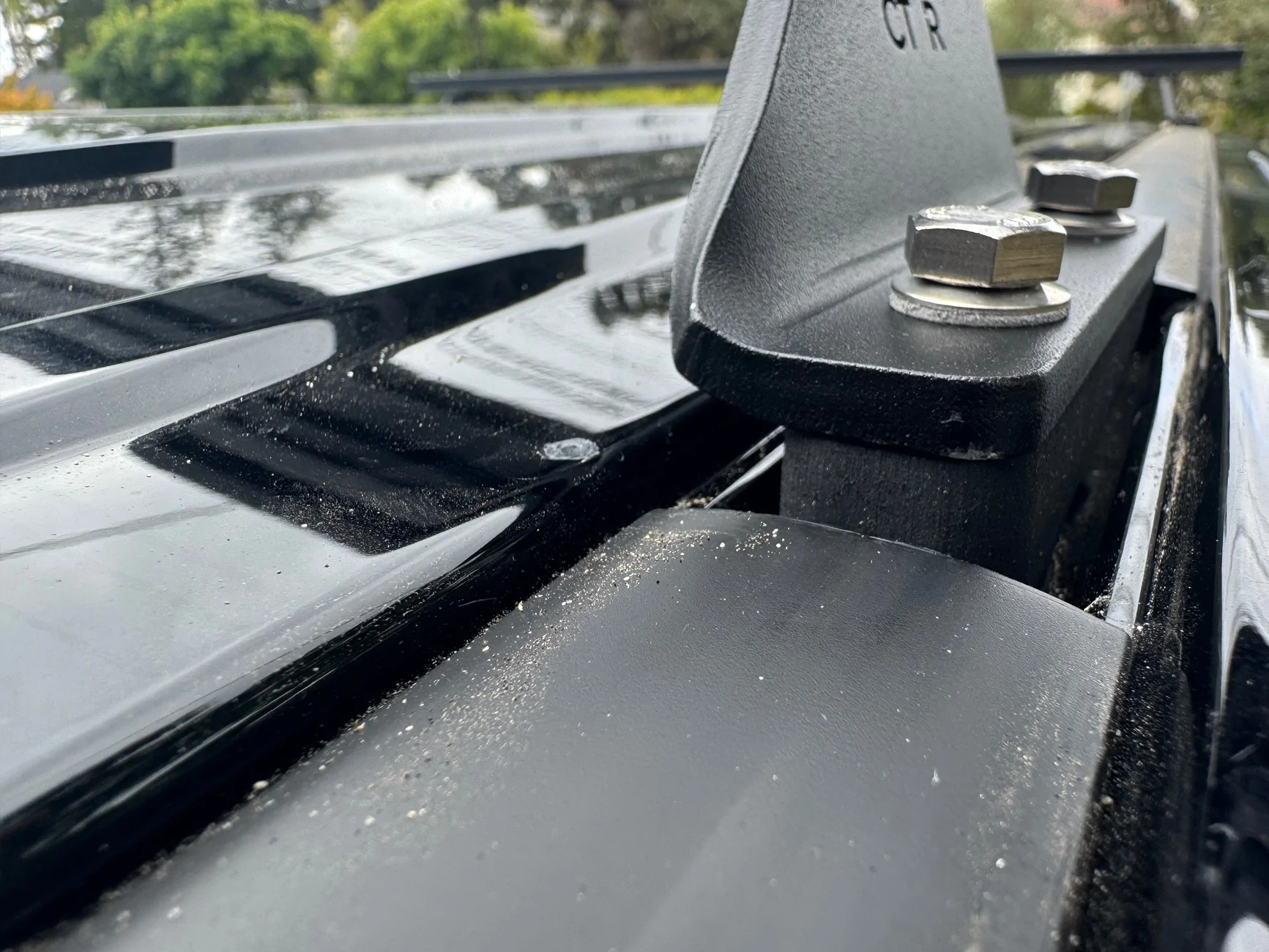

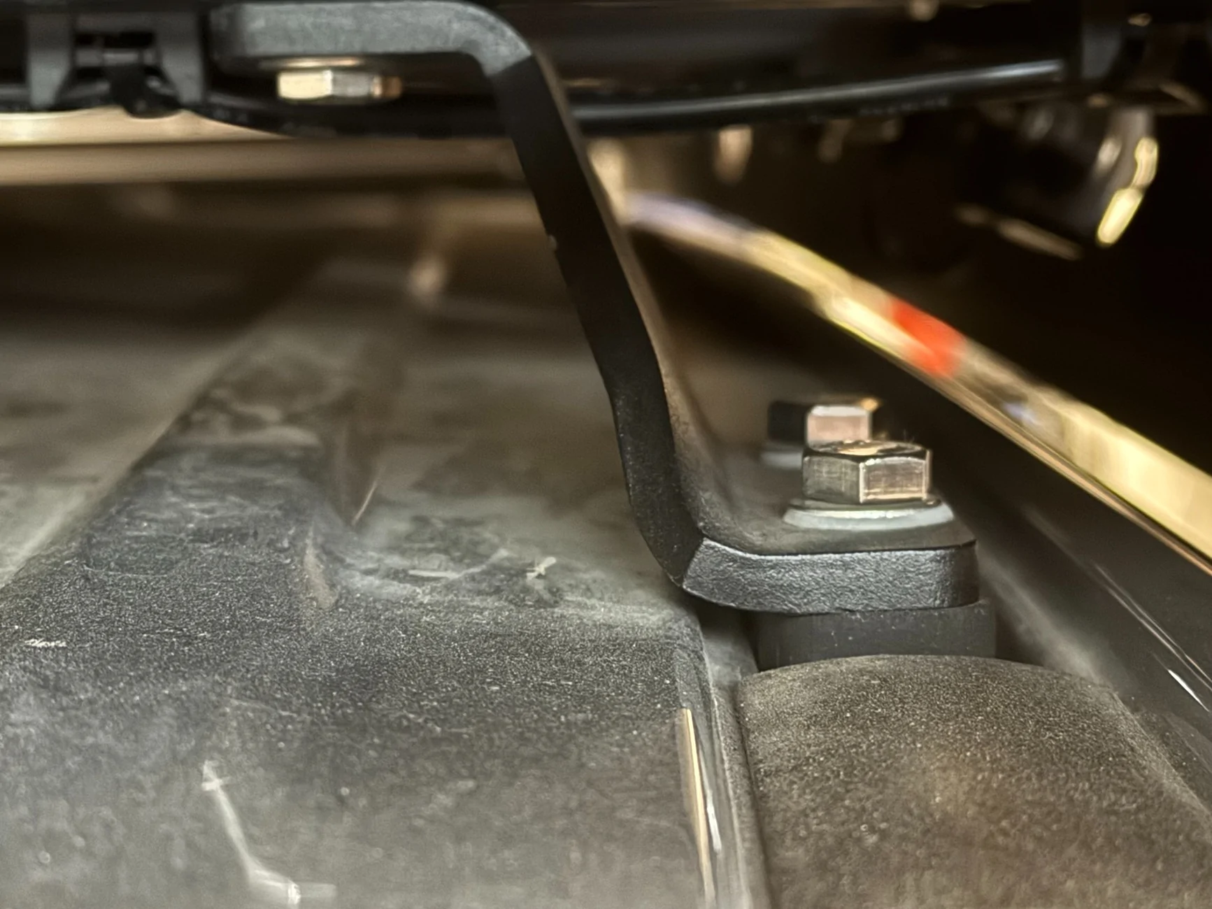

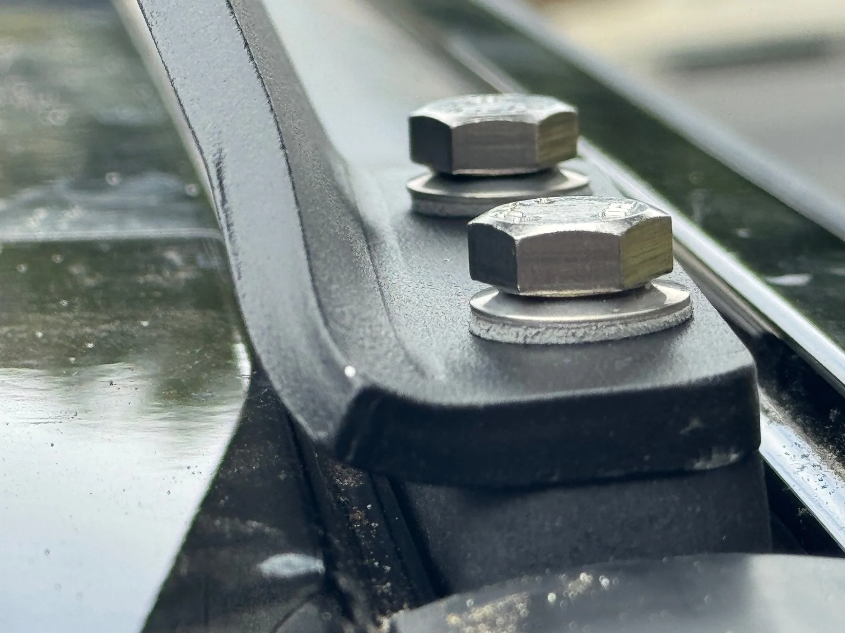

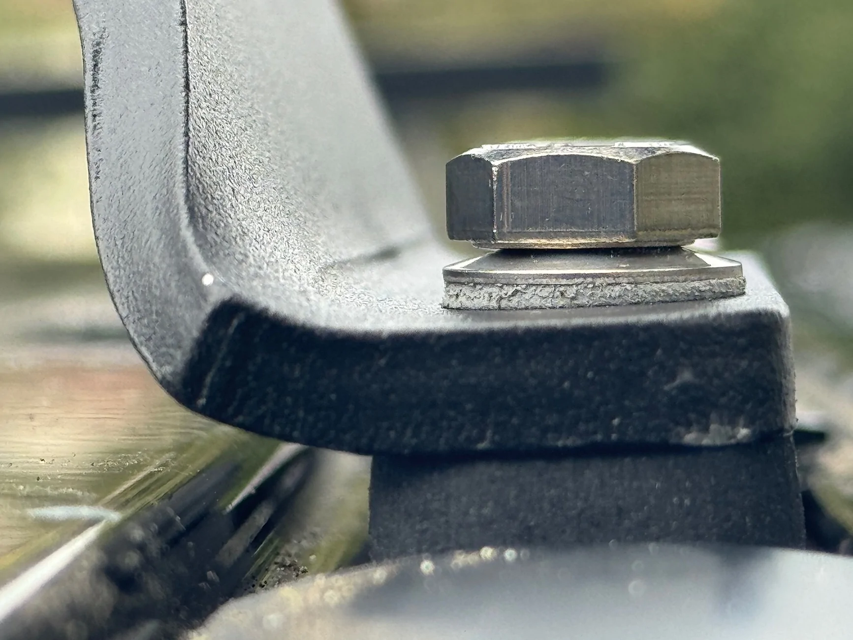

@vready thanks for sharing this, this is helpful!
i’ve attached a few photos from the back, both drivers side and passenger and i know angles can obscure things but it looks like our rubber block (and the metal rack support arms) is higher, and less compressed?, than yours are?
took a bunch of different angles trying to give a good perspective so you can give me your take. definitely want to make sure it’s secure and watertight. thank you again for your help, i really appreciate it!
passenger side back
2025 2026 4runner 6th gen Sherpa or Westcott Lo-Pro roof rack?? IMG_7272

driver side back
2025 2026 4runner 6th gen Sherpa or Westcott Lo-Pro roof rack?? IMG_7274
2025 2026 4runner 6th gen Sherpa or Westcott Lo-Pro roof rack?? IMG_7275
